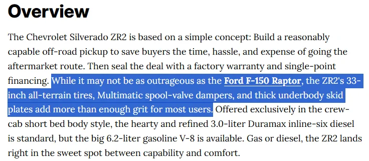

2026 Chevrolet Silverado ZR2 Review, Pricing, and Specs
From the video, the truck that did the best on that hill was in my opinion, the Silverado 1500 ZR2, followed by the old school 70's style Toyota with traditional stick axles front and rear (one thing that makes Jeeps adept as wheelin', solid axles articulate more than IRS). You would think it's running 35's like the F-150 Raptor? Nope, running 33's like the F-150 Tremor, which also runs 33's.
Ford Ranger Stock Ranger Raptor vs. Beer o'Clock Hill 1778760045143-ax
On the forums, you would think the Ranger Raptor or any other vehicle can't offroad without 35's. Here's what I think, for 90% of people, 35's are purely for vanity, not function. Again, not saying 35's don't have a place, they do, they add ground clearance, but that is about the ONLY advantage of 35's over 33's.
Going up in diameter 1 or 2 inches doesn't add any real traction, do a chalk test, you can get the same tread contact patches with either via air pressure and width just changes the contact patch to lateral insteader of in-line (reshapes it, doesn't increase it). Width adds flotation especially when aired down but you can get 33's in 12.5 in wide profiles too, so if you need flotation in 33's, they are available.
I think 35's are best suited to very application specific vehicles where you're willing to sacrifice on a wide variety of things such as acceleration, braking, turn-in response, higher CG's, higher probability of drivetrain / chassis breakage, when you need the clearance, you NEED the clearance. The US Army Humvee's run 37's, flat bottoms, for maximum clearance over obstacles on rough terrain / battlefield, but they are SLOOOWWW and with up-armored very prone to roll overs.
So, for crawling, very rough terrain like the actual Baja course, crawling etc. 35's, 37's and even 40's make sense, but they come a big cost and most of those trucks aren't towing. 33's offer that real-wold balance between clearance and all the other equally important performance metrics for off-roading and on-road use that are utilitarian, including durability under hard use, acceleration, braking, turn-in etc. They are just more balanced for the majority of use cases which is probably why it's the most popular OE tire size for production off-road capable vehicles.
If I ever did 34's or 35's, I would probably go the Race Truck route and really get into fender mods instead of lifts to preserve the CG, IFS and CV angles, but for me that would be a point where it's paid off and I have other vehicles for towing and utility, so it wouldn't be serving double duty anymore and become a performance vehicle only that is optimized just for off-road use. In that use case, it makes sense to do 35's to maximize clearance and off-road capability like the RR Race Truck, but until then, I'll stay with 285/70R17's to preserve the utility / durability side in a wide variety of uses, i.e., jack of all trades, master of none.

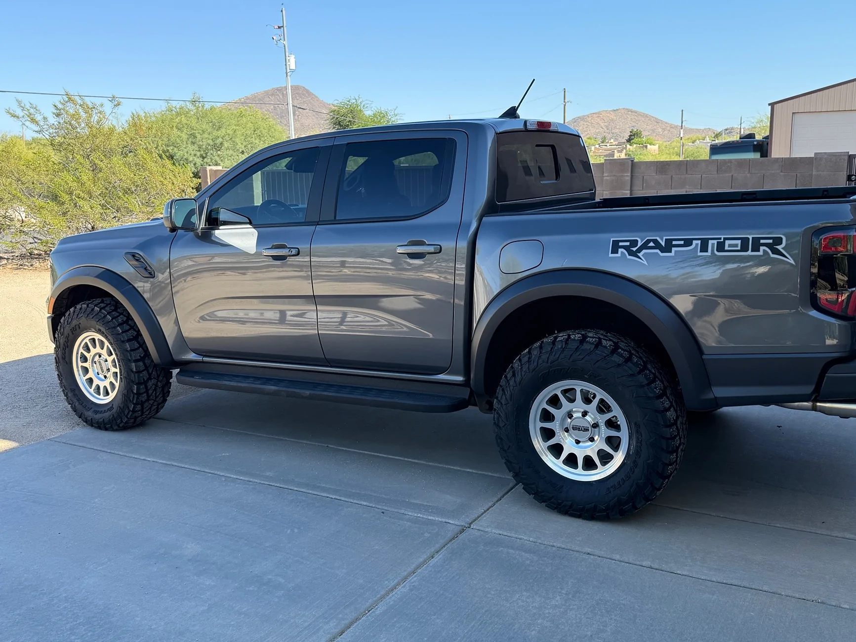

Another key part of this is where you live and what kind of terrain you off-road in most of the time. I live in the Southwest where we have a lot of rock trails, and clearance is the issue. I have had Jeeps on 37s and 38s for over a decade, my last one a 392 Wrangler, and I now own a '26 RR. I started the mods with a set of skid plates, I will be replacing the step with rock rails from Rocky Road Outfitters (arriving today) and will be installing the FordRangerLifts.com 2" front/1" rear lift next week. I know this may cause some reliability issues and additional wear, but the clearance is key for the majority of the trails we do. This is a photo with the additional clearance of the 35s, but prior to the lift being installed.
