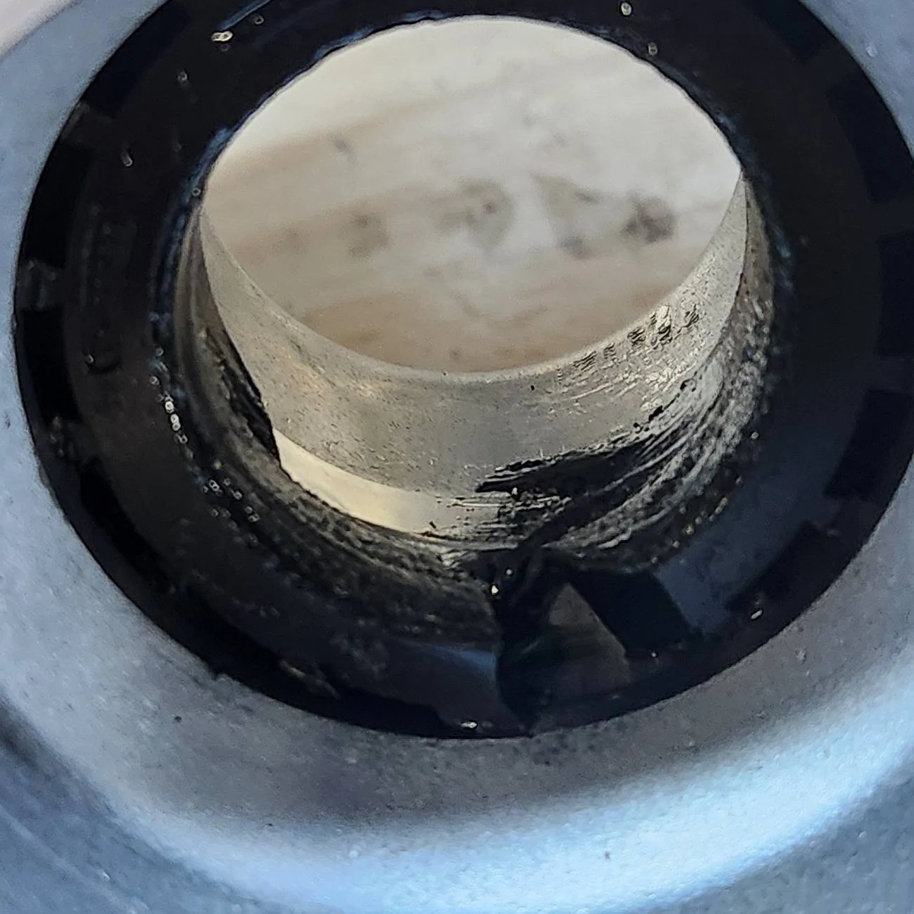

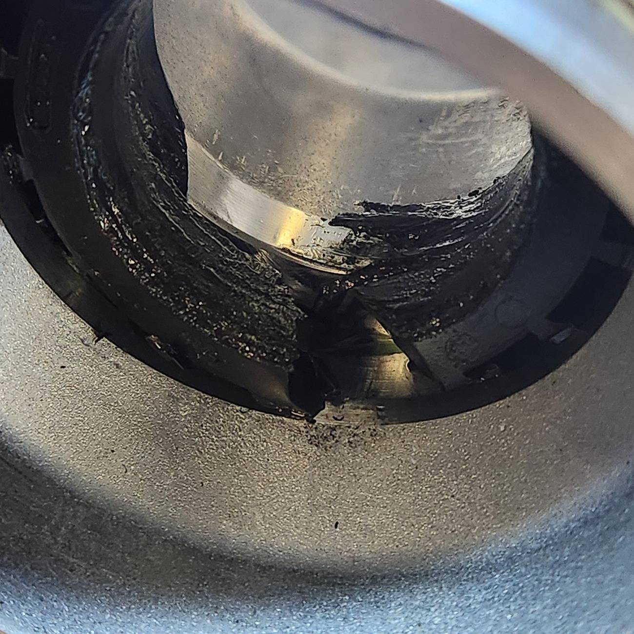

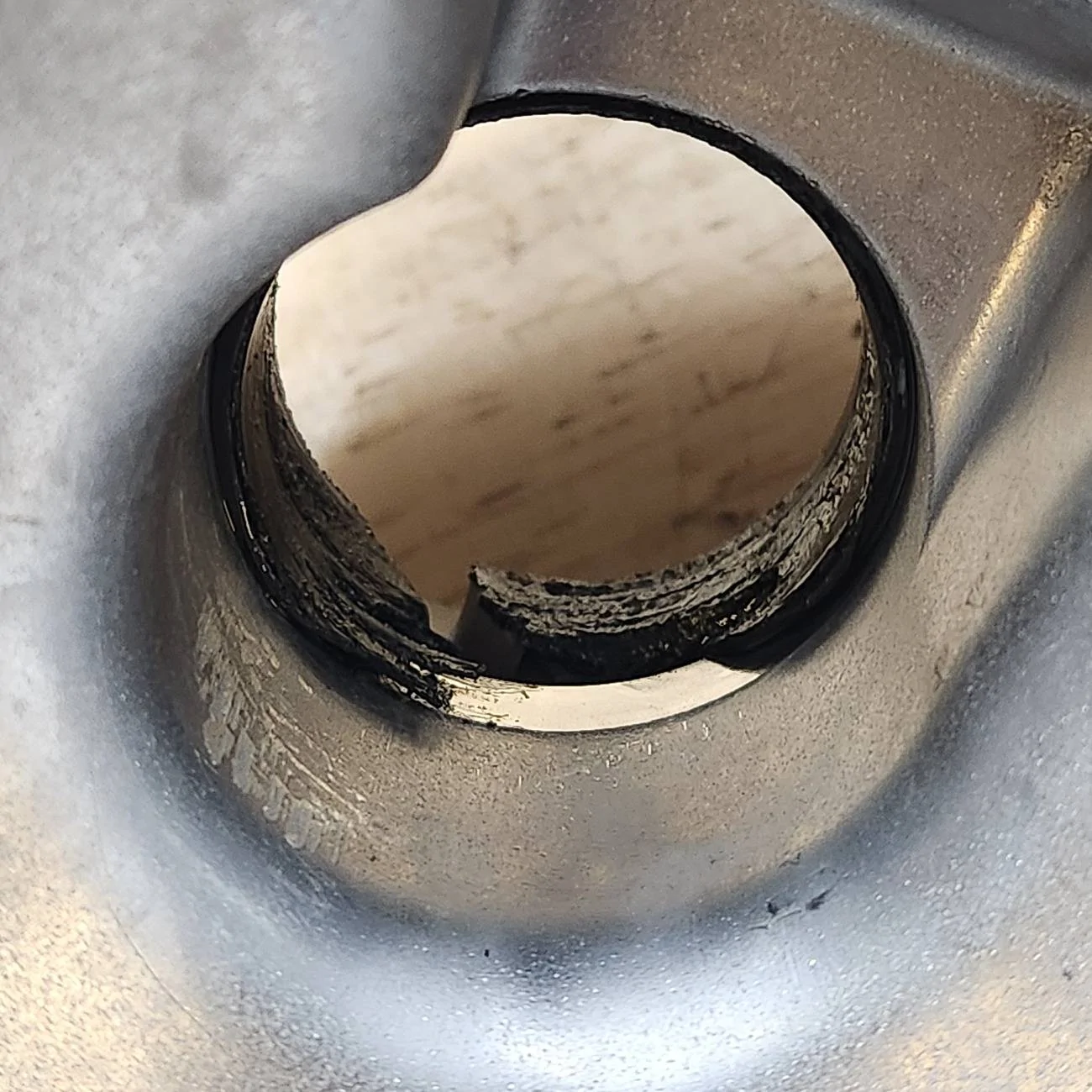

here's what most of Fords steering racks look like after bigger tires and a bit of offroading.
Evne tho I've never broken a tie rod, the bushings inside the racks are under-engineered and completely fail.
I recently upgraded rhe Bronco to the billet steering rack from 74Weld, and I'm glad I did, as you can see the wear from 50,000 miles is severe!
Will be doing a 74Weld steering rack on our Ranger raptor in the very near future!
The 74 weld rack is nice. But what about the Ford internals holding up over time. That is the bigger question? Will the beefy rack housing just shift the problem elsewhere, only time will tell.
the other components are adequate...the pinion is strong and the electrical motor is heavy duty as well. the steering knuckle itself is probably the next weak link after 74weld rack and HD tierods...
I got FMI fabricated knuckles from a F150 Raptor to install on the Bronco for this reason...74weld portals come with a HD knucke as well...
