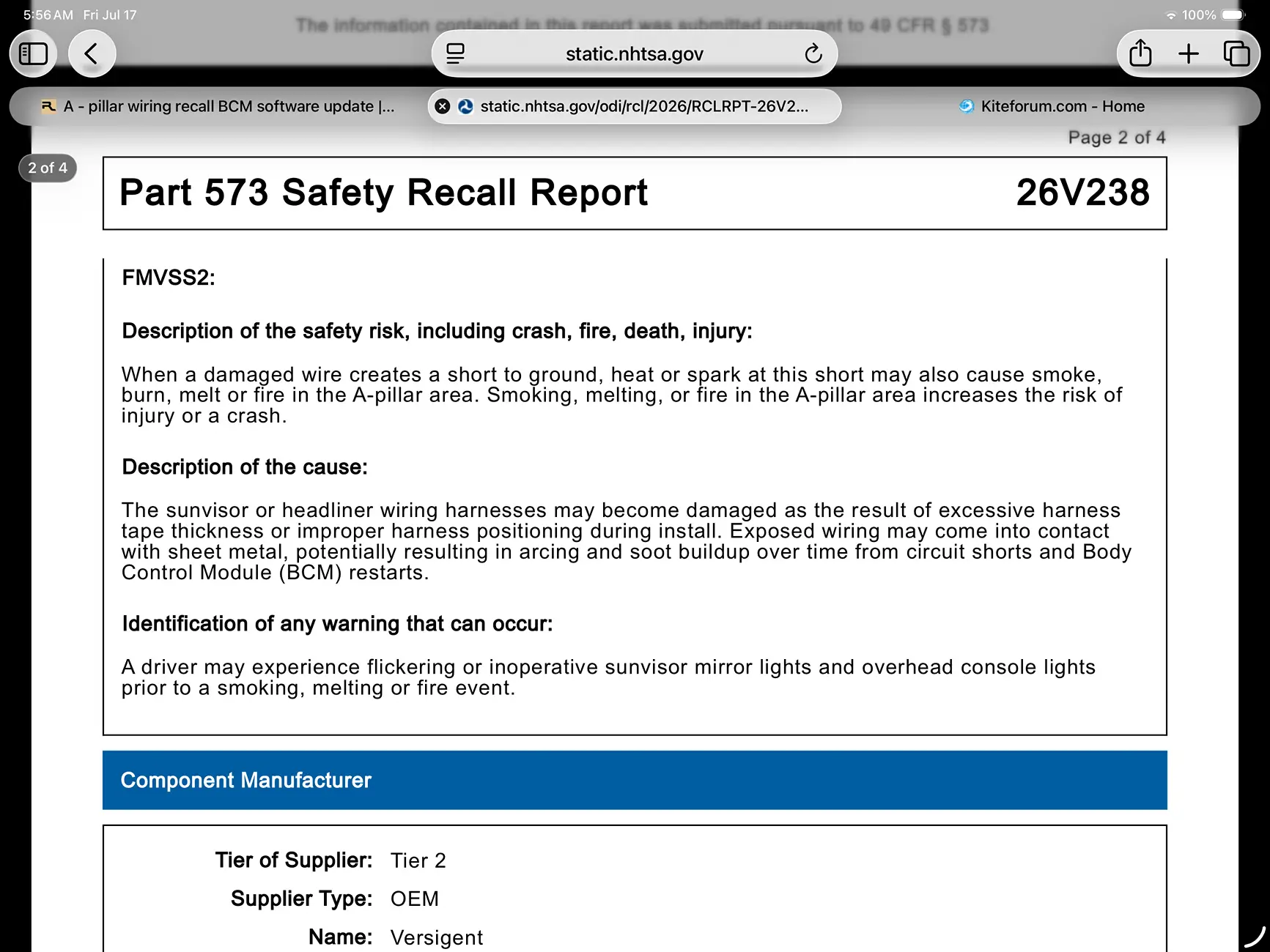

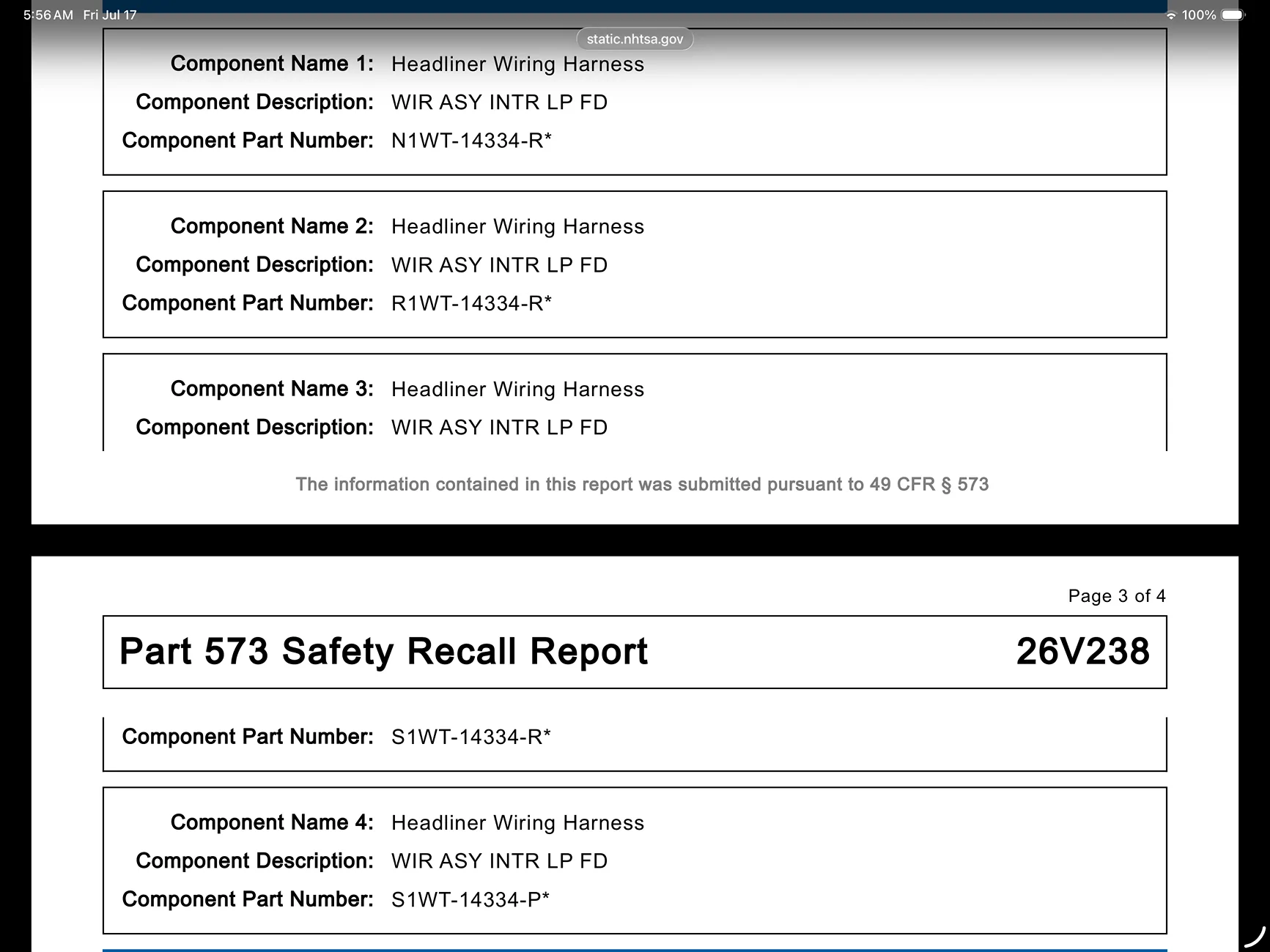

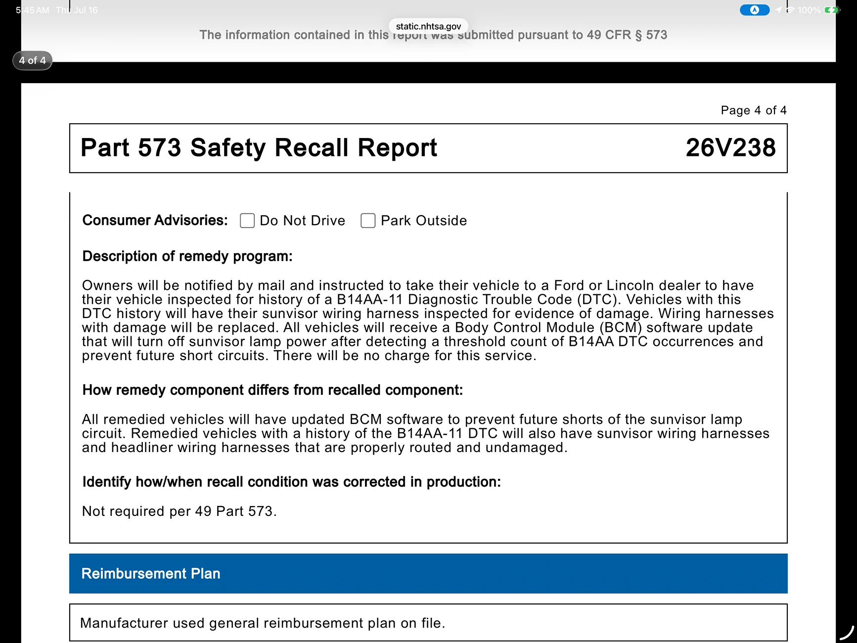

I think you meant it gets a new wiring harness if the code is present.
Sir, I am a Ford tech, and it gets a new BCM if code present.

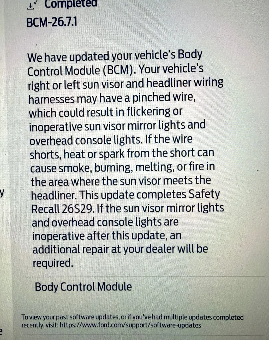

Just jumped in my truck now and screen said bcm update was done overnight and it was for this. It also stated that if the visor & other lights do not work to bring the truck in. My guess this update shuts it all down if it has a issue.

Upon pick up I had to get a manager who then got with the technician that did the work…the explanation of exactly what was done is this: used FDRS to check for B1 NOT present, update BCM to latest level.
The manager further explained that they DID NOT have to take anything apart to determine there were no pinched wires, no problems. That’s a big deal because others have had horror stories of damage/grease/fingerprints on their interiors after disassembly/reassembly. There you have it.
So, your truck sat for a while until a tech could to a 10-minute BCM update. If the BCM didn't report a problem, it's likely that they didn't do anything else other than a S/W update.

Everything I've read says it gets a S/W update that checks for shorts, disables the circuit, and sets a code to get the short repaired. So, I'm just wondering, how is replacing a BCM going to repair an electrical short in the A-pillar?
if the problem is a short in the wiring harness, I could see that the fix might be to replace the wiring harness AND the BCM.
but replacing the BCM by itself does not fix the short.
