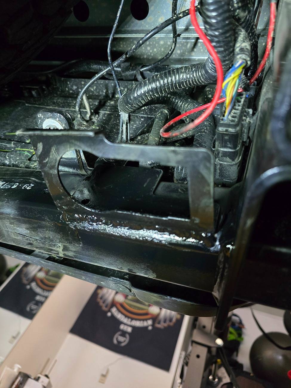

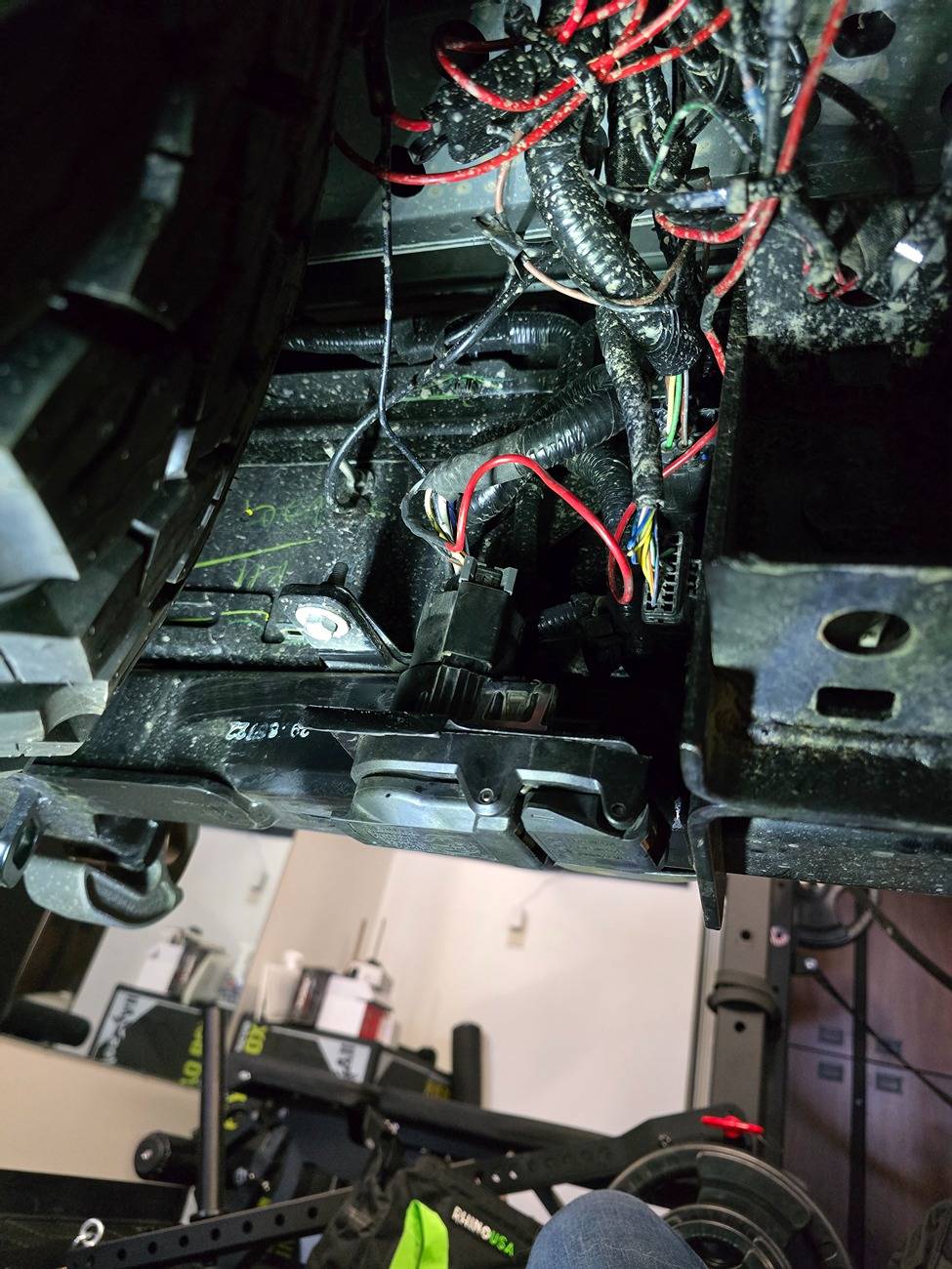

Thanks. I saw this a week after I posted the question above. It is a good solution and it certainly looks like the spare fits even with this relocation.
I have a couple of the new (somewhat overkill) Altiq Rock Light Pros in the spots on the sides of the license plate though as additional reverse lights (wired into the center pin of the trailer connector itself), so I'd rather not move one of them for a trailer connector I'd very rarely use.
However, I ended up cutting the bracket off and (for now) have ziptied it behind the bumper. It's going to be welded to the back of the bumper facing downwards instead eventually.

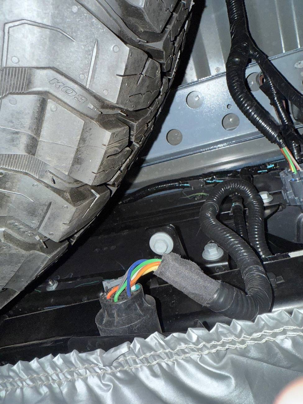

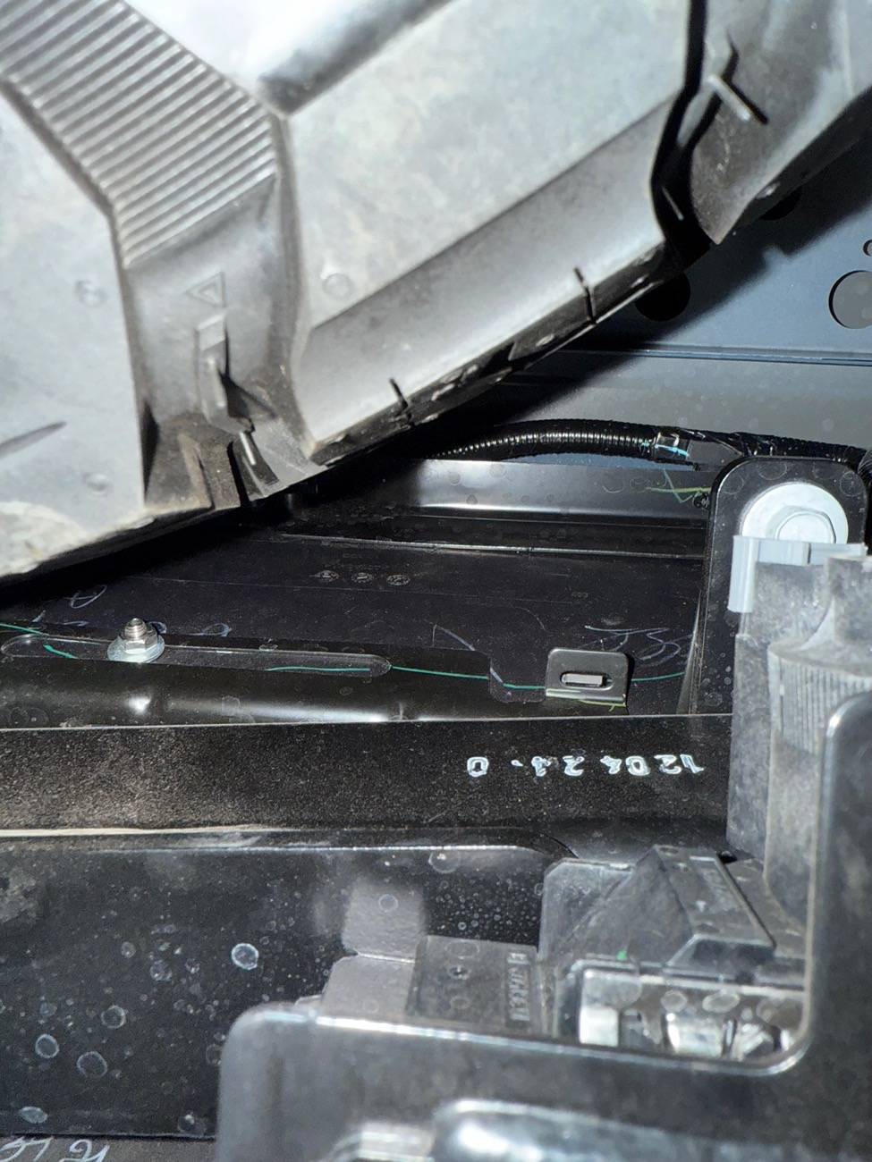

No there’s not in reality and the video excludes any photos from the underside;
Plug Mount is outboard of the bumper recess mounting position. This puts the plug and rear assembly; middle of the spare tread, mounted to the left.
With the wiring pigtail attached to the plug assembly, there’s barely enough room if any. I’m skeptical, until I see it installed with photos to verify its positioning. Right now, there aren’t any from the manufacturer or anyone else for that matter.
Lower photo, to the left of the three dots on the plastic and that’s not allot of room.
I’ll wait and see someone’s install before purchasing……..🇺🇸

Final result in the attached pictures. Definitely way more protected (I know, I could have maybe recessed it upwards a bit further) than the stock position where it'll hit things and bend.
