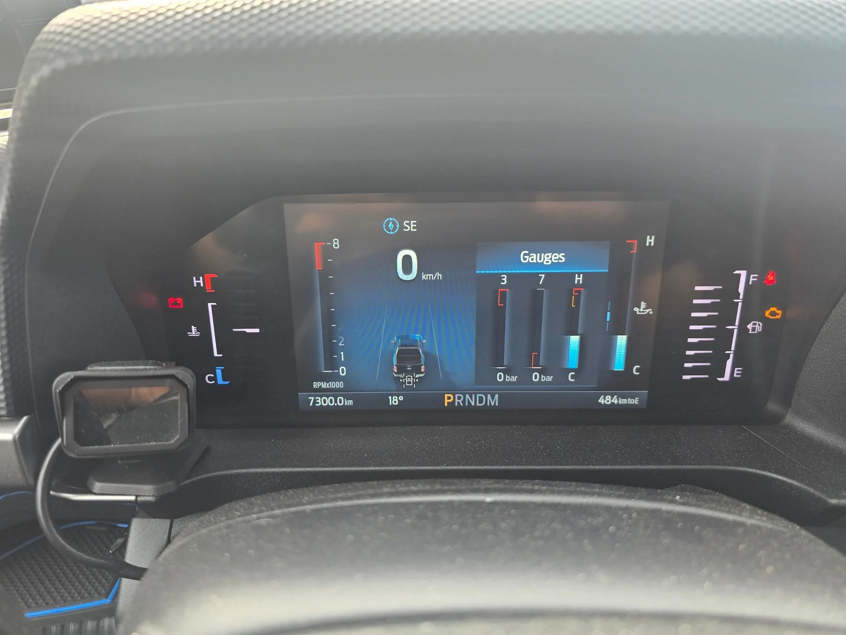

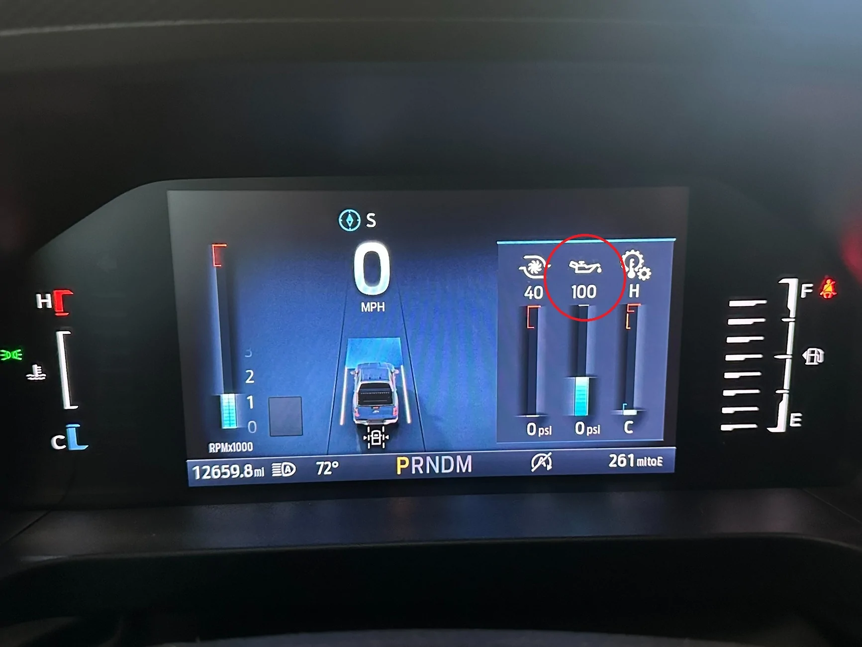

Brisco thanks. I worked in health care 35 years/little mechanical knowledge. Are you saying the circled in red is transmission temp? I'd thought that was oil temp. Now to the right, the little thermometer with gear icons....I'd be that is transmission temp....but no number. I want a number, not a range.

That's oil pressure. Trans temp is the one to the right of oil pressure, turbo boost is to the left.
The numbers shown are maximum, not current values.
So, boost is 0 - 40 PSI, oil pressure 0 - 100 PSI.
And just like coolant temp, no actual value shown, so it's a wild guess.

Jason is correct on the three.
Number swould be nice, but I don't believe necessary. Drive the truck without towing observing what is normal for your truck. Establish a baseline normal. Then watch when towing.
Notice that the transmission temp guage has a yellow area then finally red at the top. The yellow is a caution area, the red is a pull over and park it temp. I'd say anything below the yellow is fine. If it did have numbers, they wouldnt mean much to me, not knowing what number is good or bad.

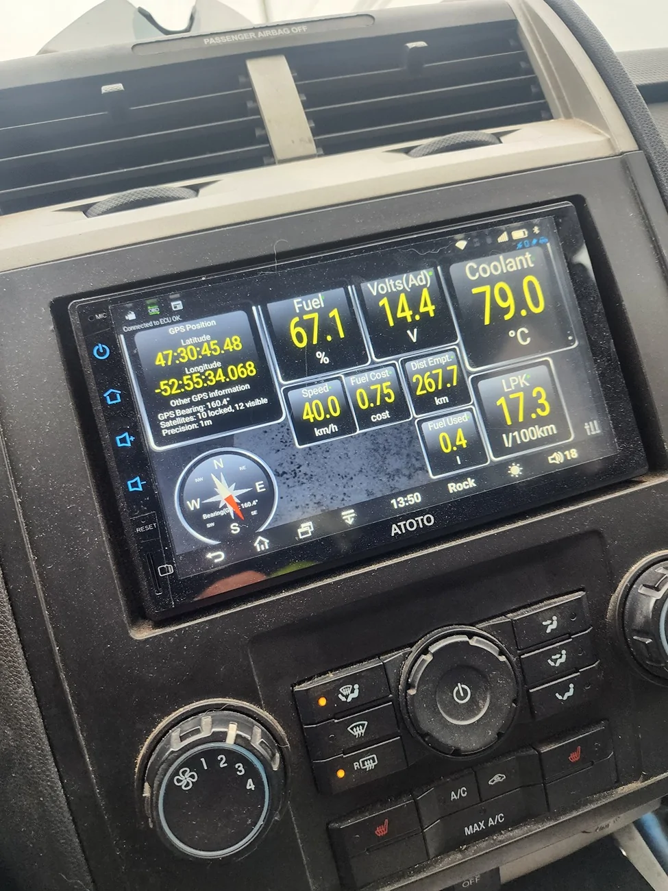

Jason, what am I seeing here. Oil temp on the right, rpm's on the left, and you're heading northwest but not very quickly ;) Need more info, but it's better than nothing I suppose.

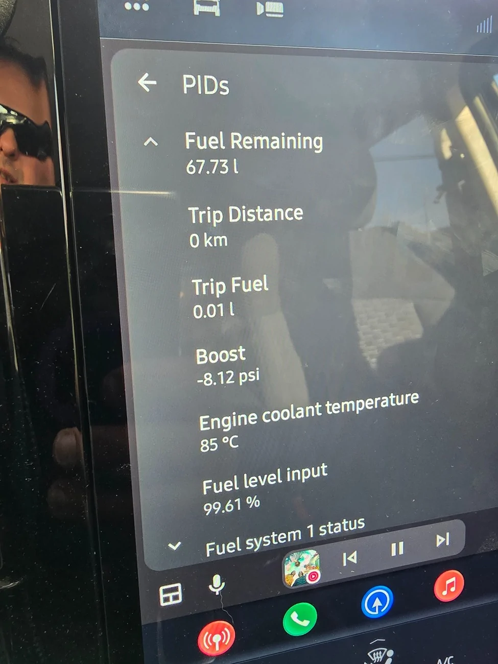

Scantools brand they sepperated from scantool
OBD Link. Im using the MX+ comes with free lifetime enhanced diagnostics updates. vs the mx or others you have to purchase them. and the obd link app is android auto compatible. so the extended display will show over there. and you get to pick what pids you want shown from the available list. while driving only the top 4 will show. then in park or neutral, the full list you picked will show.
but on the dash you get Coolant, rpm,turbo boost, engine oil pressure, and transmission temp, then oil temp, and fuel level. on the obd app I then picked the fuel remaining, which for me shows in liters remaining(canada)
snapchat video when I first set it up back in april.
and use to run torque pro in my old 2012 escape with an Atoto android headunit.
I have forscan on my phone and laptop for the stuff torque and the obd link software cant do/forscan on laptop for the full features. lol
forscan can change all the letters to #'s but you cant pick what ones.. your fuel gauge then goes 0-1, instead of E-F for example.

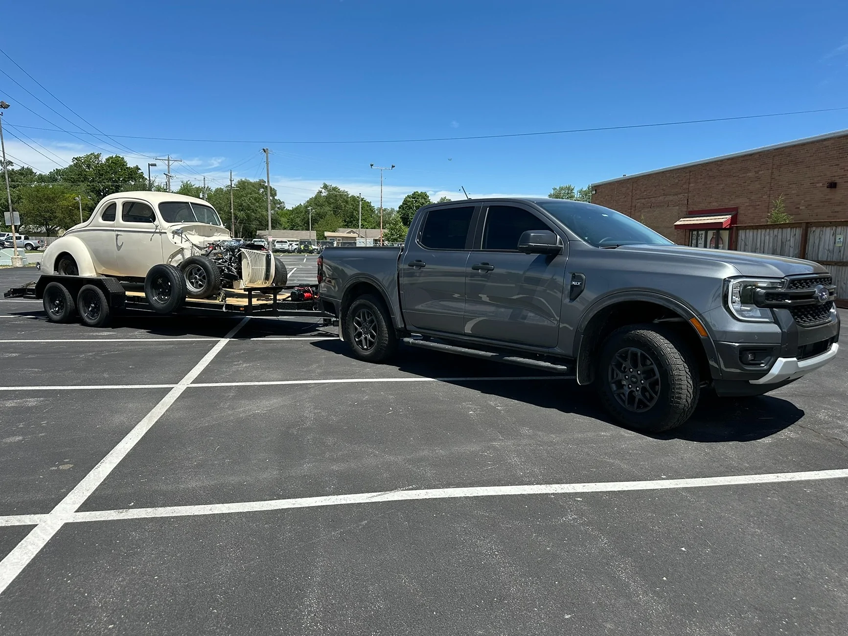

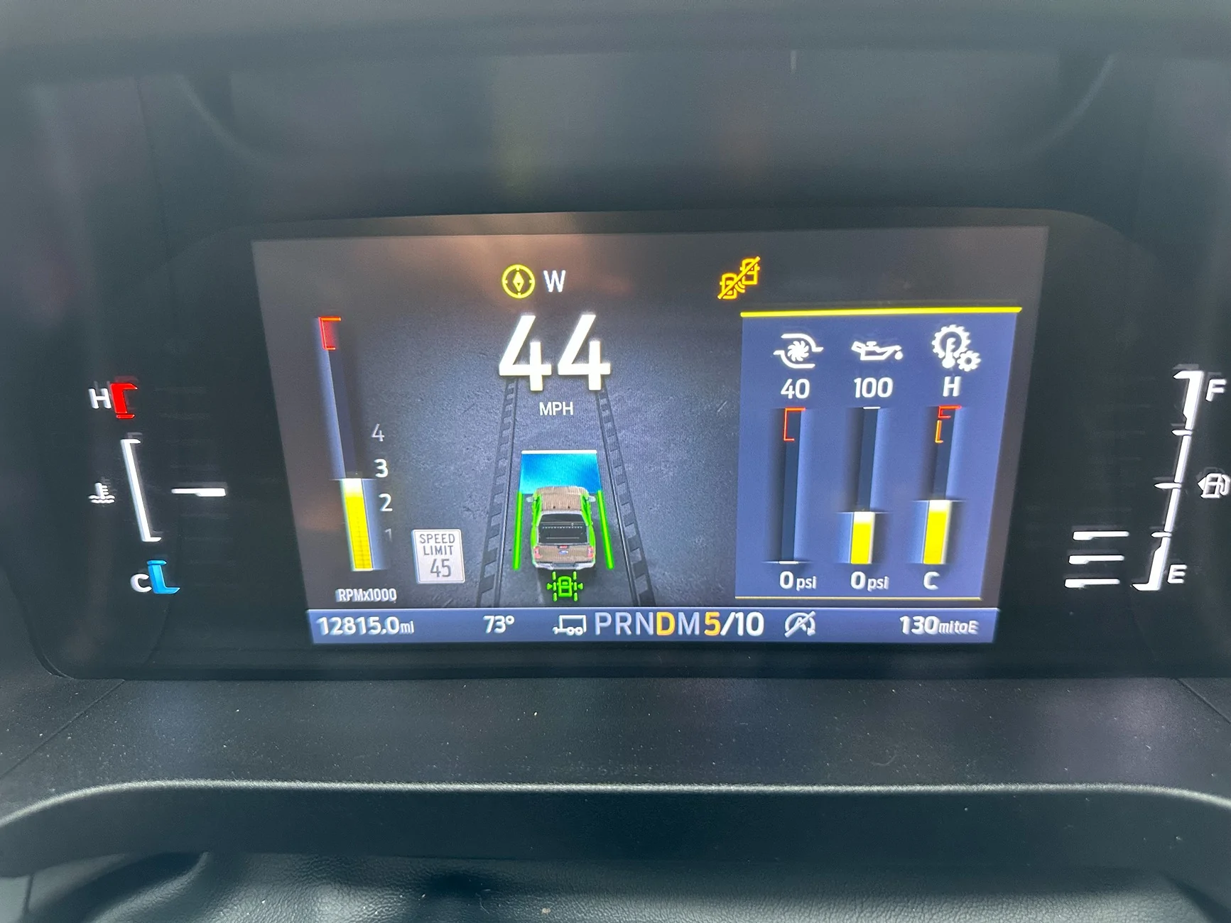

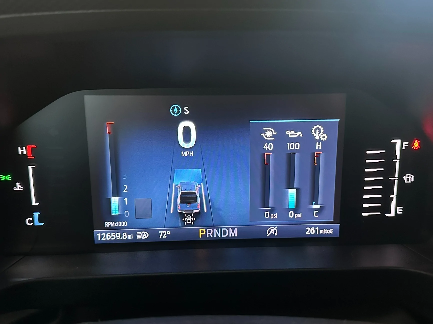

I've towed a bit with this trailer, total weight about 3500lb in temps up to 104F and this is as high as my trans temp guage ever gets. This is the normal level even when not towing. Today I was towing at 73F. It has never gone higher than this.

I'm assuming you have 4x4, 4x2 may not have these.
To get to the guages I go to right side of the steering wheel buttons, hit the menu button, scroll down to Off-Road, hit Ok, scroll down to vehicle guages, hit OK.
