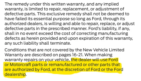

Just curious if under the warranty agreement it says they can replace a unit with a rebuilt with that mileage on you vehicle or any miles under there agreement.
It does say 'remanufactured' part may be used, but it's worth fighting them on such a new vehicle.

Just curious if under the warranty agreement it says they can replace a unit with a rebuilt with that mileage on you vehicle.
That's a great question. But
Thanks for this. I will still move forward with pushing Ford because of the low mileage. Probably won't get anywhere with it but we shall see. Might just end up dumping it (and losing money). Maybe this rebuild is a low mileage unit or maybe it had 100K before rebuild. Who knows.
