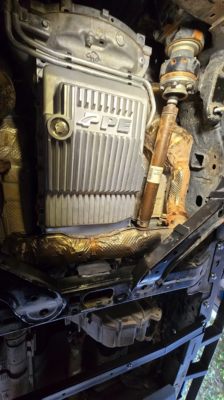

I have don't it. Also added a deep pan while doing it.
Its not that hard. Hardest part is checking fluid temps when its hot and not burning your hand or arm.

10R60 / 10R80 same procedure - watch any YouTube Video () . I also upgraded to a deep transmission pan and used Amsoil ULV ATF. I followed the cold procedure 38:30 mark on this video for a 10R80 (). I actually noted where the original factory fill measured cold on the dipstick. Which was were it was on the dipstick in the video so when I refilled I filled to the same level - started it ran it through the gears (didn't let it get hot) and rechecked the level, needed to add a little. I confirmed with Amsoil that ULV has the same expansion rate as Ford Mercon ULV.
