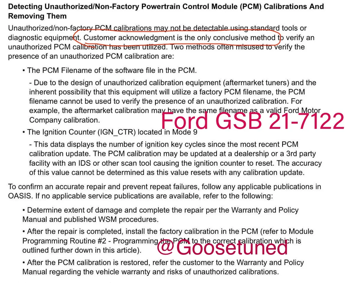

Pretty sure Ford diagnostics will still flag it due to things like flash count discrepancies, calibration verification numbers, data in module handshake logs and maxed out boost pressure and fueling logs.
No, they don't.
The program you're thinking of (FDRS?) doesn't do that. It'll count key cycles but flashing a Procal does the same thing to the cycles so it's really a wash.
