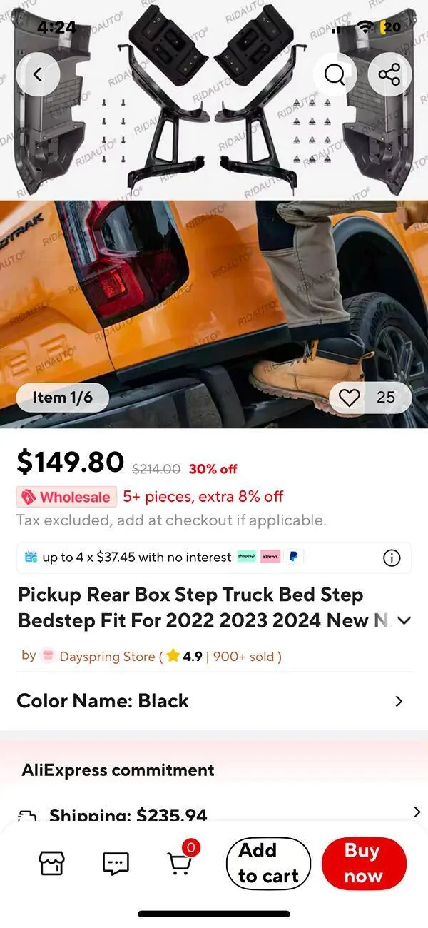

what are the different ones you ordered 'with the clips'? I don't see a different one.
This is one thing I wished I had known about before buying. Silly the steps aren't standard.
Sorry, not sure how to copy a link to AliExpress. There were 2 sets when I searched. The black vehicle are the ones that are linked. The ones I bought are on a yellow(ish) truck. Difference was primarily the included clips and the shipping. The ones I bought were about $50 more shipping but 2 weeks instead of almost 2 months.

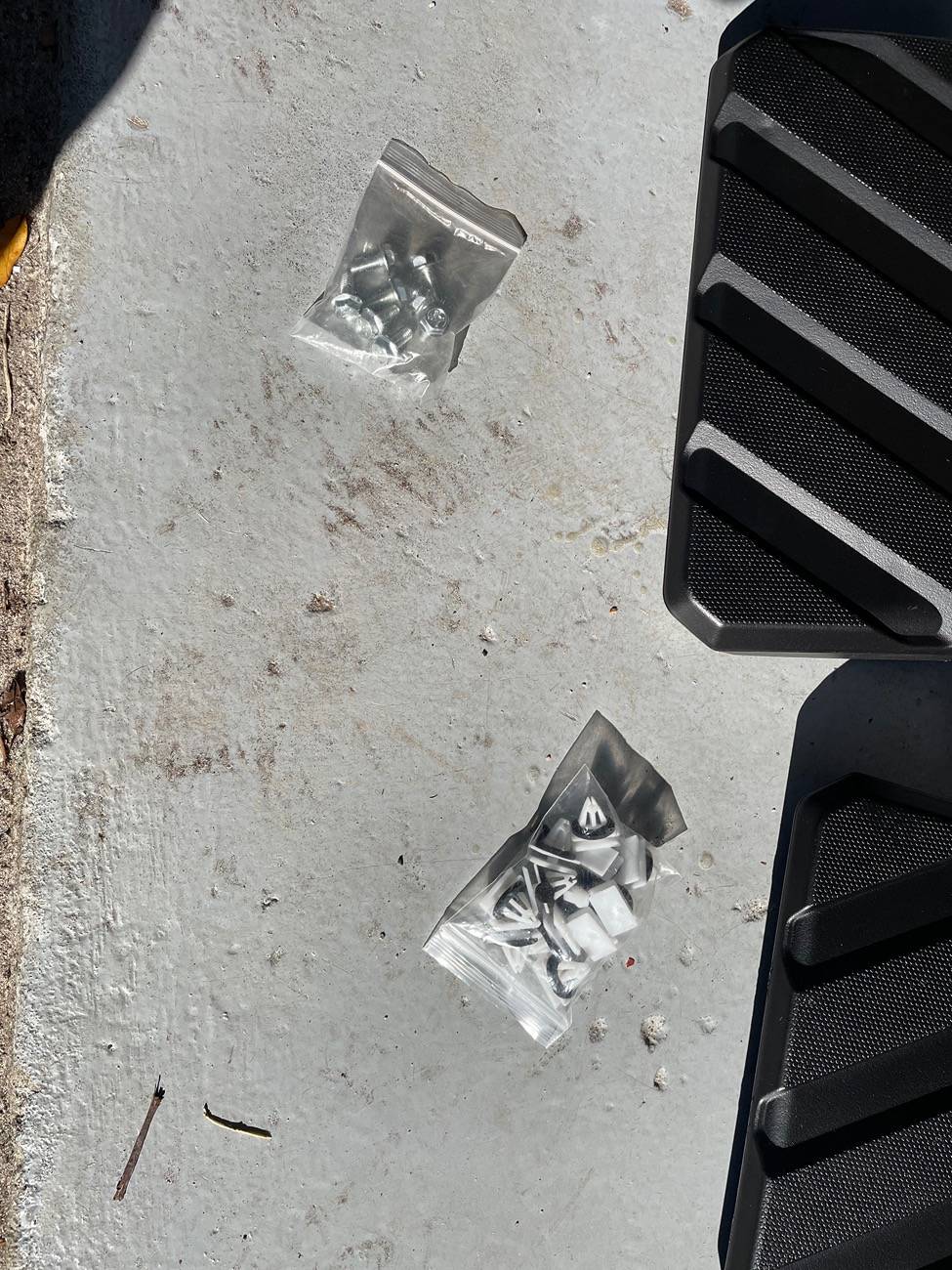

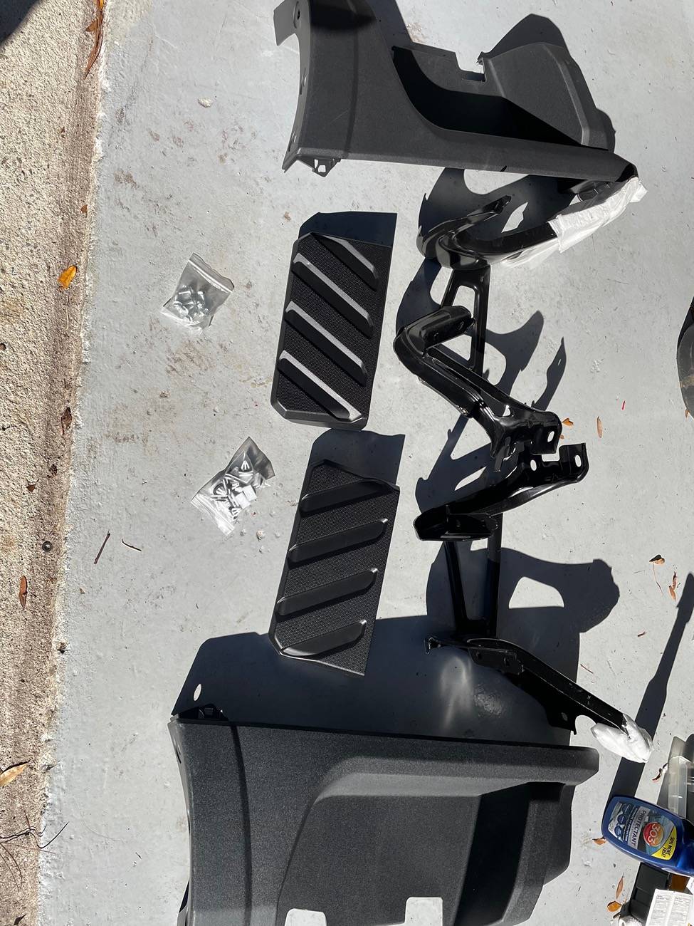

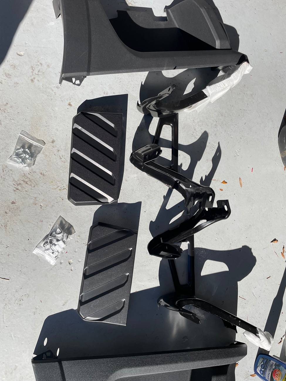

I went ahead and ordered the pair on Alibaba back on Jun 22nd for $333 after tariffs and shipping (the parts were only $125 of that...) Unfortunately after waiting a month for them they arrived today with a deep gouge in one of the trim pieces, and in a spot that would be visible after install. I've contacted the seller and they say they're "doing research" and will get back to me. Fingers crossed they're able to correct it. (Admittedly it looks like Alibaba has trade assurances that state if it isn't delivered undamaged I get a refund, but still a fun spot to be in).
Also strangely for this shipping from CN the agent I'm conversing with is sending their texts in Hindi... not sure what that's about. Is making communication fun.
