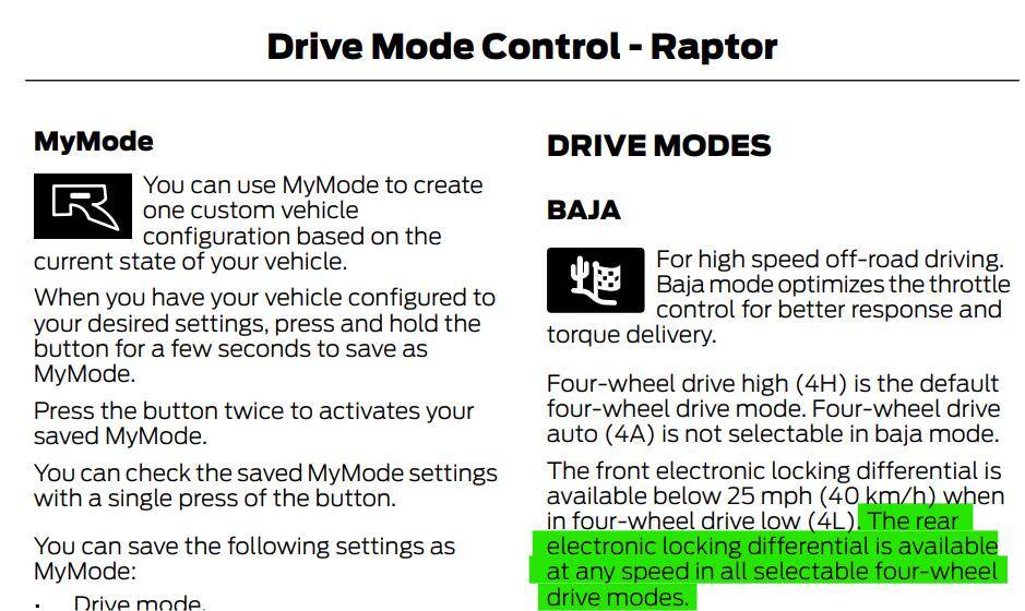

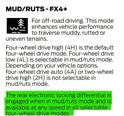

You need to keep reading. When used in certain drive modes there is no speed limit. Like I said very different from the Maverick. The Maverick is a AWD vehicle. Its FWD with a PTU to send power to the rear. The Ranger is a true 4wd with a transfer case and solid geared rear axle.

Not a 4 wheel locker at all. It's a clutch pack in . Dual in the case of the Tremor. The Ranger has a geared differential with a 3rd member. When the locker is engaged differential is actually locked. No slip at all. The Maverick can slip. Real 4WD vs AWD. And yes the Maverick is fun. The Raptor is AWESOME. I had a Maverick and now Have a Raptor.

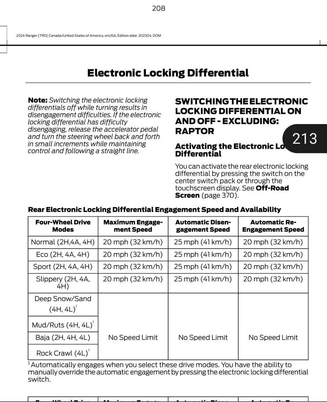

That's not true at all with the Ranger.

Generally, don't use lockers on dry pavement or any surfaces that have grip. If you are going to use it on a dry or hard flat surface, avoid turning.
