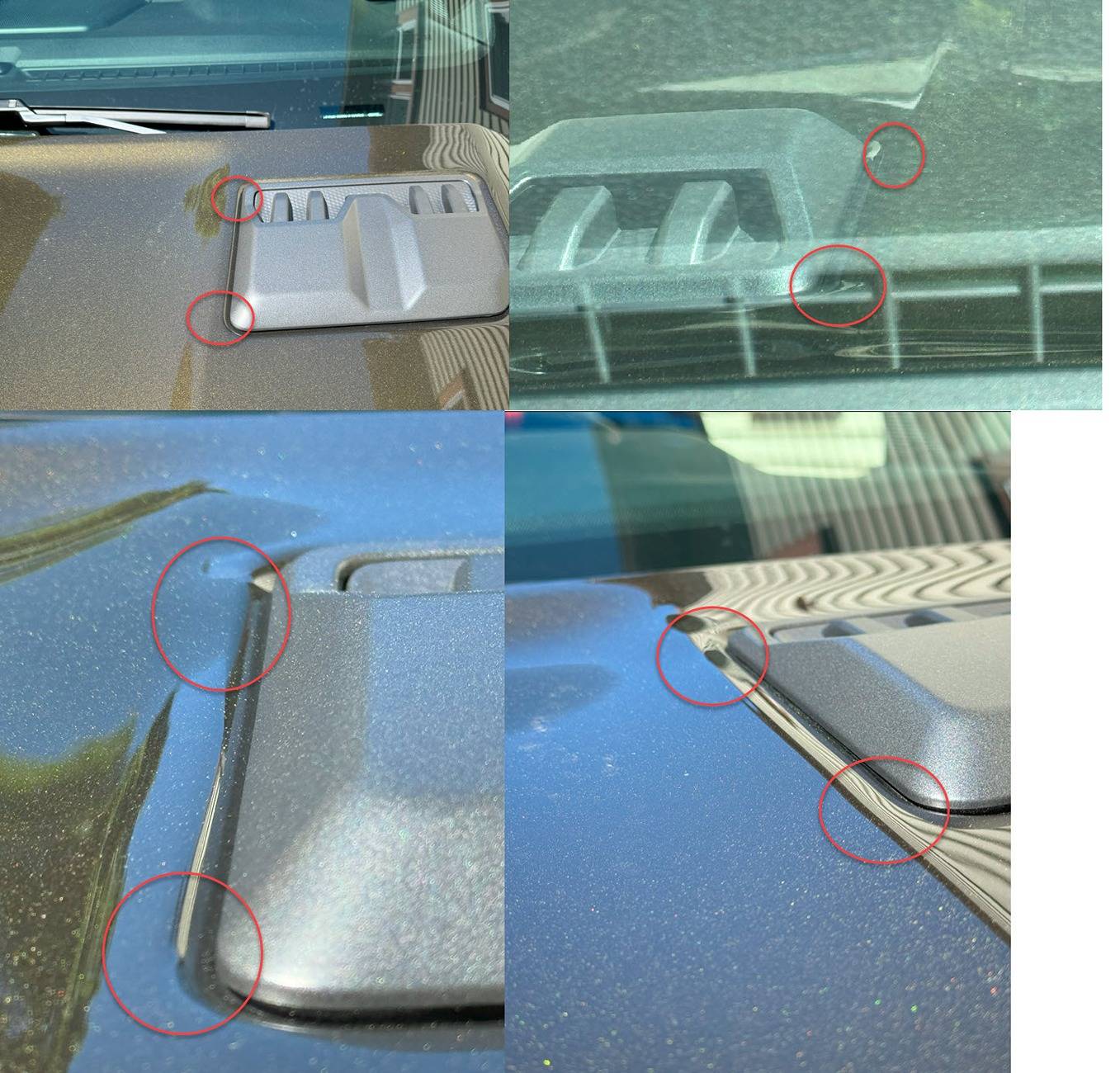

Does anyone know of an example of what type of deformity they were seeing on the hoods?
The only thing I have a gripe with on my RR is there appears to be two indentations next to the driver's side heat extractor on the hood. I didn't notice in when picking the truck up as it didn't really become visible until night driving. It is next to impossible to capture in pictures but now that I see it in front of me every day it kind of bugs me.
My build date appears to have been 3/1/24.
Same dents on my RR. Mid Feb build that was released at the end of March.
They bug me…..
Mine has that too.

Mine has the same dents in the same places. Built mid march.

Add mine to the list. Same two shallow dings on the hood. Got in touch with my PDR guy to see if anything can be done. Build date 5/28. As said earlier, once you see it from the drivers position, you can't unsee it. I also think my steering wheel isn't top dead center either but it's just ever so slightly off and doesn't annoy me as bad as the hood dings. The steering wheel installer at the Michigan Assembly Plant must have a crooked eye ball...

I have an appointment with my dealership/body shop on the 11th to look at the hood dimples. Thanks to everyone that commented that they also had similar/same dents. Hopefully they can get more info about the QC holds that went into place for the hood issues and can link these issues to that.

The dimples exist on both side of the hood at the crease where the heat extractors are. One on each corner on the inner edge. Seems like the process of inserting the extractors is placing too much pressure on the hood causing it to dimple.
I showed it to my local dealer's body shop when I had the hood and front fascia panel over the front bumper realigned. Told them I want to wait and see what develops on this issue as repainting the panel after potential repairs is not something I wanted to jump right into. I also have the small paint chip on the drivers side above the tail light near the tailgate.

I have the two small barely visible flat spots on the drivers side inner side of the heat extractor raised body line on the hood. Deciding whether its worth it to pursue. You really can't see the imperfections unless you're sitting in the drivers seat. I have yet to see what my PDR guy can do with it. The whole front clip had PPF installed, so there's that to contend with too. Been too busy.
Like you, I love the pickup but just disappointed with this particular QC effort.

I had the body shop manager take a look at mine when I had it in to get the keypad programmed yesterday. He noticed that I actually did have dimples on the passenger side too and that the extractor on the driver side looked like it had gaps on the front. All in all, worse than I thought.
He said he has not heard about anything on the hoods but that it looked like it was a stamping issue. If he were to try and fix it he would have to sand down all the crease spots, build it back up, and repaint. He said a new hood would probably be better but he also knows there are no parts to get right now. He didn't have much more to report other than he's not confident @Ford Motor Company will do much about it. He did say that ff they ever did enact a recall, Ford would pay for PPF to be redone if it was applied.

Ran out of time when I was speaking to him so not really sure of next steps. If no one gets repairs done, I can't see how it would get on Ford's radar. My biggest concern is if it is related to the structural issues that caused so much QA hold and that the issue is actually getting worse over time. I looked at some earlier pictures and it looks like the front gap is there, but maybe not as bad as it is now.
