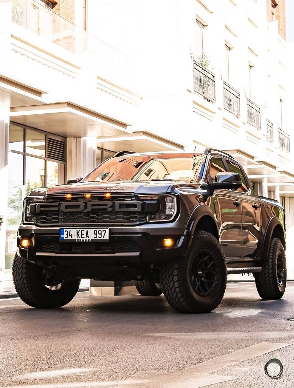

I wouldn’t expect the pedal to feel any different, even if stopping is a little slower because of the added weight. But the really important question is, can you post some pictures of your truck for us to drool over?
egecikrikci
Ege
Jun 29, 2025
Turkey
Ford Ranger Wildtrak 25'
gonna create a build post once I get back but this is what im drooling over ?
