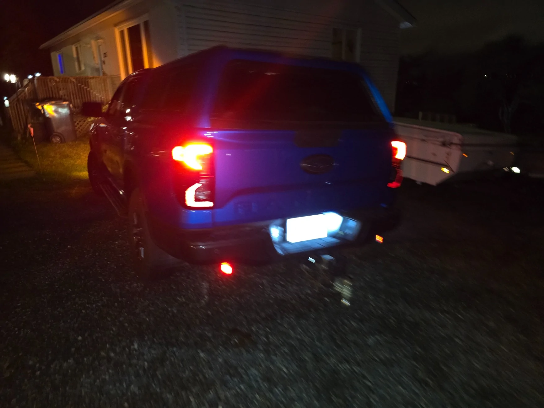

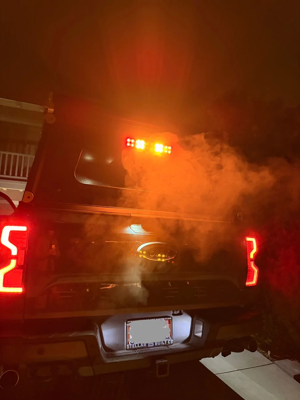

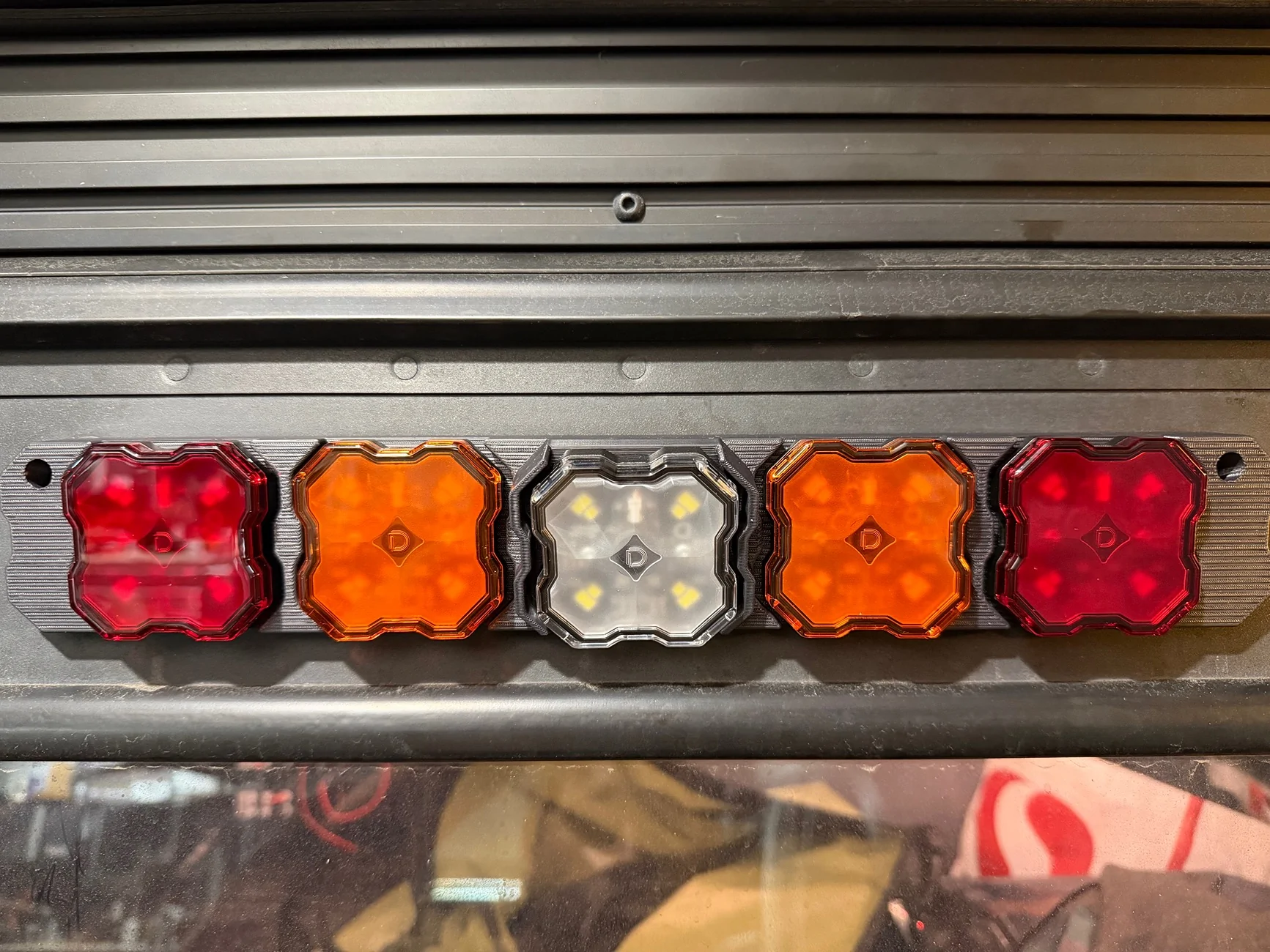

Yea i made this for my camper. White runs off reverse trigger from tail light, 6v triggers the low power light of the red lights for running, brake light powers the high power mode of the red lights, and then an aux switch powers the ambers.

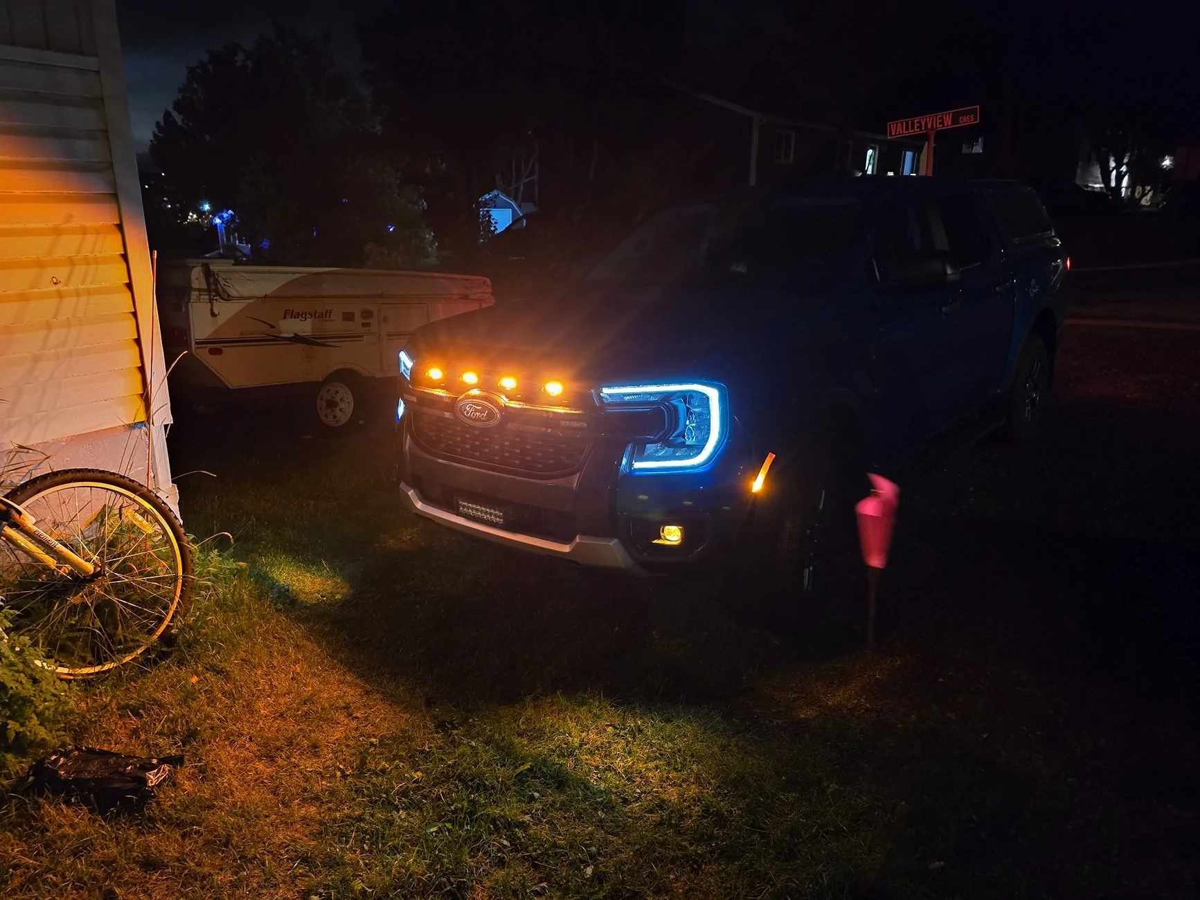

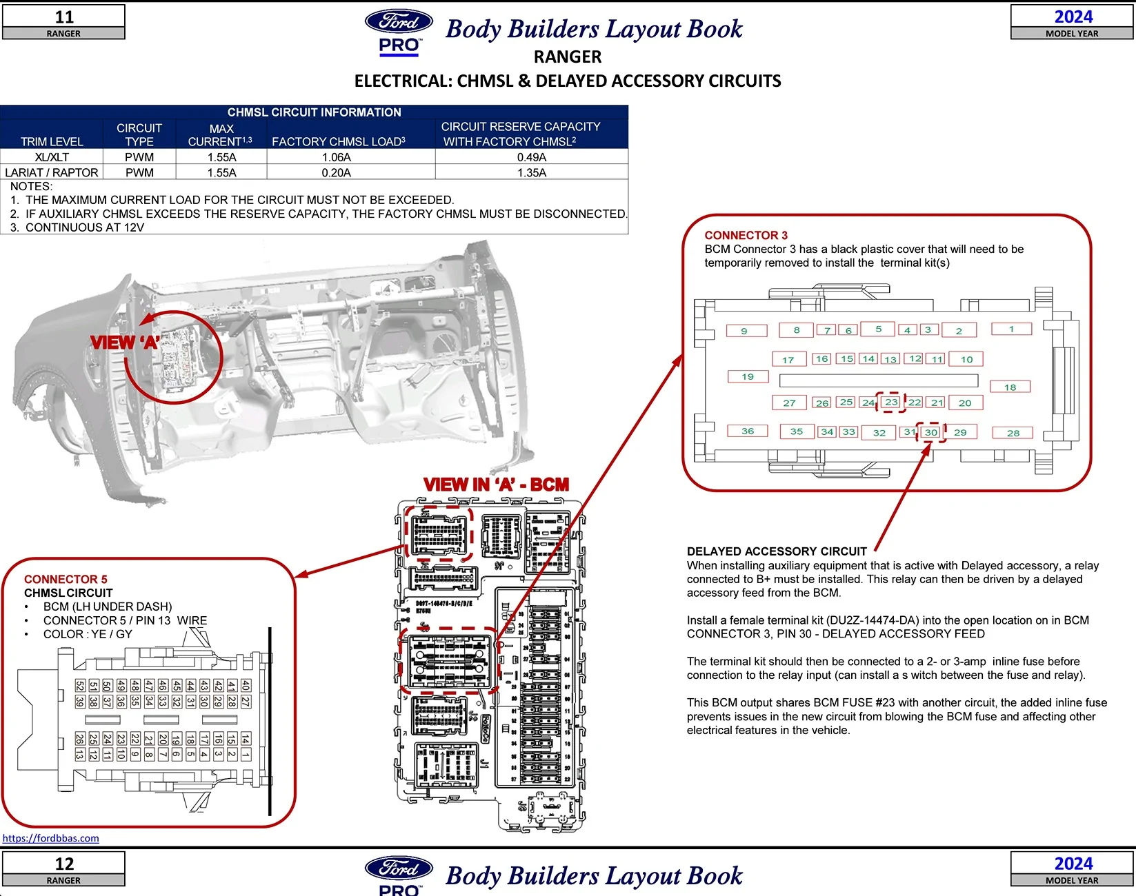

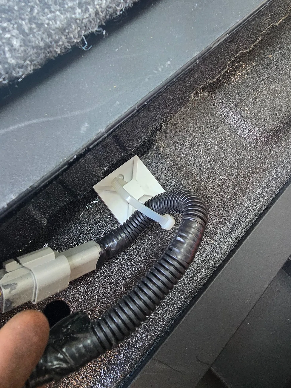

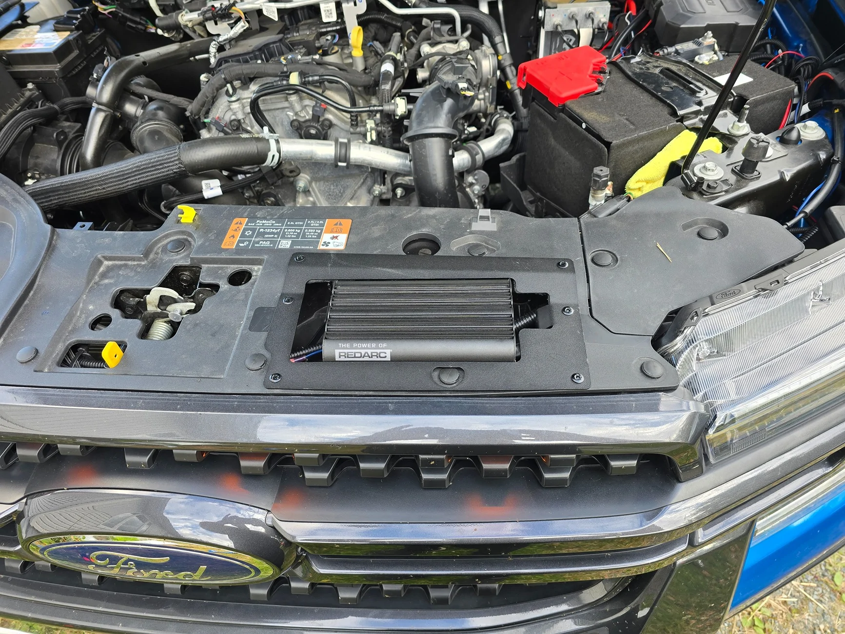

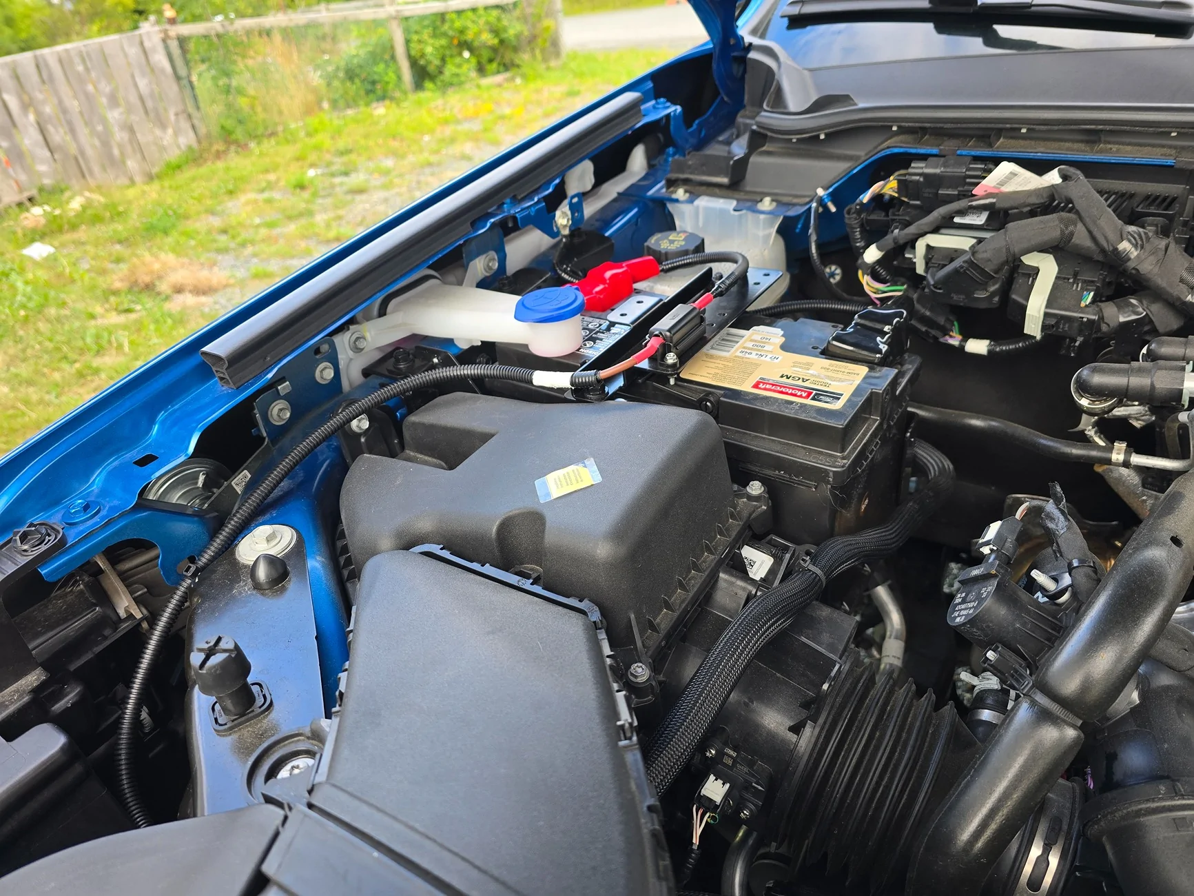

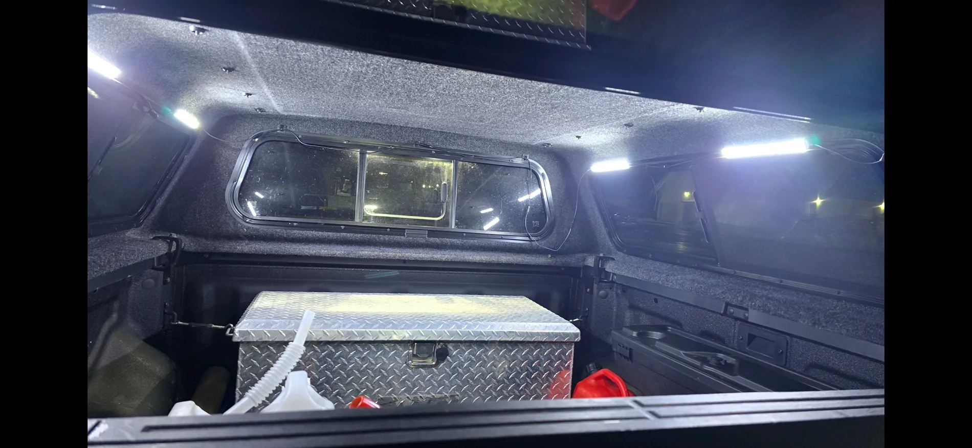

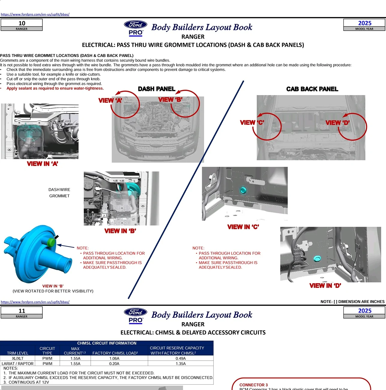

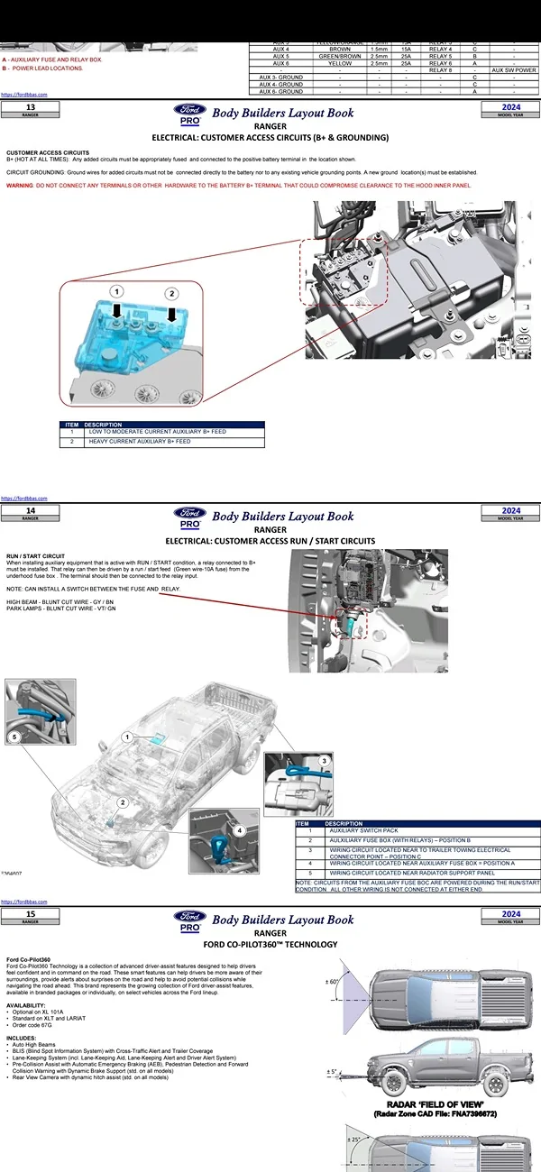

As per the Ford Body Builder Layout(aka upfitter guide) you tap the 3rd brake light at the bcm. I put an led in my 3rd brake, then I ran a 3/1 core with 3 14g wires in it under the truck following the factory harness, and in the same plastic channel they have(that was a bitch to do) for the ground for my cap. the bcm brake is then tapped, ran out through the firewall, hooked into the wire I just ran for the brake for the C1R's(gets rid of the trailer disconnected error as I took the brake/turn singal wires off the Diode Dynamics harness, except for the ground, marker, and reverse wires) and brake for the cap , and then fused power off the low draw side of battery to the 3rd wire, ran back for dome lights in the cap.
also under the bcm per the upfitter guide there are 3 blunt cut wires, a marker light trigger, a high beam trigger, and a ignition trigger. I have these hooked into my diode dynamics dswitch to automatically turn on and off(can still use while truck off) will automatically turn my dswitch night mode on, and my grill lights) and the highbeam will turn on when ever I got programmed into my dswitch. right now it turns on my lightbar

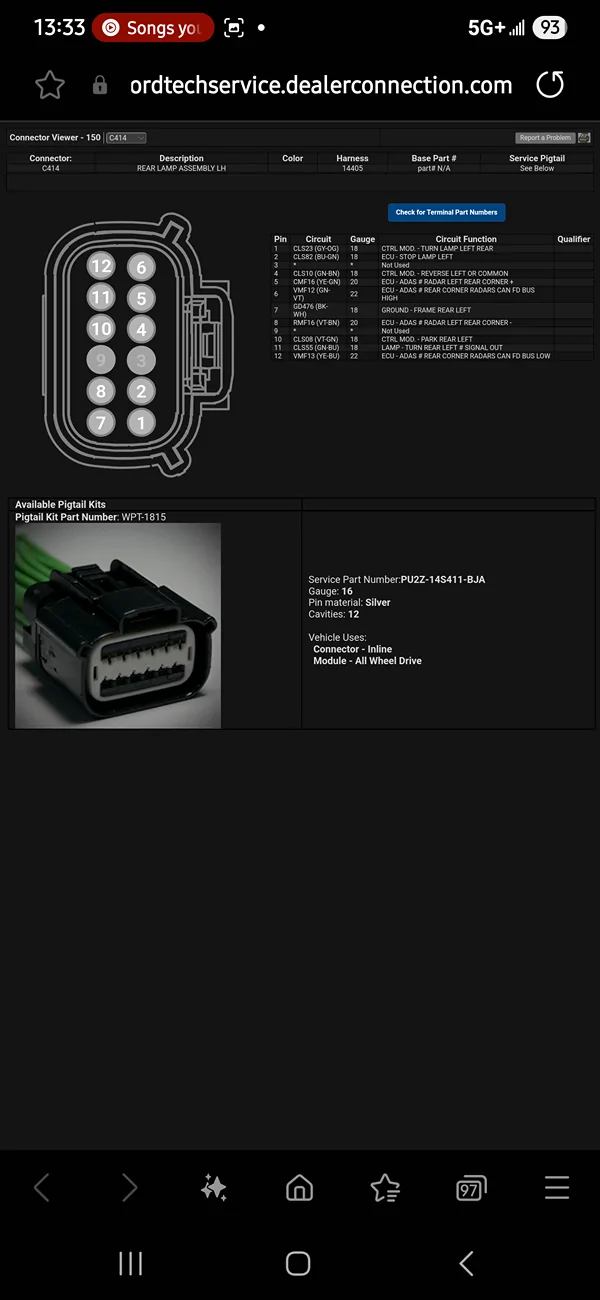

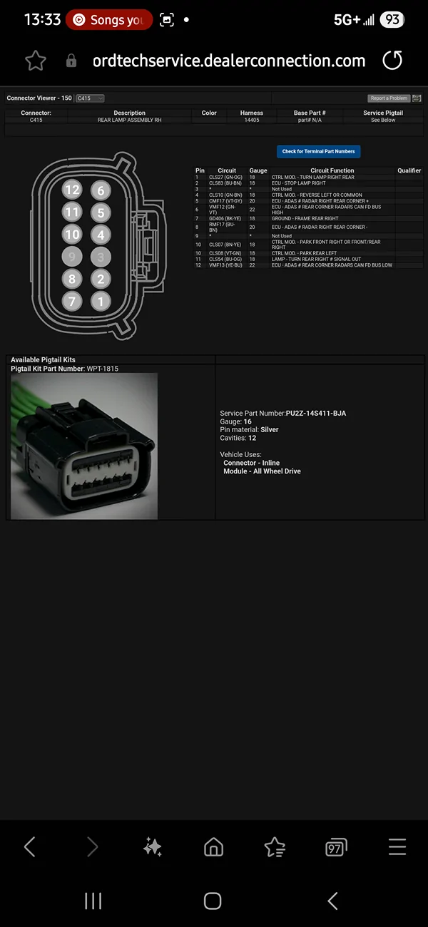

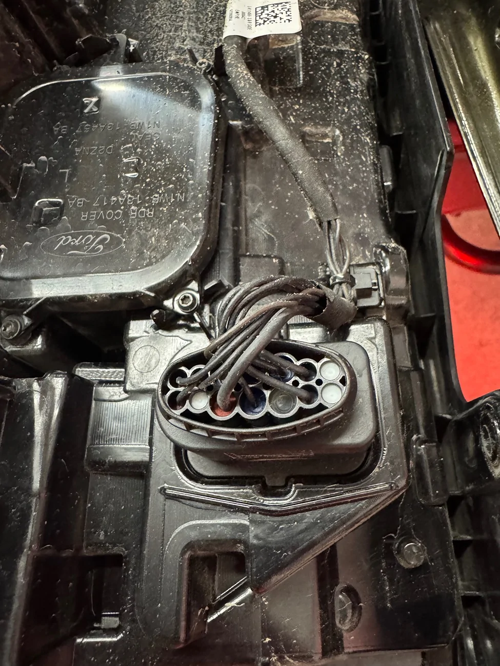

does anyone who tapped directly into the rear brake lights have photos or a diagram so I know which wires to tap into? I can’t seem to find any information.
im sure this is what everyone’s looks like?
Ford Ranger Camper top 3rd brake light IMG_1222
Clearly, I'm pretty inept with these things…
ShadowDragon24
Apr 20, 2025
680
630
2025 Ranger XLT Fx4
Heavy Equipment Operator
both left and right side wiring for my 2025 xlt with the level 2 tails(not full led like raptor)
