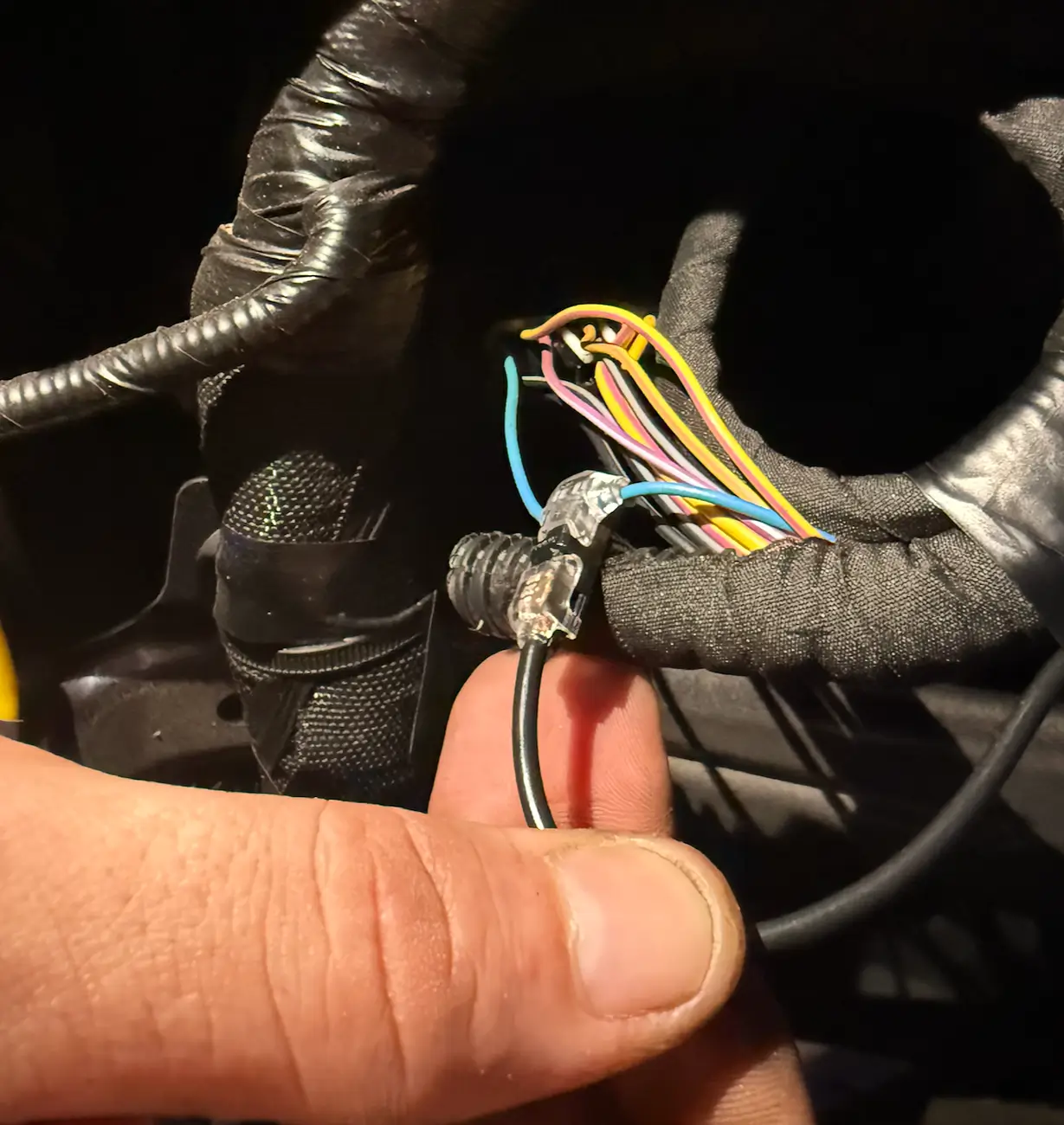

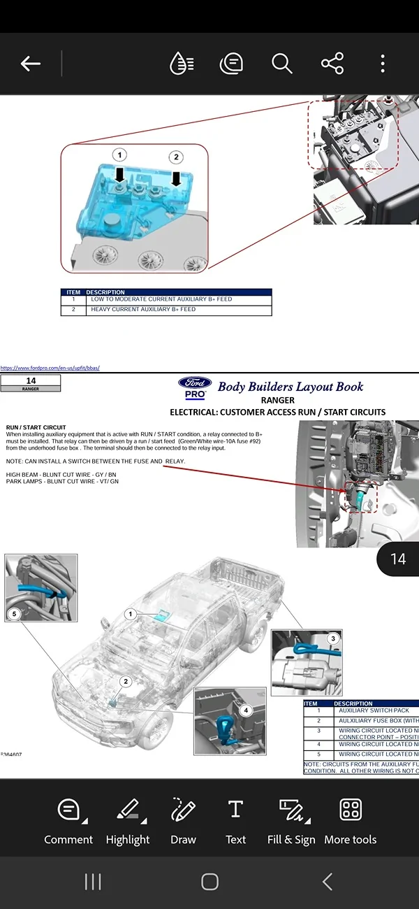

theres a blunt cut wire for ignition on called run/start, high beams and marker lights behind the driver kick panel.
my marker light(pos light) and high beam trigger, while the matching colour and label as per the ford body builder guide.... the actual functions were switched. the highbeam wire is my marker. and the marker is my high beam. lol

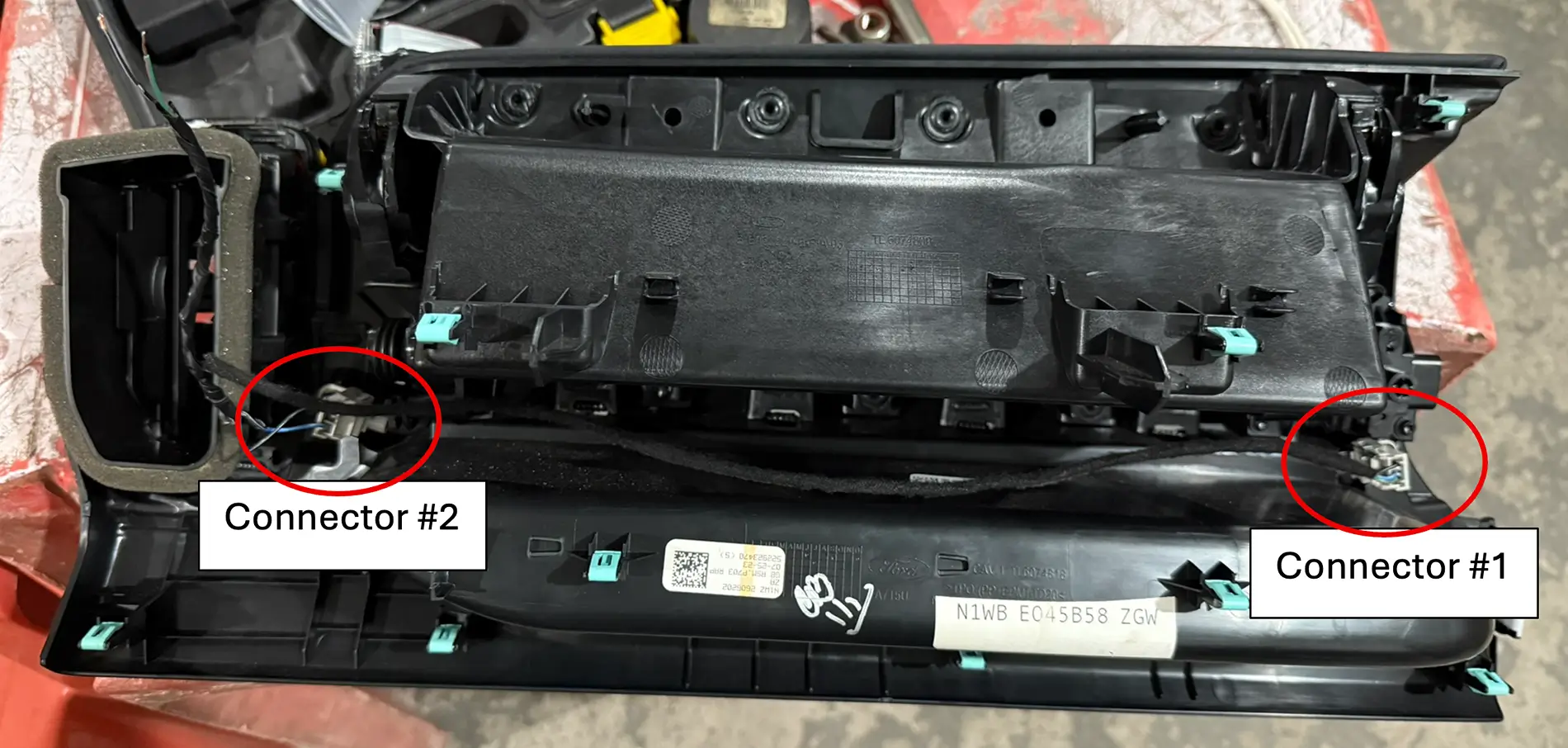

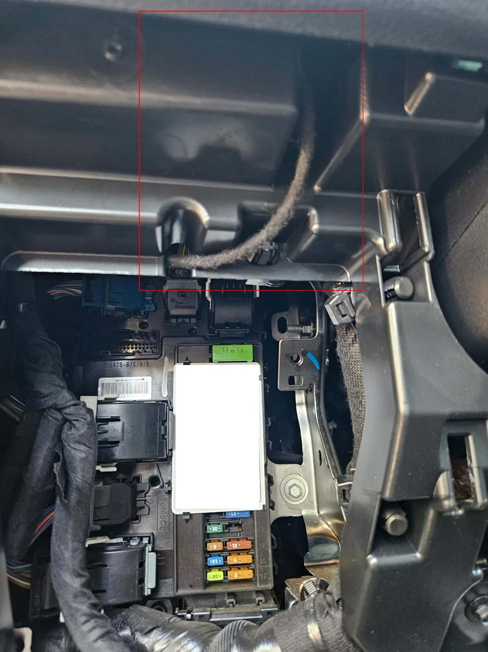

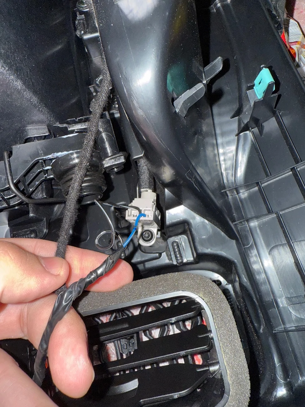

I think I at least figured out where the connector for the lighting is supposed to go, so solved that problem without needing to tear anything out at least. No more rattles! And looks like I can get to it later without needing to pull the dash again if I do decide to wire it up.

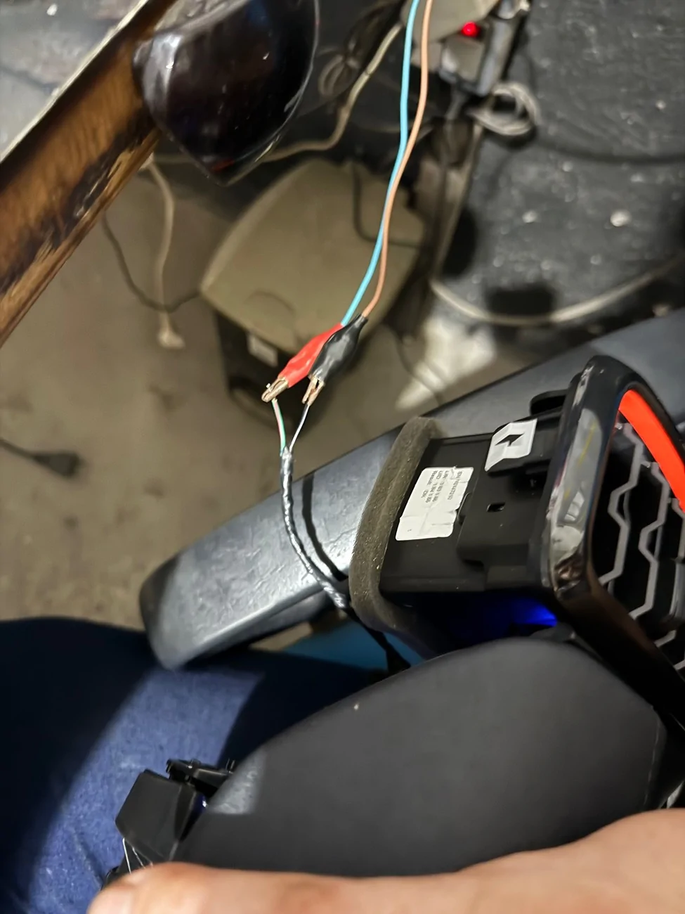

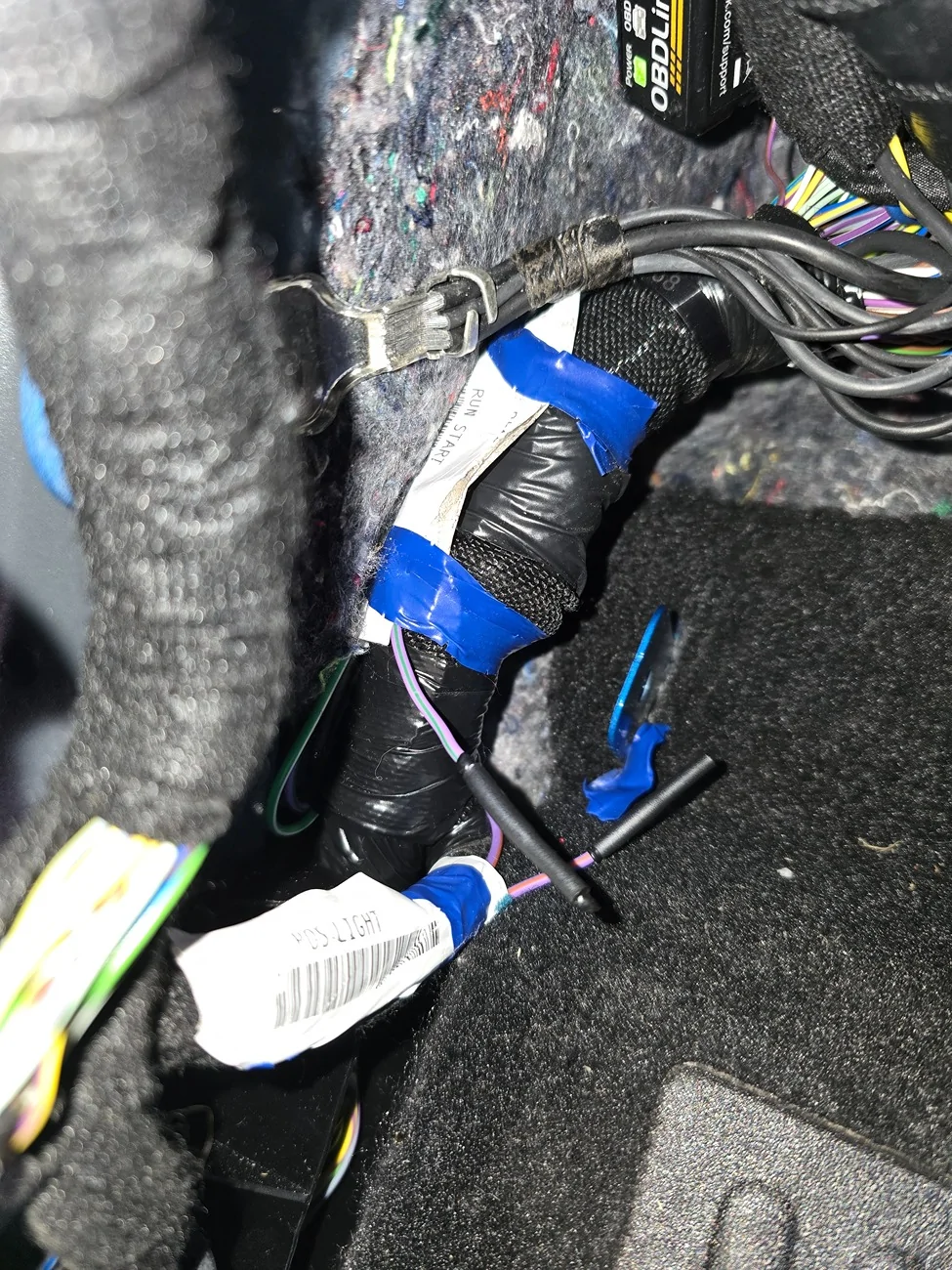

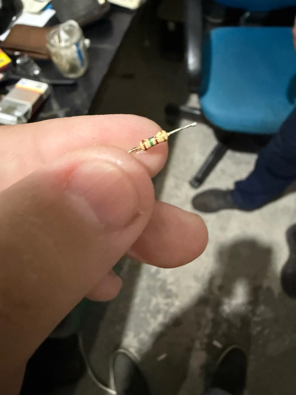

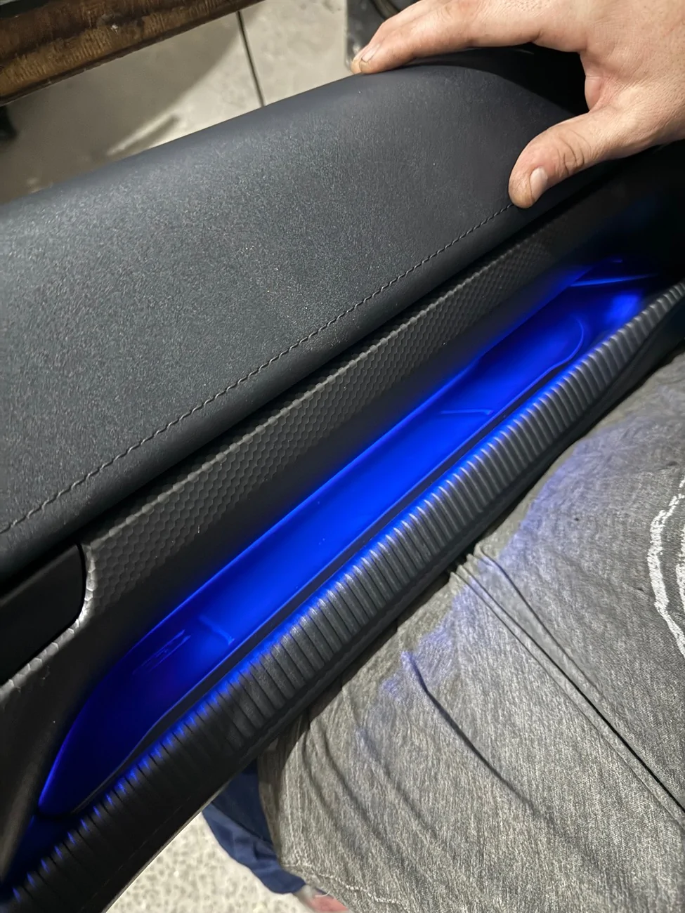

Hi guys.
I have some news. The whole solution for turning these lights on is this little guy: a 1k resistor.
Ford Ranger Lariat Top Glove Box Install on XLT IMG_4967
Ford Ranger Lariat Top Glove Box Install on XLT IMG_4969
Ford Ranger Lariat Top Glove Box Install on XLT IMG_4975
Ford Ranger Lariat Top Glove Box Install on XLT IMG_4974
Tomorrow I’ll try to explain a little better.

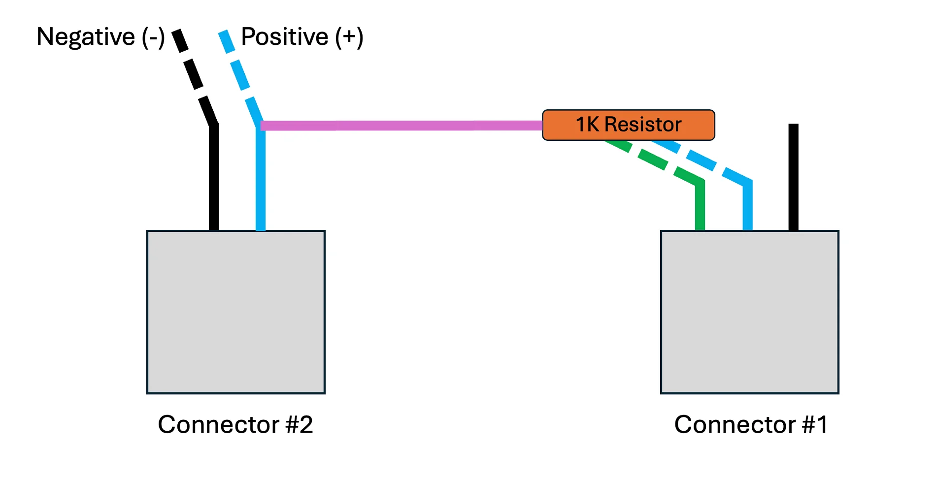

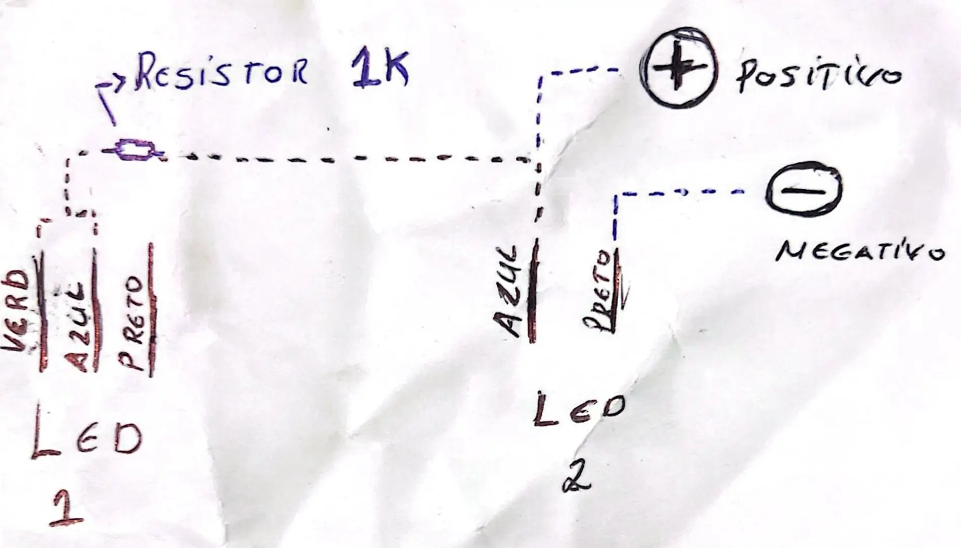

Guys, as promised, here is the diagram:
Ford Ranger Lariat Top Glove Box Install on XLT Screenshot 2025-09-04 at 20.55.03
Ford Ranger Lariat Top Glove Box Install on XLT Screenshot 2025-09-04 at 21.10.01
That negative you can connect to any metallic part (ground) and the positive you can connect to an individual switch or automate it by connecting to this blue wire from the headlight, so it turns the led on everytime my automatic low beam turns on (auto mode).
Ford Ranger Lariat Top Glove Box Install on XLT Screenshot 2025-09-04 at 21.33.44

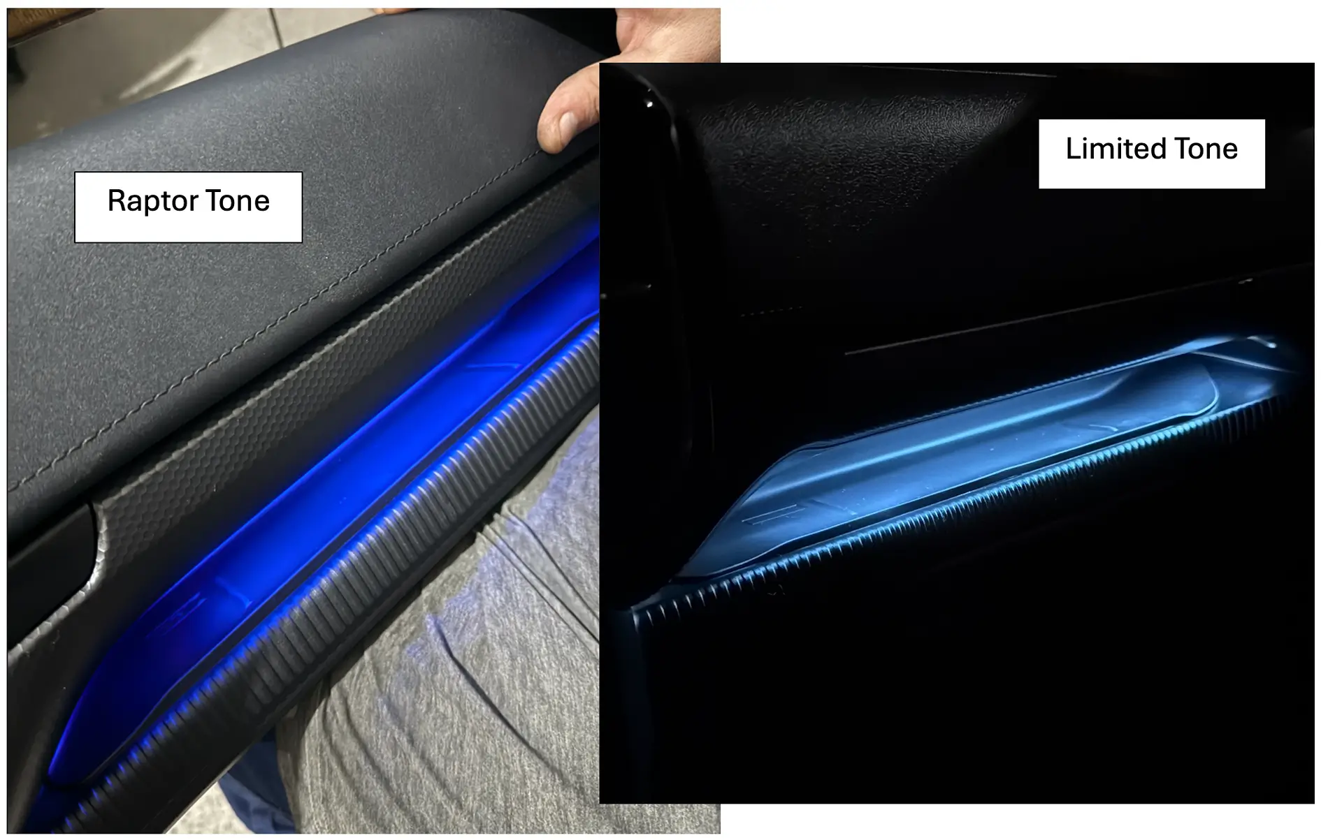

Some disclaimers:
1- I was not present when he did all this. I got there by the end of the day to have a look and take some pictures for you guys. The diagram he drew later that night:
Ford Ranger Lariat Top Glove Box Install on XLT Screenshot 2025-09-04 at 21.28.54
2- This upper glovebox is the Ranger Raptor model bought in US. The Lariat version can have different wire colors colors but the logic is the same.
3- Speaking of colors, mine upper glovebox came from a brazilian Ranger Limited (Same as Lariat in US) and it has a light blue tone, just like the buttons from the steering wheel, the AC, etc. The Raptor model has regular blue tone.
Ford Ranger Lariat Top Glove Box Install on XLT Screenshot 2025-09-04 at 21.27.57
4- My electrician asked me to tell you guys to test it all on an external source before connecting it to the vehicle to avoid any damage to the car itself.
5- This is the diagram for turning on only the passanger's side. If you did like me and also bought the drivers side, you have to use another resistor. As it has been a long time since he did it, he doesn't remember details on how he did it. It's the same logic.
Hope it helped. :fistbump:

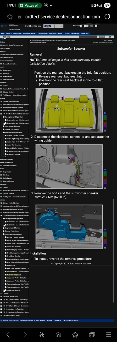

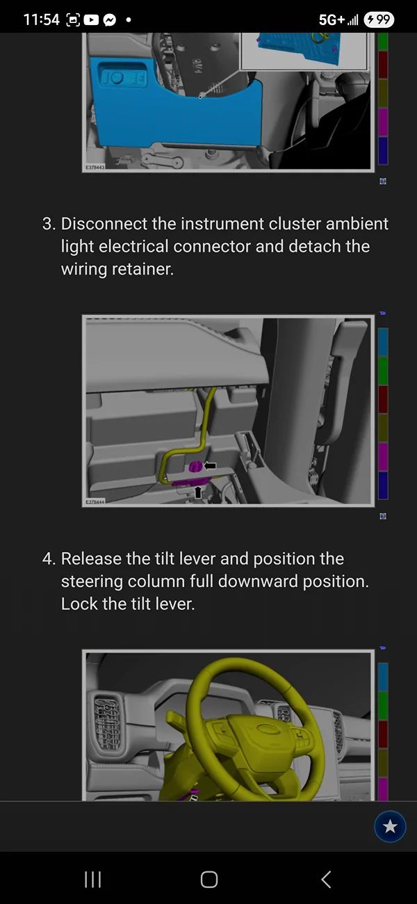

Awesome! Thanks so much for sharing this. I think my next goal is going to be to figure out what those connectors are so that I don't have to cut them off. I know they'll never be compatible with my harness... but I just hate snipping them and killing the possibility of better integrating them in the future if something more integrated comes along. That and figuring out how I want to switch them... I don't really want them on while driving, so headlights are out, I'd probably want them on when the domes come on, but that sounds complicated... Lots to think about!
get the 72 hrs subscription to the ford fsm. its over at www.motorcraftservice.com wiring diagrams, connector locations, pin diagrams for connectors. etc
