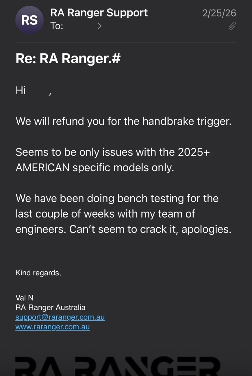

This was their response to my email - I brought up the differences in braking systems and control modules between the 2024 and 2025 MY.
It sounds like they shipped a bunch of boards to 2025 owners, had an “oh shit moment” when they realized the issue was with trucks and not a bad batch of boards, and were stalling as they tried to find a solution.
Thought it was interesting that they said only American (and I assume Canadian) vehicles are affected.
