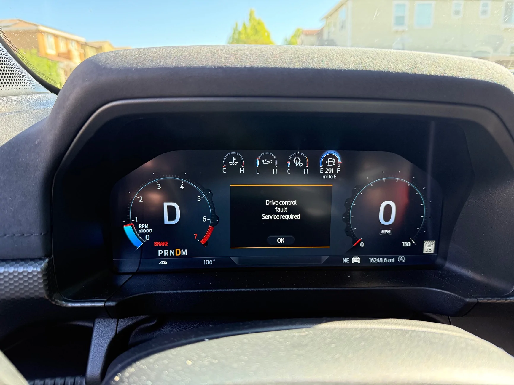

Mine started while I was off-roading in Baja mode. It's drivable but it asks me each time I start it if I want to return to Baja mode. Notice in the image that the suspension and steering options do not appear. It goes in again to the dealer tomorrow.
Ford Ranger Do not buy one Drive Control Fault
I broke the ride height sensor on the rear swing arm a year ago on my first off-road outing. It hasn't been an issue. Forums suggested this is for headlight leveling. I tried to order the replacement part and Ford can't seem to figure out the part number. Now that this problem is occurring, they said they need to fix it first before they continue to diagnose the problem. I get it. But, don't put a cheap plastic sensor, on an off-road truck, in an area where it could potentially break, without proper underbody protection. I have since installed FMI protective plates. The mode selector never switched on my without my interaction.
