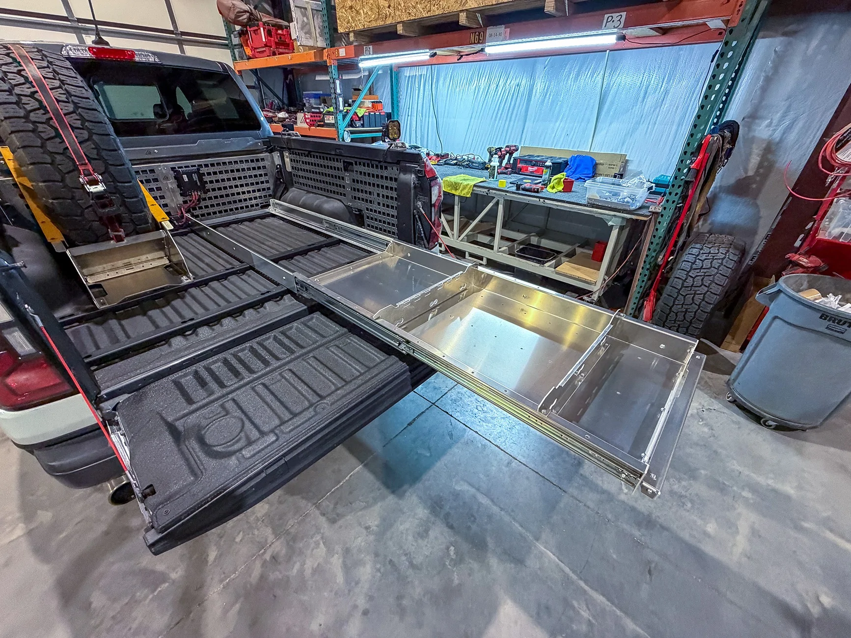

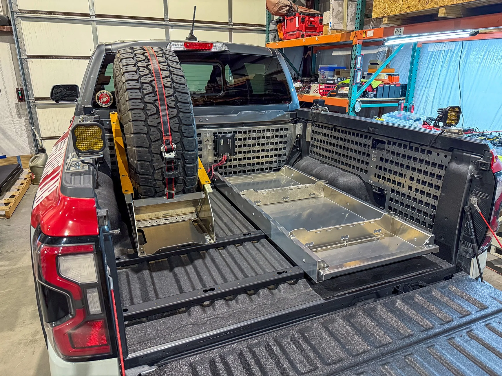

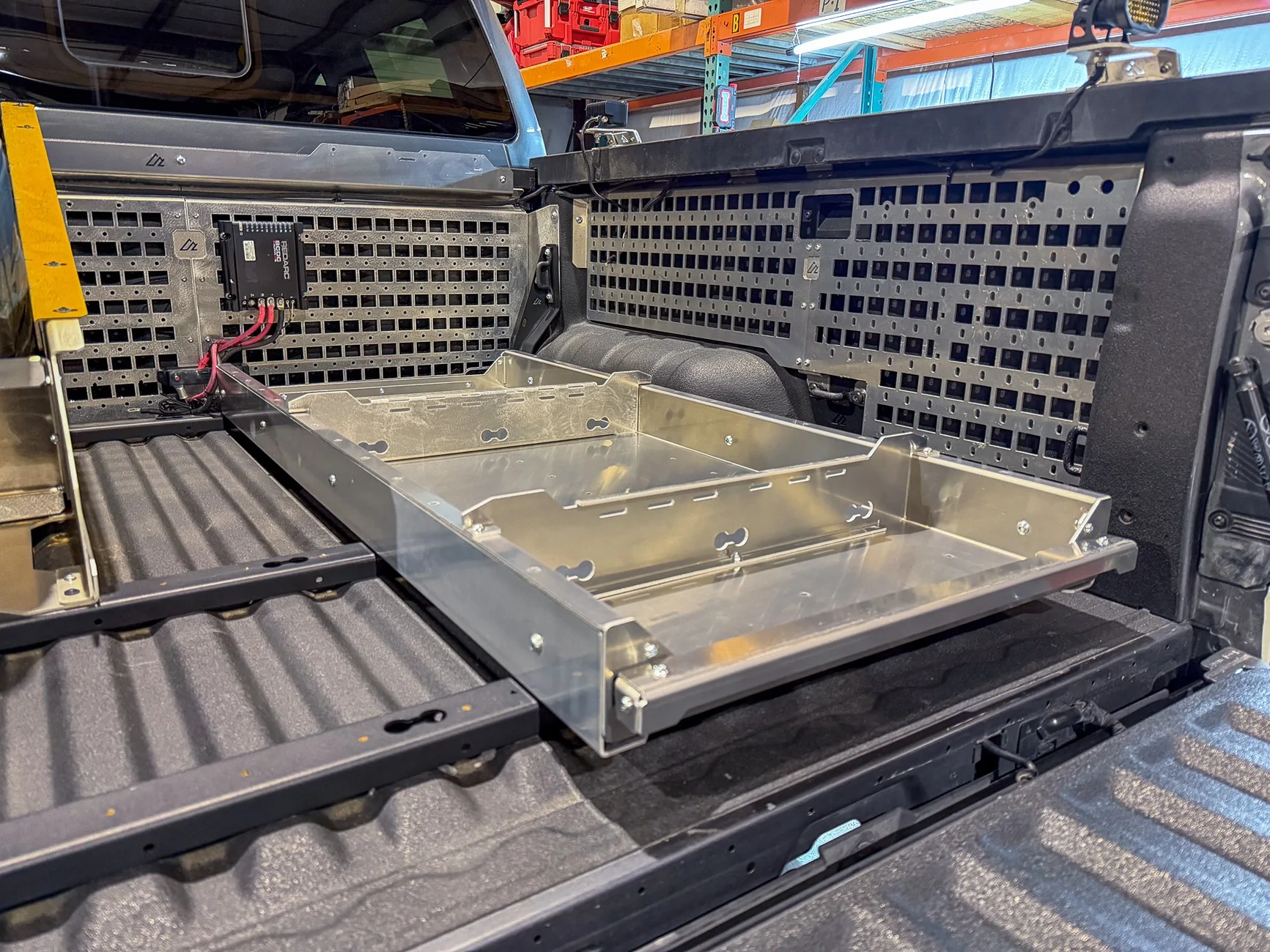

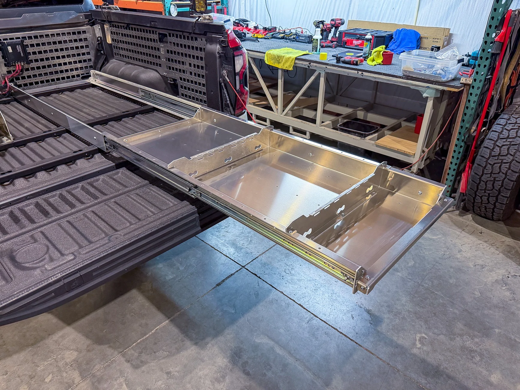

Here's the updated production version of the slide! Very happy with it.
I am going to try to have it up on the site tonight, but realistically, I still have a lot of non-computer tasks on the docket today, so it may be tomorrow before it's live on the site.

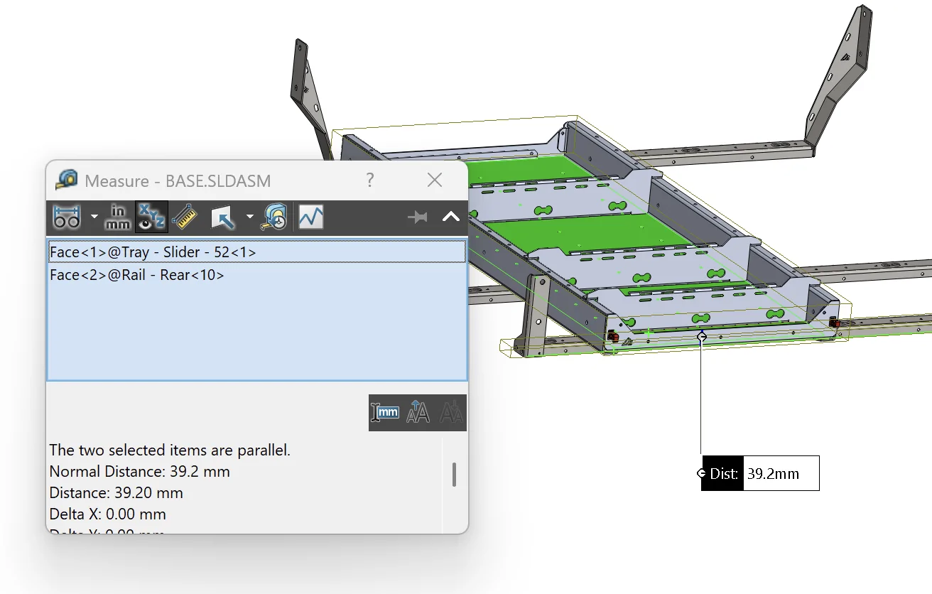

@AdventureLab . do you happen to know the height of your bed rail system with a slider tray? I’m trying to see if my fridge will fit inside one with my bed cover closed. Thanks

39.2mm from the bottom of the steel BASE rails, which sits flush against the bed surface, and the fridge mounting surface.

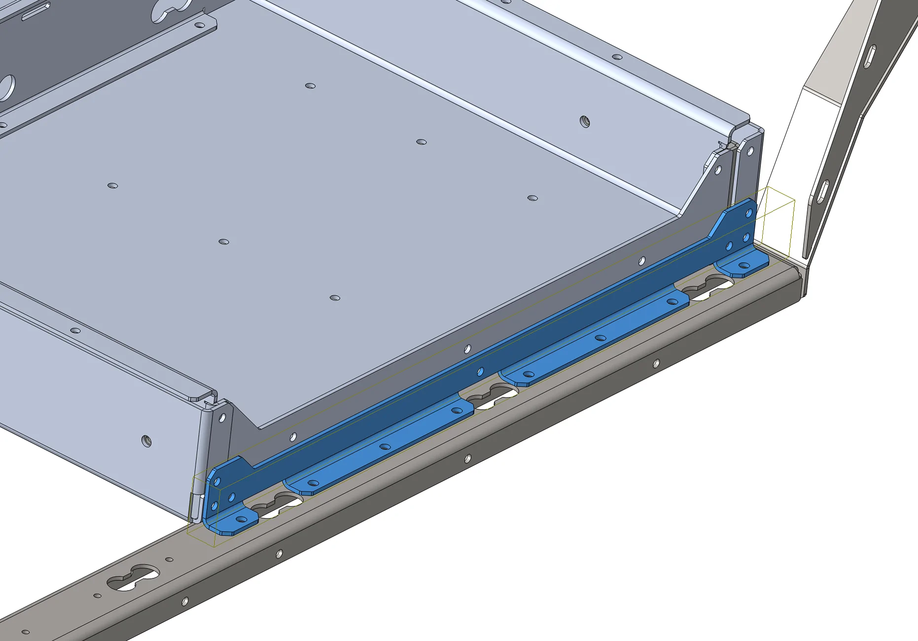

On the product description, it states the external length is 54.88" long. Didn't this get shortened to~52" or was that internal dimensions?

Good question about the length. Yes, we did shorten them to use 52" slides so they could install and remove easier. However, we still have to extend to the front-most BASE rail. The "outside" measurement is from the tip of the slide handle to the bottom edge of the attachment flange in the back. That extra flange was added so the attachment bolts could be easily accessed from above for this slide and the matching drawers (coming soon).
