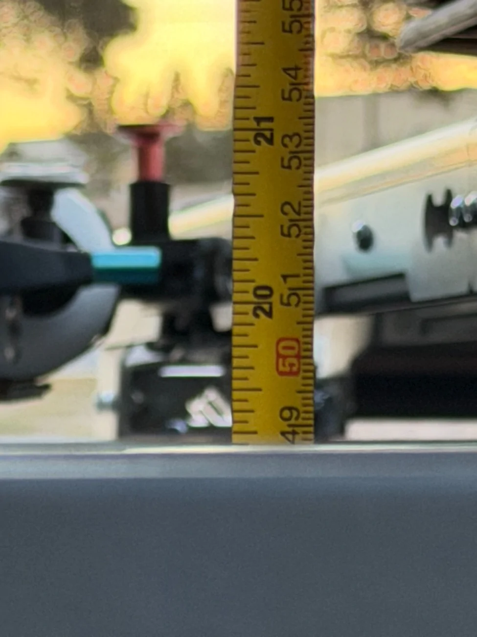

@PatrickT
It was really hard to get this photo, so I'm surprised it came out as good as it did. It looks to be about 19.25" above the floor of the slide to the top of the bed side. I tried to get the phone as level as I could with the opposite bed side, but every time I did, the phone kept switching lenses and then it was too low. 🤣

Perfect! Thanks for checking. That should work.

Also, I just noticed I typed 19.5 in the previous reply. It's actually 19.25. I missed the two, which does make a difference. I just wanted to let you know about the typo.

Thanks for the clarification. That does make a difference. It still may work with a little bit of flex in the cover and opening the cover at the very back. That’s what I have to do now. The fridge is 19.3 inches tall.

Gotcha. This is as low as we can make the slide. It's very close to the tailgate when the slide opens. That's our limiting factor - the tailgate is actually higher than the bed floor when opened.
