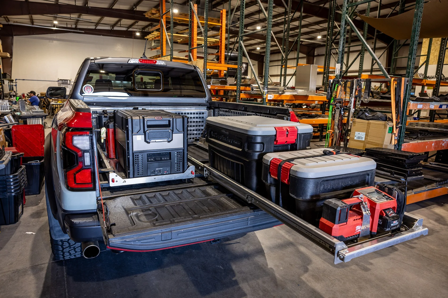

Looking at the CAD video vs the prototypes, will the final slides be slightly wider than what we see in the photos with the prototypes?
I think that might be adding to the confusion regarding use of space--the cad looks better fit and spaced than the prototypes to me.

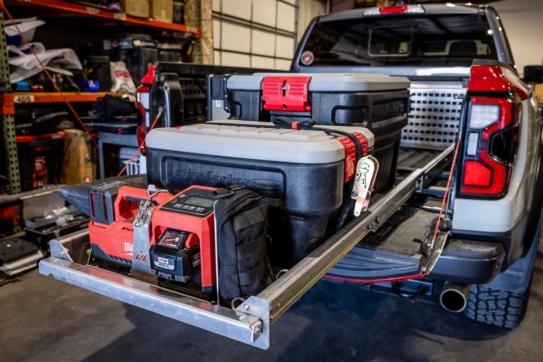

Yes, the production slides will be about an inch wider. I agree about that causing part of the confusion. I thought the same earlier, but didn't mind the extra explanation. 😁
The slides that are in the photos are actually from our Gladiator line. Since our rails use the same pattern throughout every vehicle, we're able to offer a ton of different sizes. So, if you only wanted a narrow slide, you could use one of the other ones. Or, if you only wanted a short slide (ie fridge only), you could use one of our SUV slides (ex. https://americanadventurelab.com/product/mass-storage-fridge-slider/).

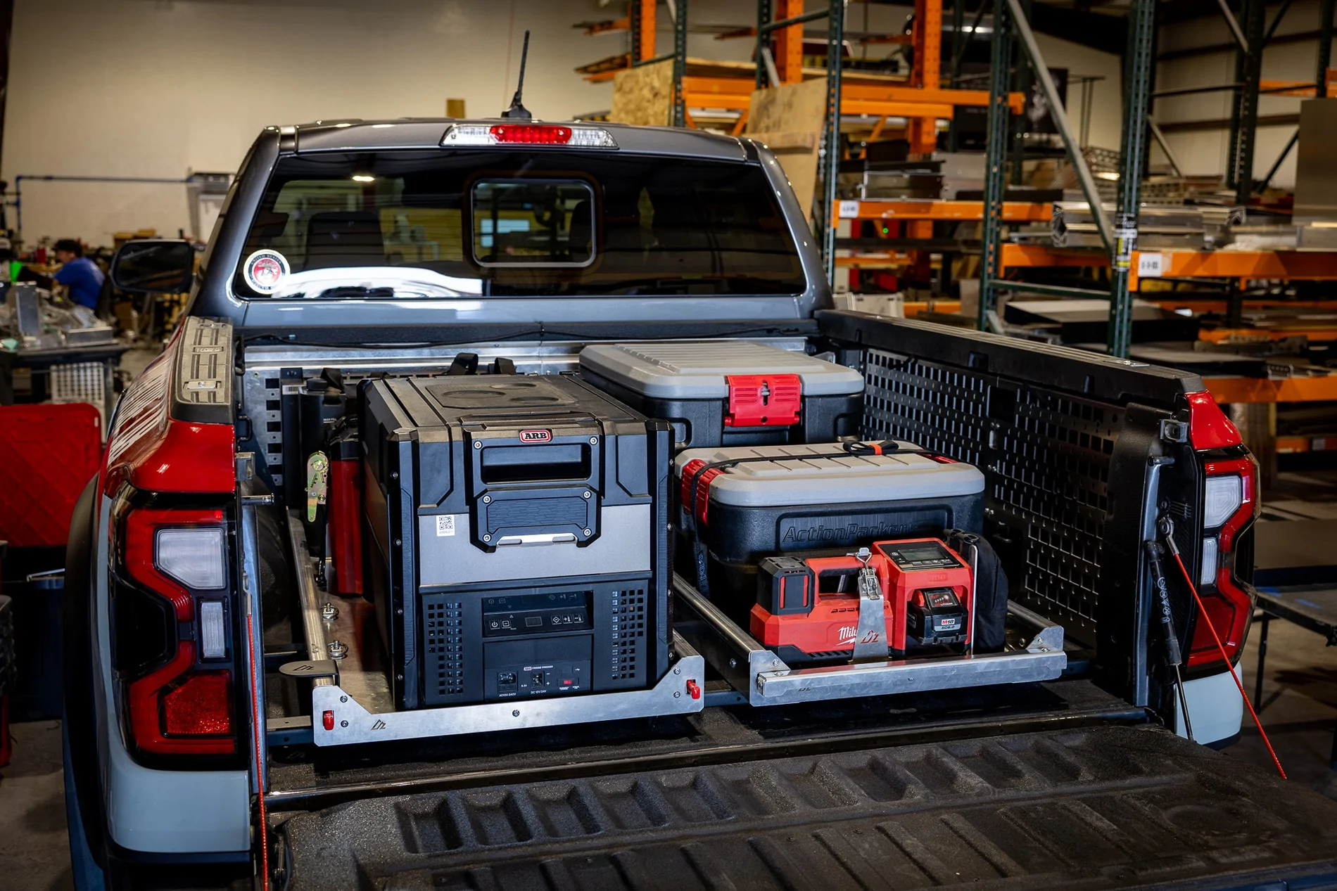

Here are a few shots of the prototypes we have in the truck now and that we used on the Trail Hero Expeditions show.
Agree with wasted space between the slides/drawers. ,You can make them mount closer. This might be due to the predrilled mounting points on your BASE system. Which brings me to my suggestion. Make the BASE system a T-track. Its is way better and has unlimitted mounting options and an “infinite” mounting location points. It also costs less to produce as you dont need to pre drill at fixed mounting points and tap it. I have the MASS on my jeep and have the same problem with limited mounting locations.

As per the most recent posts, the prototype is using sliders from the gladiator platform which has a narrower bed. The final slides will be more in line with the video of the CAD--about 2 inches wider total (1" per slide) if my understanding is correct, which should make for a better fit.

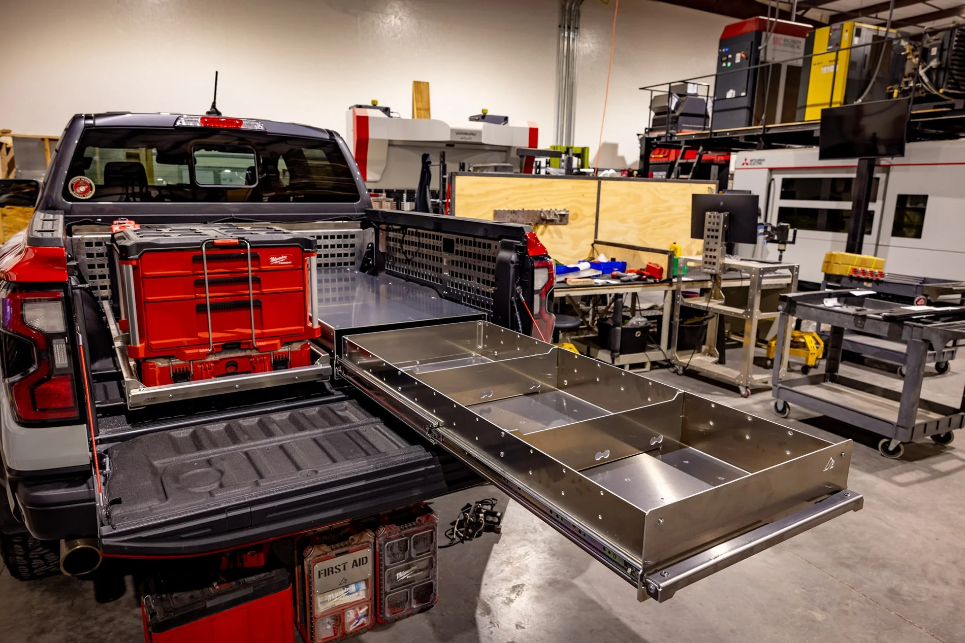

Here's an updated CAD model. These parts are sitting beside my desk, ready to go into our RR to debut at the Raptor Rally next week. Can't wait for you guys to see these! It's sooo much storage. The slides and drawer are all 3mm 5052 aluminum. Drawer slides are 54" huge. The drawer slides are zinc-coated steel and have a lifetime warranty from the manufacturer.
I should be able to post some updated photos and video early next week.

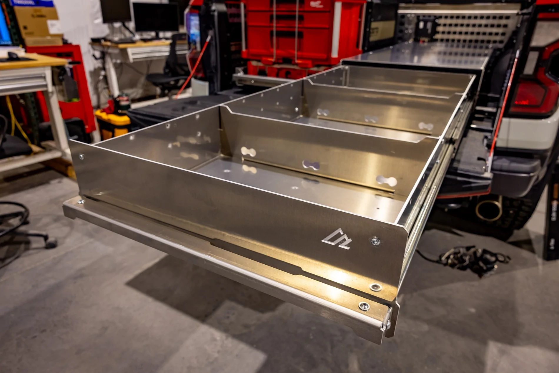

Here's a look at a new divider design I came up with. We'll be using this design in all of our new products going forward. The dogbone shape is for a L-track connector so you can add tiedown points anywhere quickly and easily without having huge holes in the floor of the drawer/slide. The slots in the top are for 1" cinch straps. It's the most functionality I can pack into a divider..... so far. 😁
Two of these will ship with the slide and two with the drawer. They are spaced evenly at 100mm.

Cant wait!!!! :clap::clap: Based on the CAD, it seems like the drawer will clear my retractable bed cover’s storage bin.
Btw, whats the height of the drawer? Also surprise us with a big intro discount for the forum members.

I like your negotiation strategy! 😁 I would definitely be down for a launch-discount on these. I really like how you guys contribute to these product R&D threads. It's a huge help for me during the design process. The feedback had a huge impact on our Rear Seat Delete.
The drawer is 7" tall and the rail it's bolted to is about 1" above the peak of the bed floor corrugations, so about 8" above the bed floor.

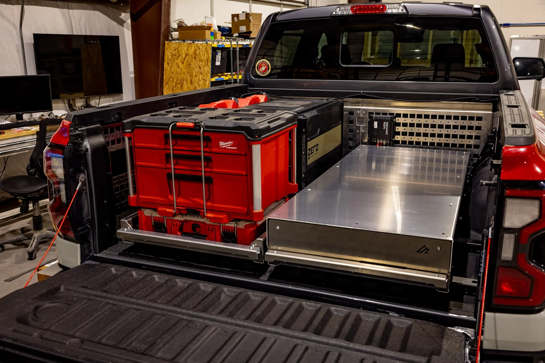

Here's a preview of the big slider. This is the widest truck slide we have made to date and it's a ton of room. Everything is 3mm 5052 aluminum. The drawer slides we use are 54", full extension, lock in and lock out, lifetime warranty. Fully bolt-in.
The 6" drawer will go in today or tomorrow.
