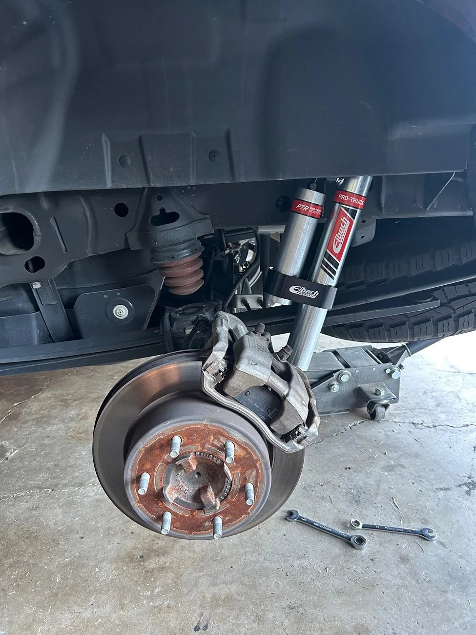

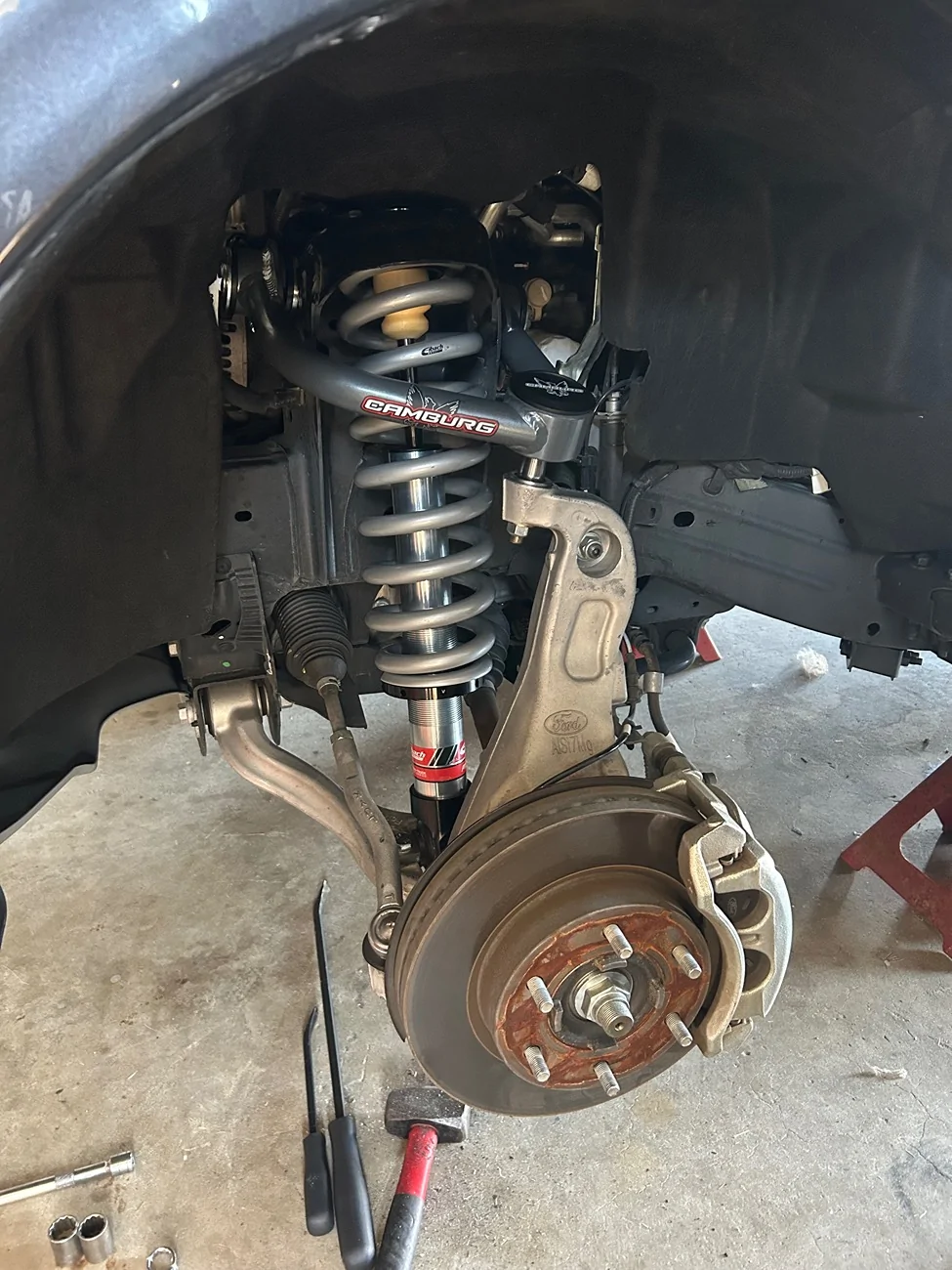

Installed my kit with camburg UCAs, planning on putting some 285s on in the future. Debating between Mickey Thompson Baja boss or bfg KO3s. Let me know if any of you would recommend one over the other.
but the lift is nice, i will say that it was a pain in the ass to get the driverside UCA out because I had to disconnect the steering arm in order to get the UCA bolt out. Idk if any of you guys had the same issue. Can feel more of the ground chatter when driving but still breaking in the shocks but happy with the feel and look of it.

Nice! How much overall lift did you get?

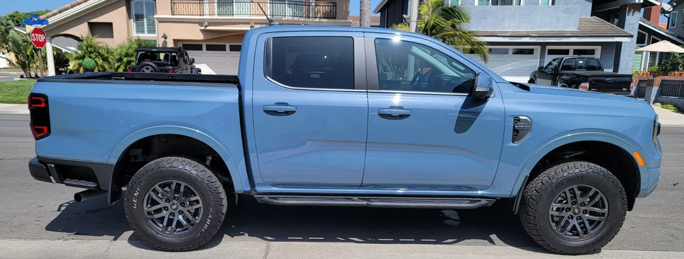

Finally got around to having mine installed today, very happy with the outcome. The ride quality is even better than I anticipated, very smooth.
I had the dealership that I bought the truck do the work because I'm on the mend after some minor surgery a few weeks back and they made me a deal I couldn't say no to.
Dealership also told me they reprogramed / recalibrated the 360 degree cameras, something I hadn't given any thought to, probably because I've never owned a truck with this feature before.
