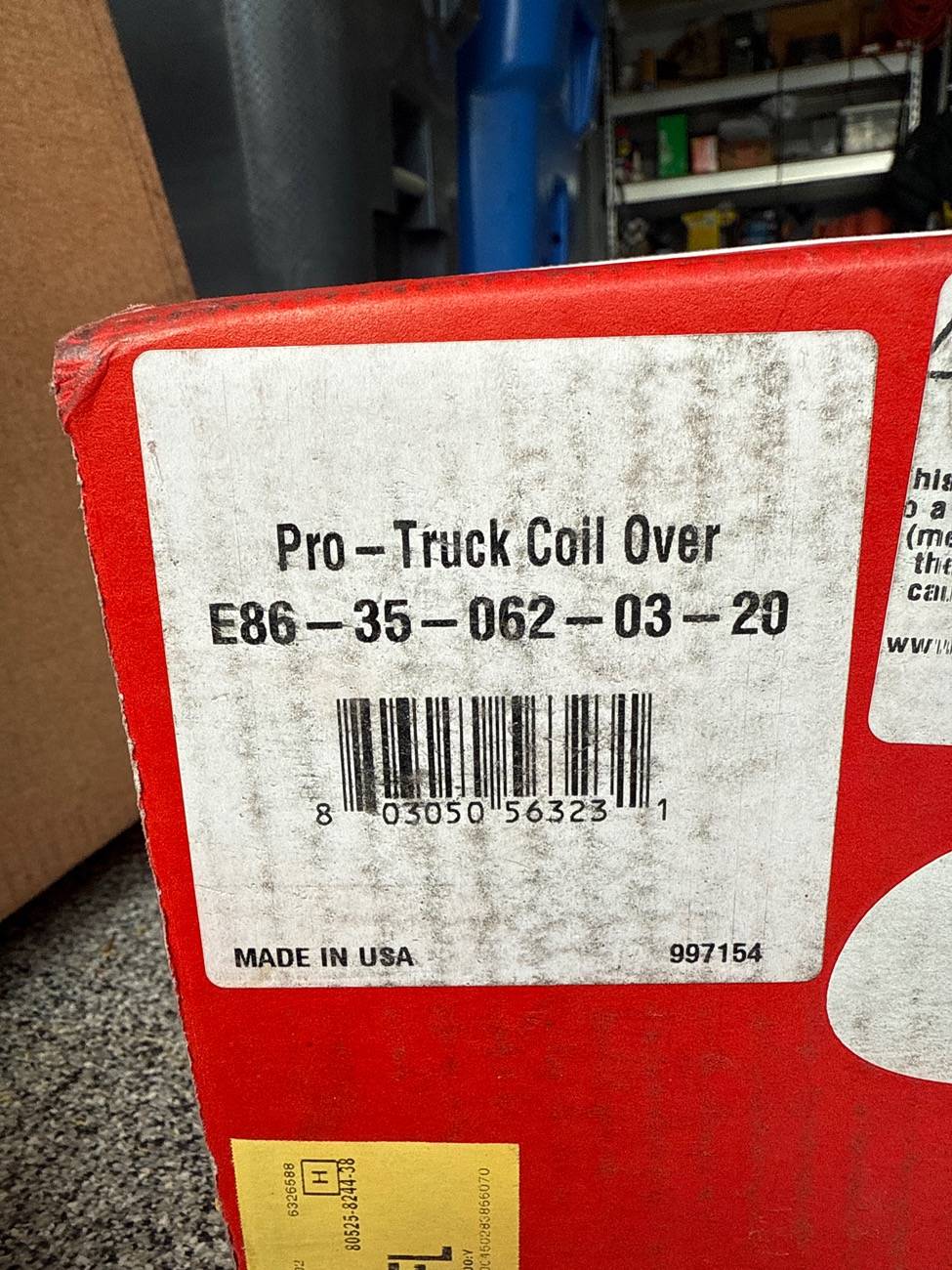

Much to my surprise an Eibach kit showed up on my porch yesterday. I just got off the phone with Eibach and they confirmed this is the part number for the coilover kit for a 24/25 Ranger 4WD with a 2.7L engine, and that this was the first kit to ship! The guy on the phone said it should be up on the site any time now.

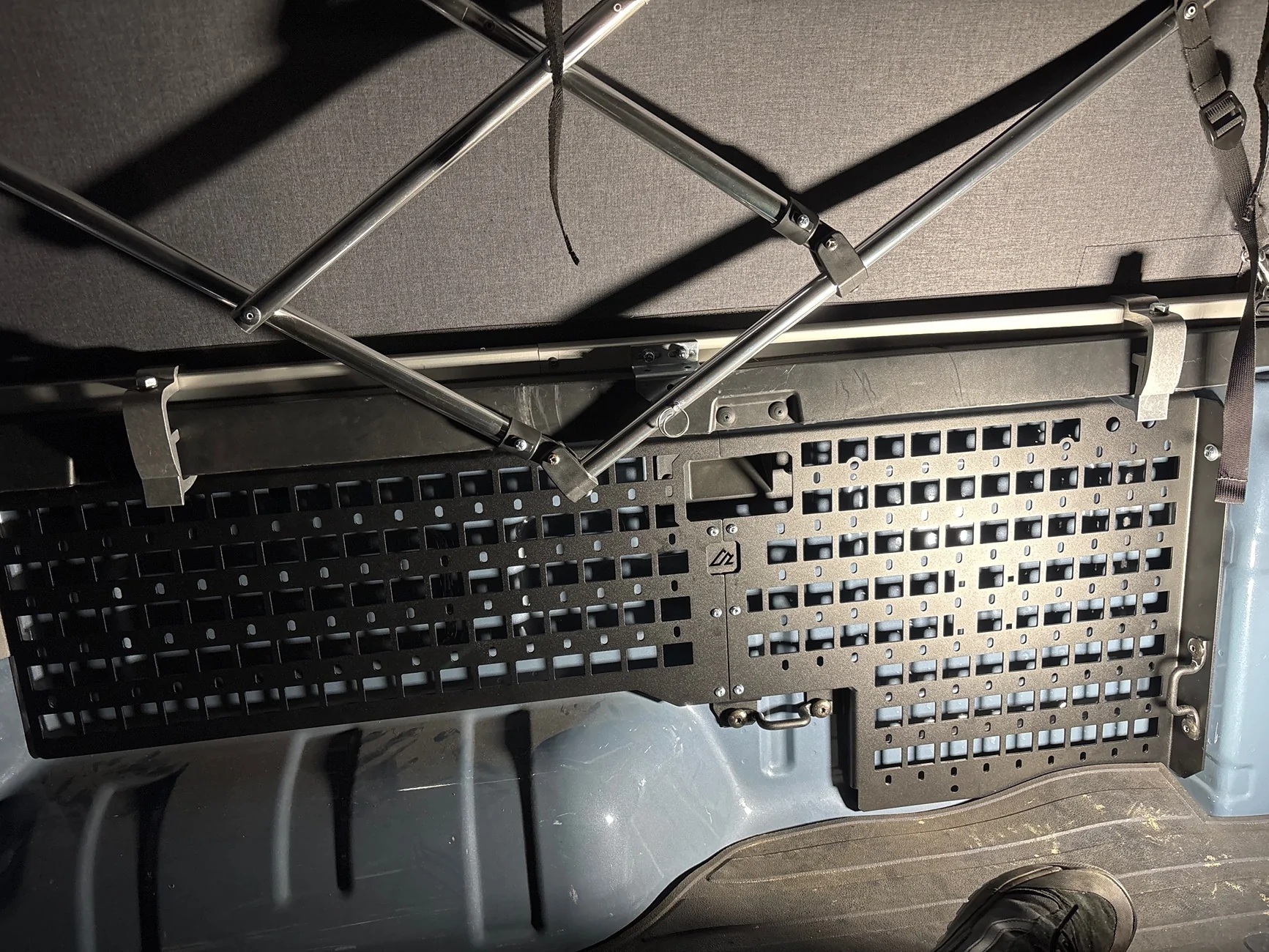

I’ve done a couple changes to the ranger over the past couple of weeks. First was the softopper which was pretty easy to install. I would recommend installing it when it’s warm so the material is more malleable. Second I installed my American Adventure Lab passenger molle panel. I guess Ford thought it was a good idea to use loctite on those cheap tie down brackets… And finally I installed the Eibach kit (E86-35-062-04-22) w/ the Superpro UCAs. The lift and UCA were fairly simple to install. Only two hiccups I had were that I did not have many bigger sized metric tools so I had to run to the store to pick some up. The other issue I had was drooping the hub enough to pull the shock out. Ford used pressed in studs on the shocks and they would not come out when I tried to hit them out so I just ended up cutting the studs off.
I still have a bunch of items I need to knock out including EGR j braces, some wheels and tires, and adjusting the height.
