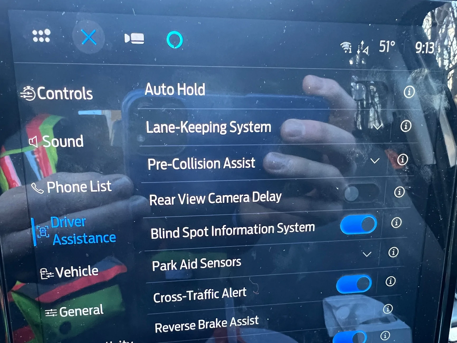

Thats a possibility, but not a habit d mine. Coming from a 94 f150. I dont recall specifics, but I read somewhere in the forum where someone unbuckled seatbelt ,disabled autohold for parking in close places
Mine seemed to release the brakes when I fastened the seat belt.

Sounds like "auto hold." This is my first experience with auto hold. At first, I thought why. After using it, I like it.
Edit: Since my auto hold is set, I notice after starting in a parking lot where I do use the parking brake, the auto hold is set even after releasing the parking brake. Still takes a throttle input to release.
