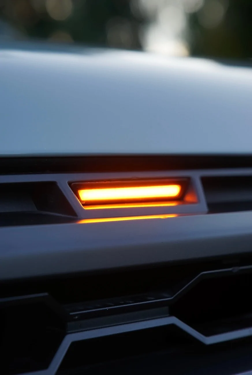

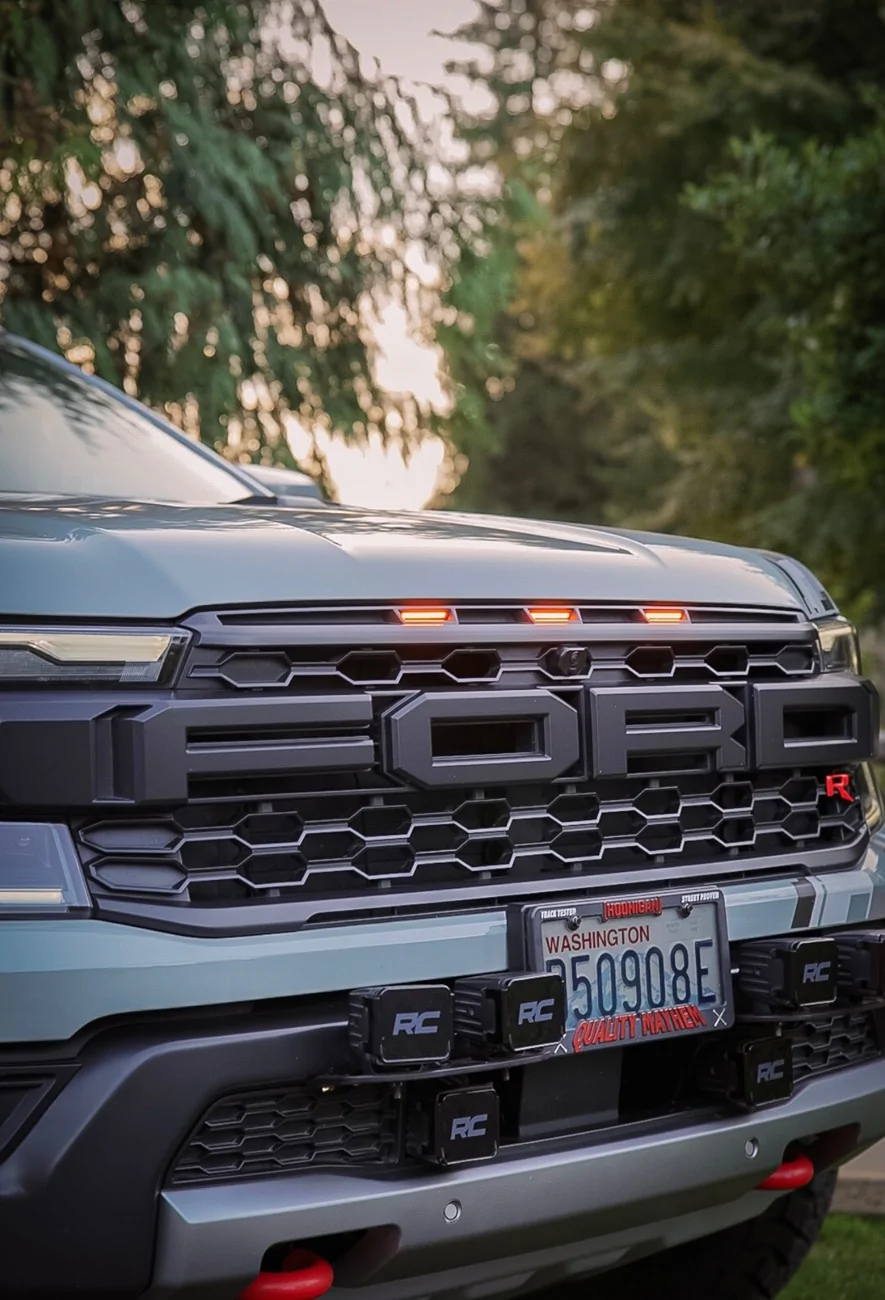

For ease of install get a fuse Peggy back and power if off fuse 30, powers the marker lights.

Wow, angry much? They fit the cut outs perfectly, snip the wires and reconnect on the back side, happy now?

You may be looking at the original square ones that were generic, the new ones are tapered to the openings. I do agree the plugs could be smaller, but the post that smuggest removing the grill is a great idea! Super easy I have had mine out before to mount the front light bar.

I did squeeze one through like they showed doing it in the video, and decided it was really more of a PIA to go that route figured out it was just a lot easier to cut and splice them back together. I think I had them installed in around 20 min. Really wasn’t a big deal.
‘I had tried 3 different sets from different companies in my 24 RR, and by far I like fit and look of the latest F150 LEDs the best.
Do I wish they would source smaller plugs to simplify the install? Sure I do.
But really I am very happy with them overall, the install is a 20-30 min thing, once in they look and work great. I do plan to use them again on my new build as well. I don’t know of anything better out there.
