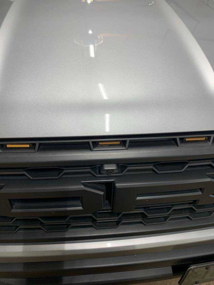

My F150leds fit flush since I modified them. I took a little material off the top and bottom of the housings, mostly towards the back, slightly tapering them so the rear of the housing is slightly thinner than the front.

Thanks. Do you have any photos of the area you sanded down?

No, I tried to pull one out of the grill pocket to take a pic but I didn't leave enough slack in the wires to remove one.

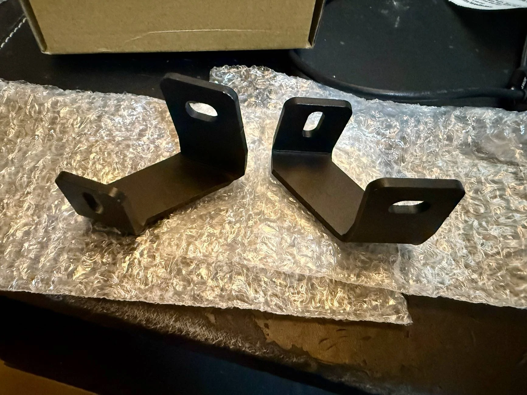

When I had a chance to open the box and attempt to install the lights, to my surprise they didn't fit. I had specially ordered the lights for 2024 Ranger. Fortunately, I still had the ditch light brackets from my 2022 Ranger Tremor to compare to and they matched up perfectly. So, they sent me brackets for the previous generation of Ranger. I reached out to them and requested that they ship me the correct brackets.
Well, I patiently waited for the replacement, which they promised would be delivered promptly. I received the shipped email with the tracking information, and two days later, I was able to track it as received by the local USPS in Georgia. It arrived this past Monday, but unfortunately, I was out of town on business and couldn’t open the package to see what was sent. Naturally, I wasn’t surprised to see that they had made another mistake. I have absolutely no idea what these metal pieces are or how they’re supposed to be mounted with the lights. There’s no way these are going to work with the 2024 Ranger. I had made sure to purchase the lights that were to be shipped with brackets specifically designed for the 2024 Rangers.
At this point, I’ve decided to move on from F150LEDS. I hope I don’t encounter any warranty issues with the products I’ve purchased so far. As a Christmas gift for my sister-in-law, I also bought grill lights for her Bronco. It’s disheartening when try you support small businesses like F150LEDS, especially when they support the Ranger5G and Ranger 6G forums so beneficial to its members, only to have your expectations not met due to poor customer service.

When I realized how big the holes needed to be to get the connectors through I decided it would be easier to drill the holes from the back side of the grill. So I looked on youtube and found out it was only a 10 minute job to remove the grill. I used a 7/16" drill bit and reamed the holes a little extra afterwards. It would be nearly impossible to drill holes that big from the front without causing damage to the pockets. However with the lights in place they may hide damage to the pockets? I wanted to avoid damaging the pockets so the extra 10 minutes to remove the grill and 10 minutes to reinstall it was worth it to me. I also sanded the housings down a little to fit flush in the pockets.
