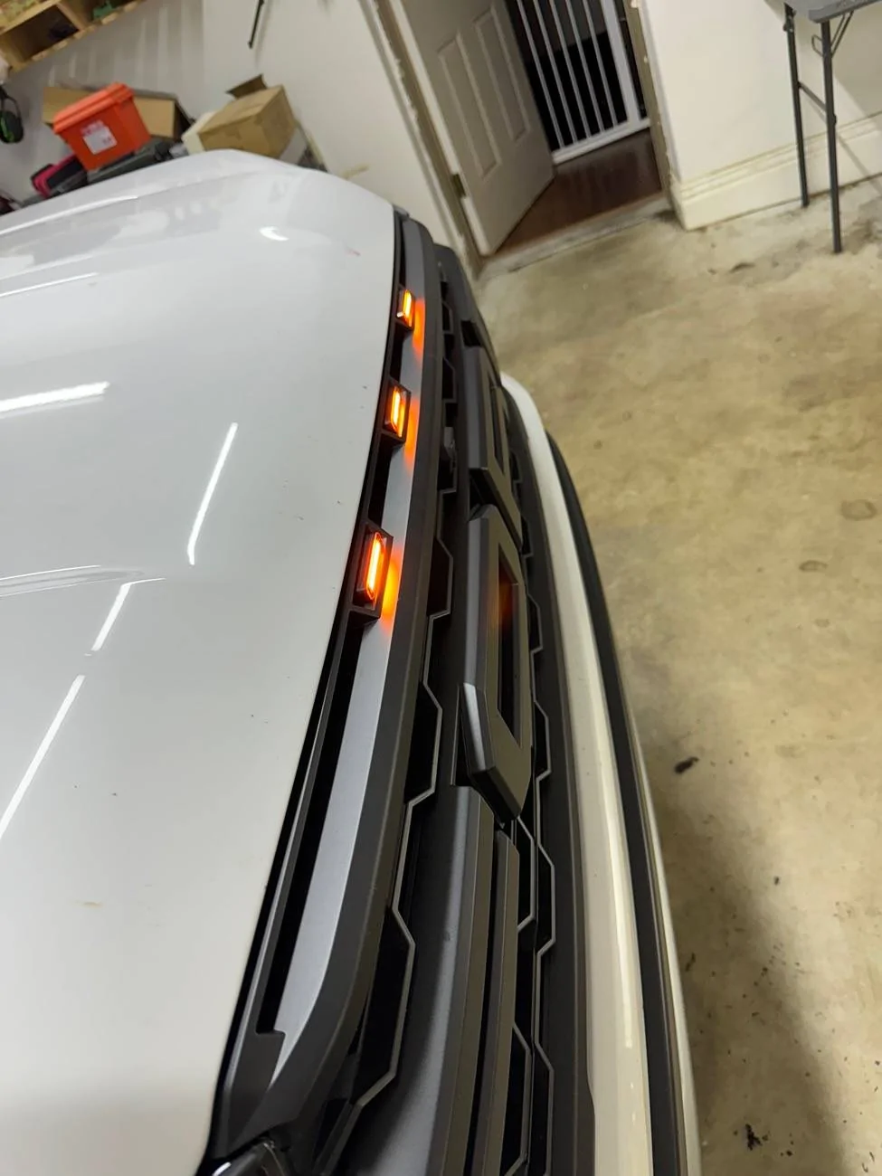

I would agree many of the comments. I also posted a few insights on this when I installed the lights on my 2024 RR. My approach was different than many others. I took the grill off and inserted the lights from the back. I was uncomfortable shaving down the light to make it fit and risk damaging the light. So I inserted the light from the back of the grill. I pushed them into position from behind. In hindsight, it is tricky, but was actually easier than I made it sound. I like the lights, they are the best; but you'll need to modify the installation to get them to fit correctly.

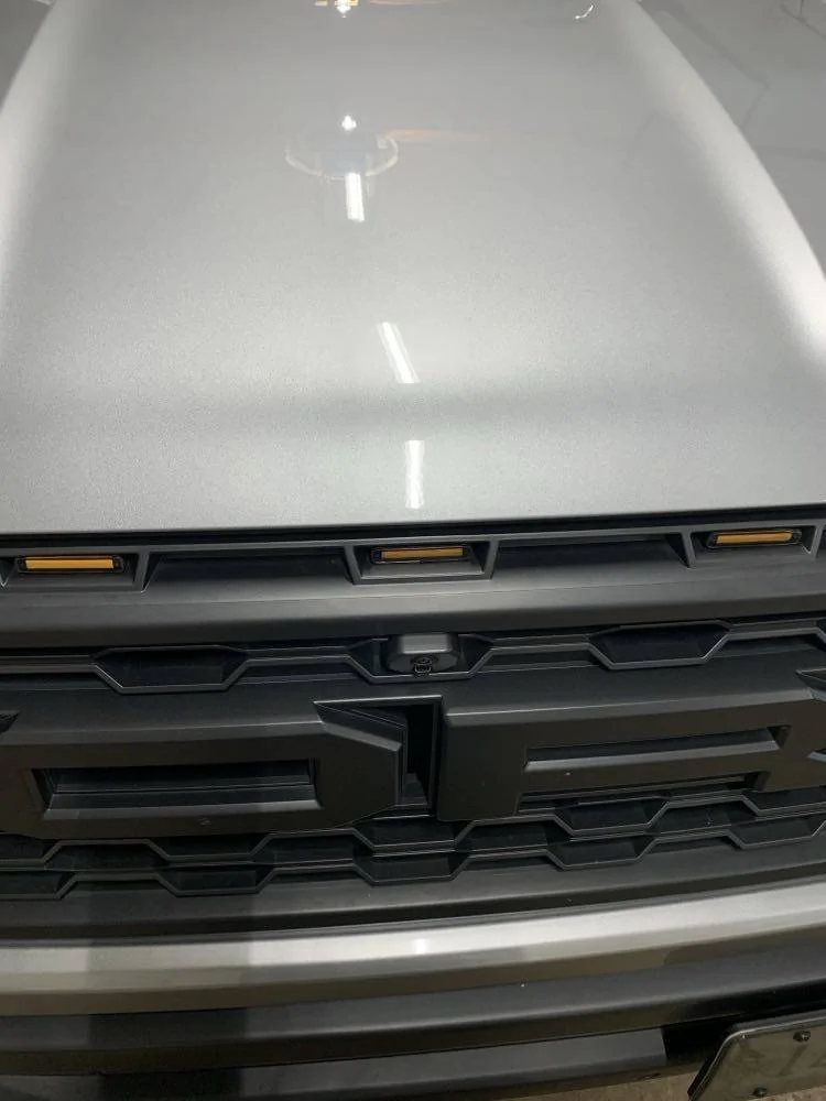

Welp. I have a confession to make. You can drill through the grille and run the wires as advertised in the video. Does the video capture how painful the process is of drilling? No. Should you take the grille off to do this, 100%. If you are super diligent, you wont have any scuff marks showing from the drilling.. I have minor ones.. im just happy I was stubborn enough to keep trying 😂. And it absolutely takes a 7/16 drillbit. I walked my in sizes every time I drilled.

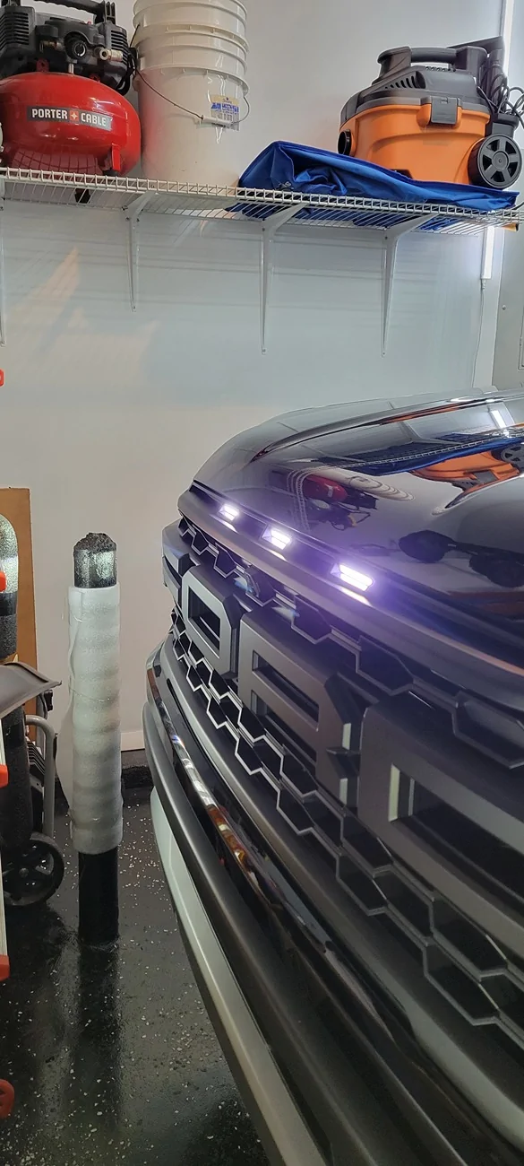

What stopped you from cutting the wire and using a butt connector on the other side?
IMHO this is the only way that makes sense. The reason I say that is yes you can make the 7/16" drill bit work. I did but you zero margin for error. I have two small marks that will bug the crap out of me. Make no sense for them to use a connector that big. Then you go to wire it up and realize the harness while of decent quality is way to long. Why have to deal with such a big ball of extra wire. The new Gen LEDs are very bright. I am editing my post. If you accept that you will have to cut the connectors, which is not a big deal, or remove the grill this is a ok option. The LED modules are made to fit the opening and give even light, no individual dots.
