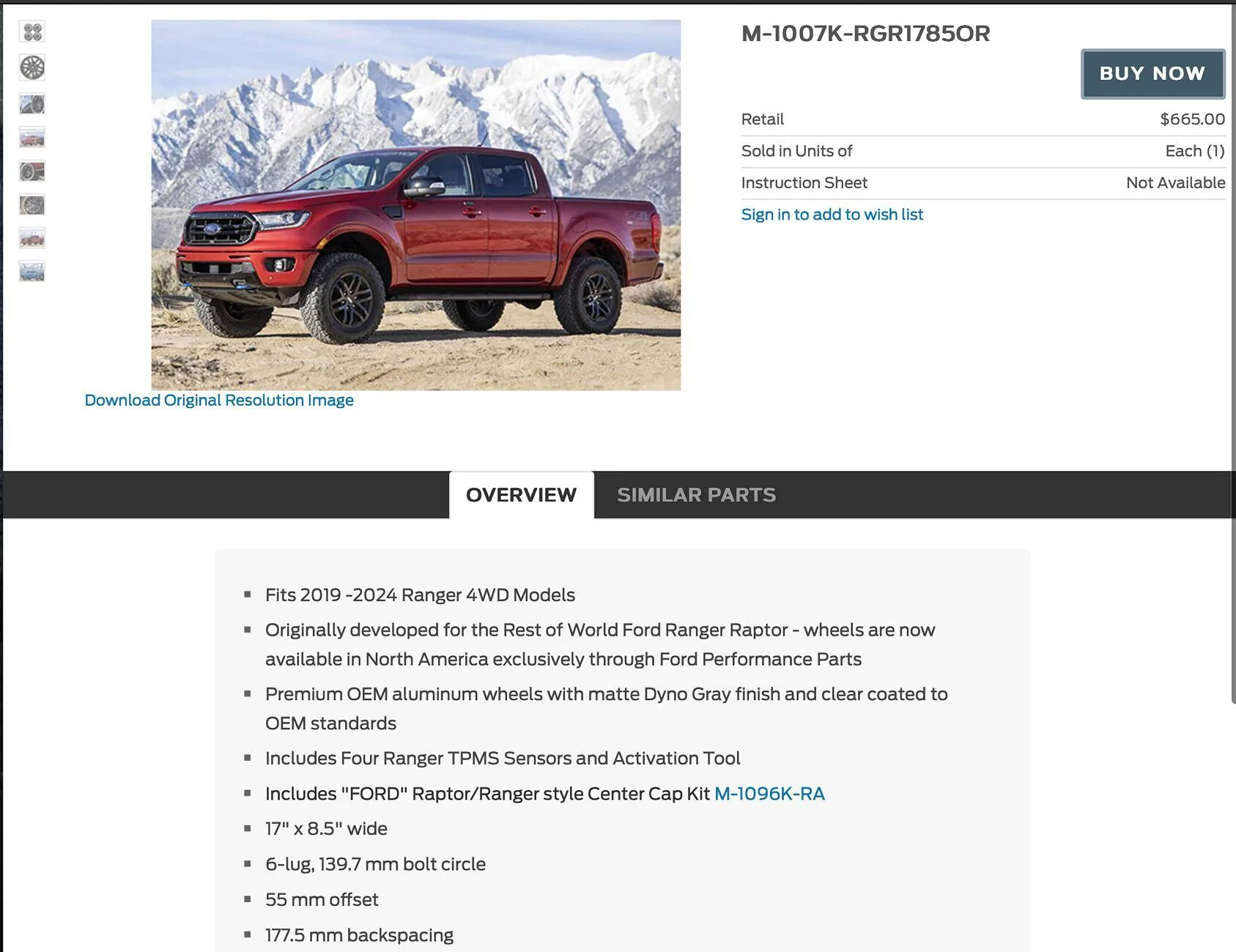

Not using them but is that $665.00/rim? Look at black rhino I believe they have a similar style.

The description says it includes 4 TPMS and it also mentions it's a kit, so I say it's 4 wheels. Good deal if you want factory offsets.

Yes. Not sure how long it lasts but ford also has a 20% off sale on top of that. I ordered them and will find out if they are junk or not 😂

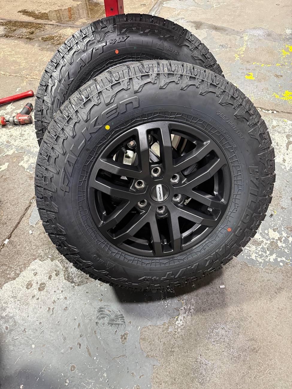

@dard6555
Did you use wheel spacers?
I went Wildpeak atw4 and never made it off the rack, knuckle was rubbing and was hard to spin the tire.

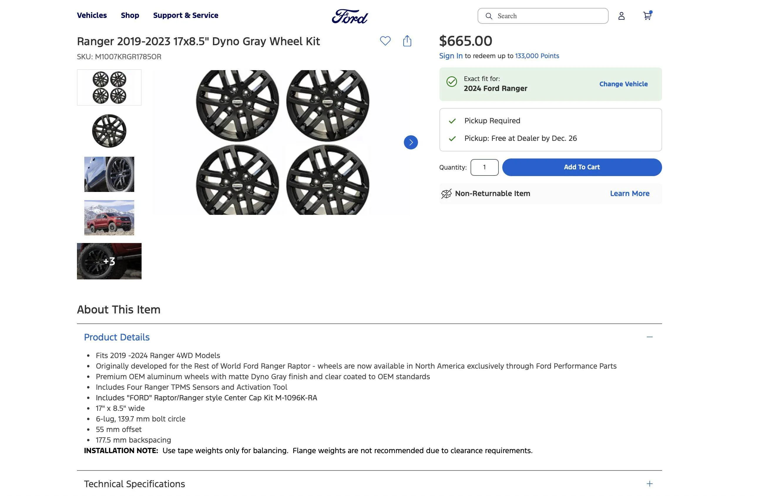

Welp, guessing it's posted up somewhere around here but I took an exact 1/2" thick piece of wood and it fits between the knuckle and and the stock tire but rubs lightly. That said the rims alone are 1" wider or 1/2" each side and with a stock width tire of 10.1" it will rub, the extra 1/4" of the tire made it to tight to run the wheel. These rims won't fit period without a spacer and that pisses me off. Ford needs to take down the advertisement below stating it will fit and hope I get my $$ back

I believe tire sizes can vary between manufacturers. The Falkens look bigger than the Mickey Thompsons and according to Tire Racks listed specs, they are 1/2“ inch bigger in section width despite both being 265/70s. The BFG K02 are showing the same size as the Mickey Thompson. I think that is where the difference is... at least I hope so because I ordered these wheels too.
