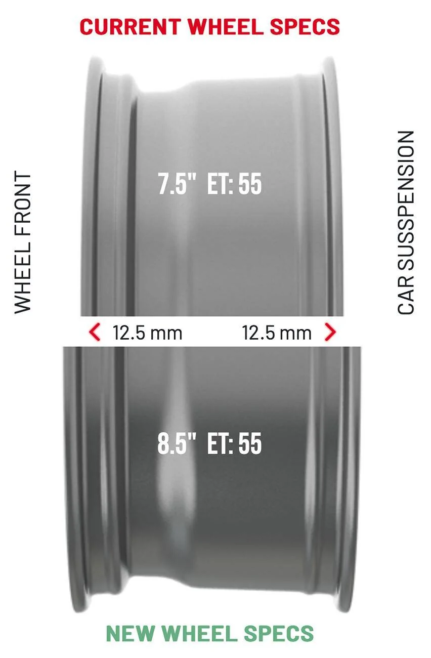

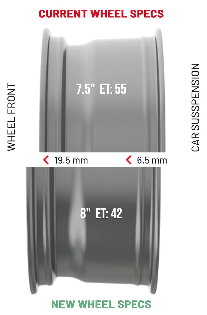

I've been asked to explain the offset issue. I've learned a lot in the last week, lol.
My stock tire and rim have 1/2" clearance between the tire and knunkle. Ford performance rim puts the tire right into it as shown below. Tremor rim gives more inner clearance and kicks the whole tire out 3/4"
  • most 24 rangers have 7.5 wide with 55mm offset.
  • Ford performance rims 8.5 wide with 55mm offset
  • Tremor ranger rims 8" wide with 42mm offset.
Pics show oem vs the rims listed above

I'm curious to see if the reduction of backspacing (+42 vs +55) will give you the clearance you need - I've seen others talking about +35mm wheels. I'm assuming that you will not be doing any sort of lift, at least initially.

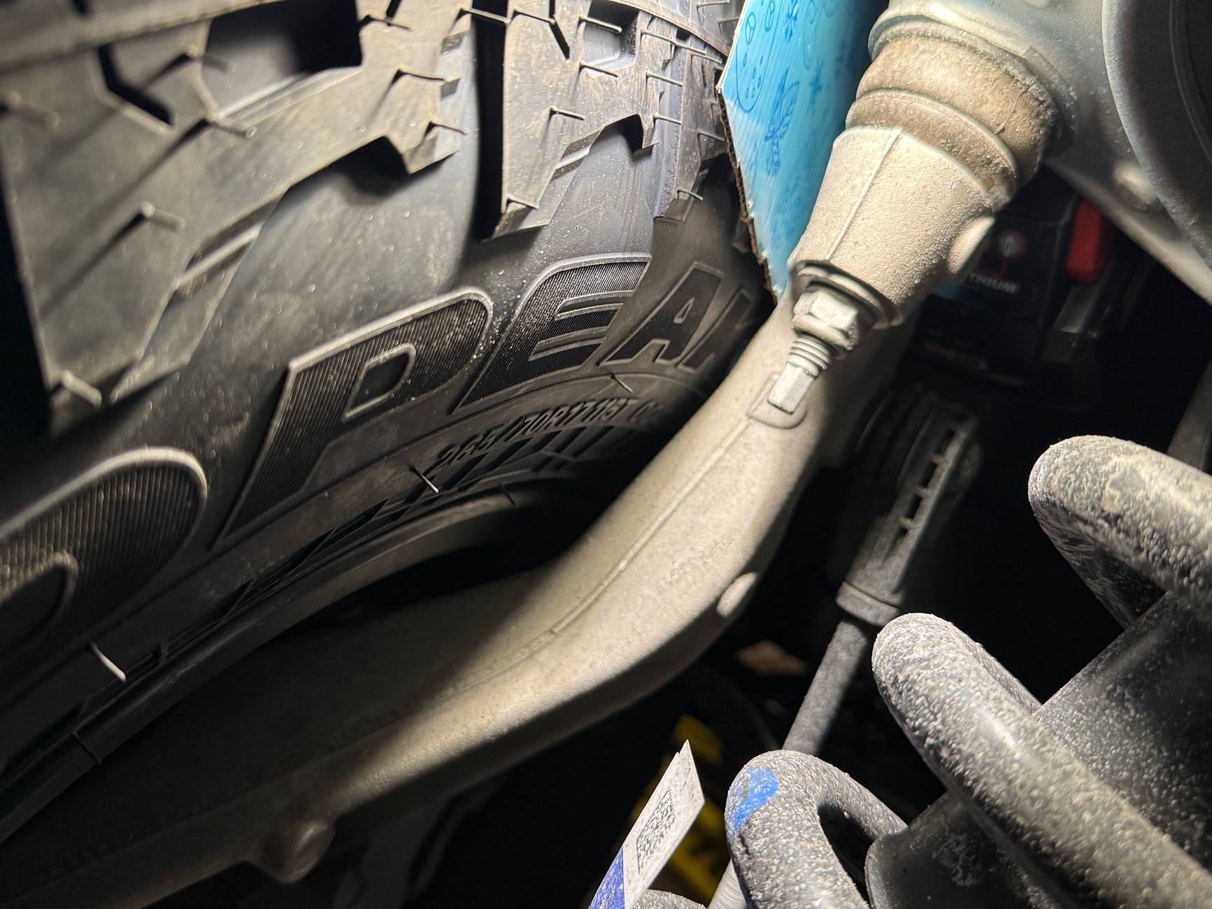

Got these wheels put on today. I transfered the Wrangler 255/70s over at Discount Tire for $90. Here is the clearance between the knuckle and tire. As expected, the section width increased from the wheel size change. Looks like about half the distance I used to have. You feel the extra inch on the wheels and how it affects the tire.

That tire is 6/10s of an inch narrower than the one 265/70 that Ford advertises online. Guessing yours has about a 1/4” gap would explain the difference.
wonder what size tire the other guy in this thread has? Still waiting on his rim offset as well
The more I researched tire sizes, it does appear that tires are a lot like clothes - one manufacturer's 32 pants are not necessarily the same as another. I also read in an interview with someone at Yokohama that production sizes can vary a typical 3% and at the extreme of up to 7%. I think most tire sites have disclaimers alluding to these variances and since the clearance is so tight when using these wheels, a couple of percent can be the difference in fitting.
Having said that, I think jumping up to 265s on these wheels is a crap shoot between manufacturers where some might even be close using a stock 8" wheel. I was expecting about a 4—5mm total change going from the 7.5" to 8.5" with the Wranglers.

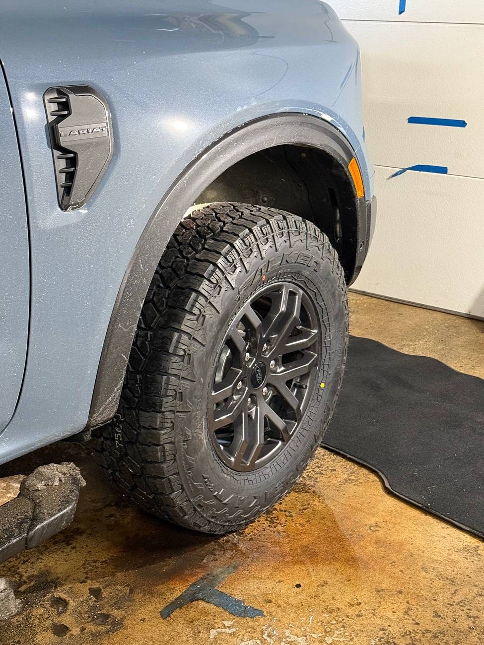

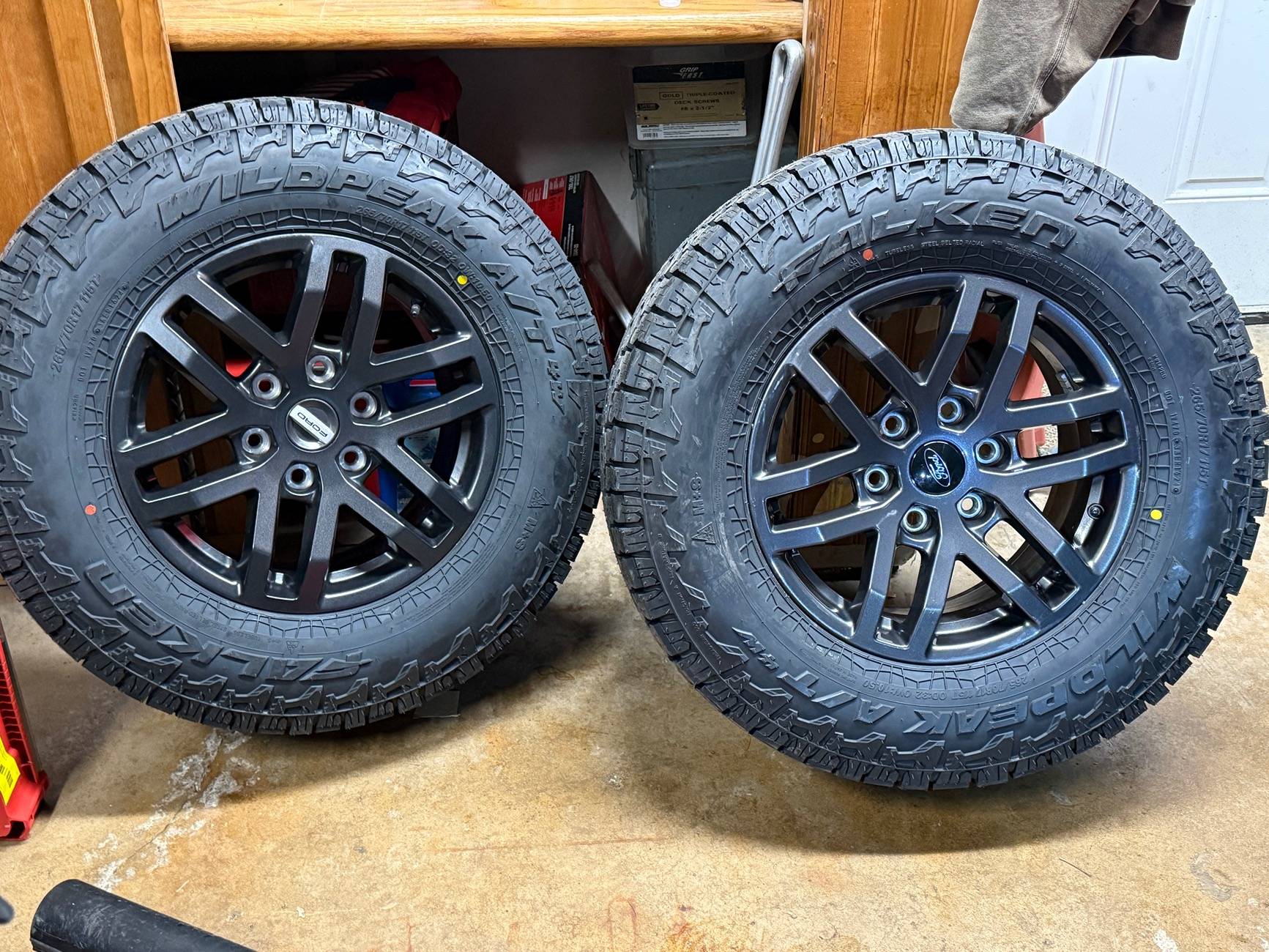

Was able to test fit the ford performance vs stock ford oem.
The Ford performance 55mm rubs and can’t even force 1/16” cardboard through it.
The Ford stock oem 42mm has ~3/4” clearance between the knuckle and tire and pushes tire to the edge without poke. I have more photos for Ford engineers as they are trying to figure out why they don’t fit

I’m partial color blind but ford performance and tremor rims look the same color ???
Here’s one of each side by side
