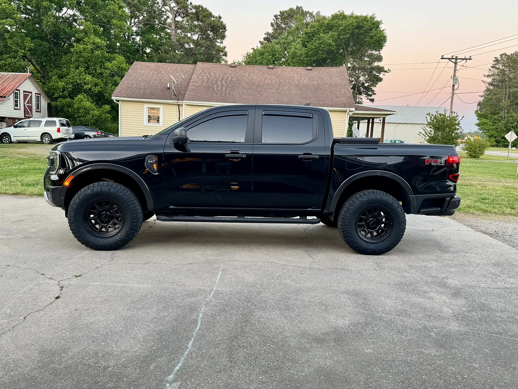

Hmmm, running smaller tires than stock 285s on 18” wheels? 🤔
Nope, I’m running larger wheels and tires than what came on my truck. My truck came on 17” wheels and 255/50/17 Tires.

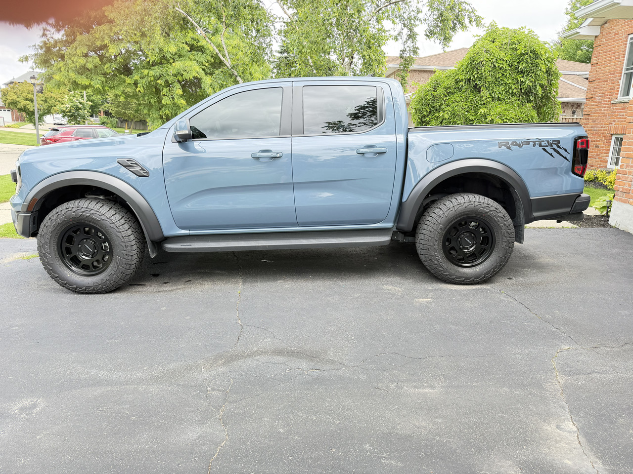

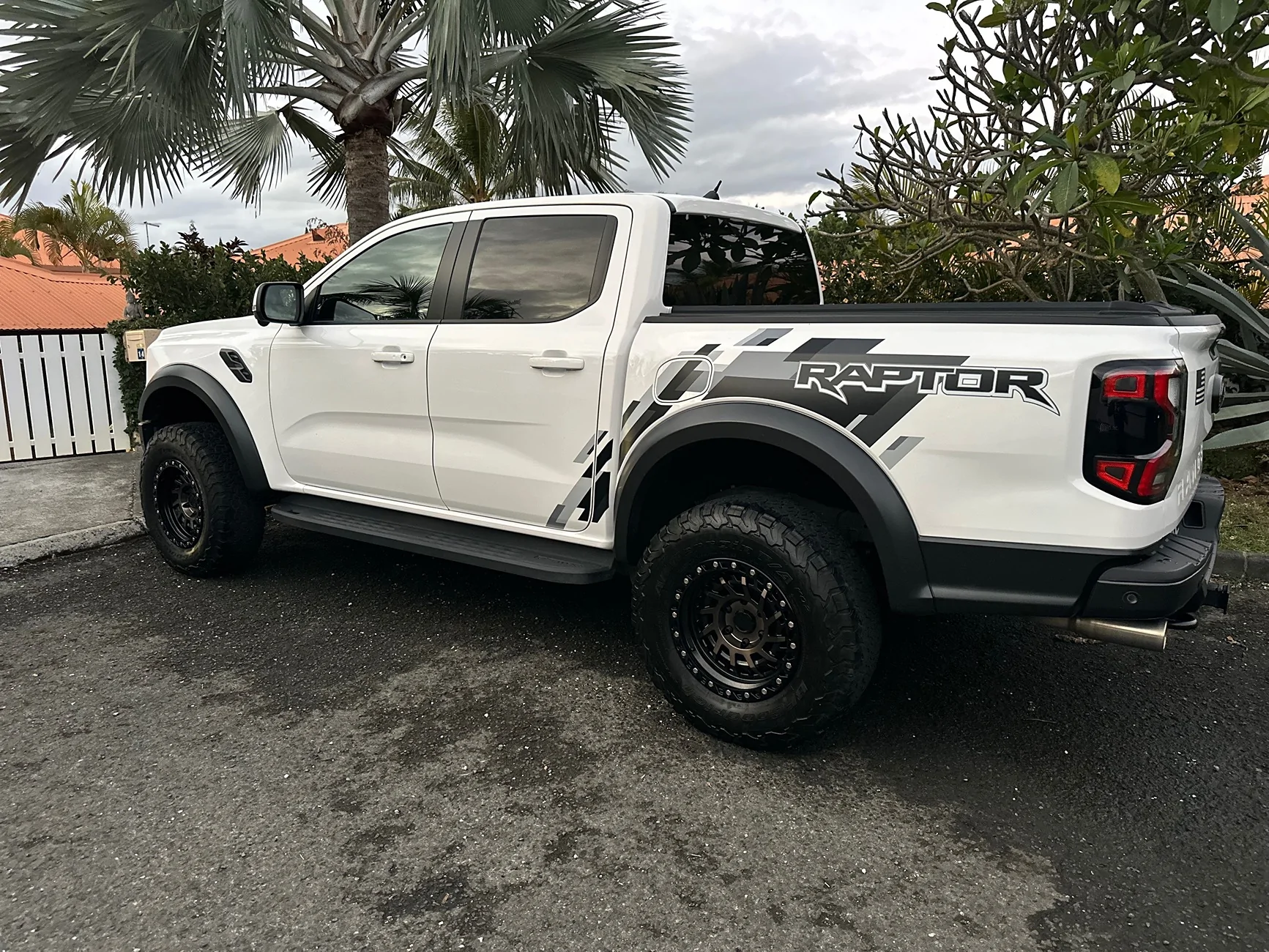

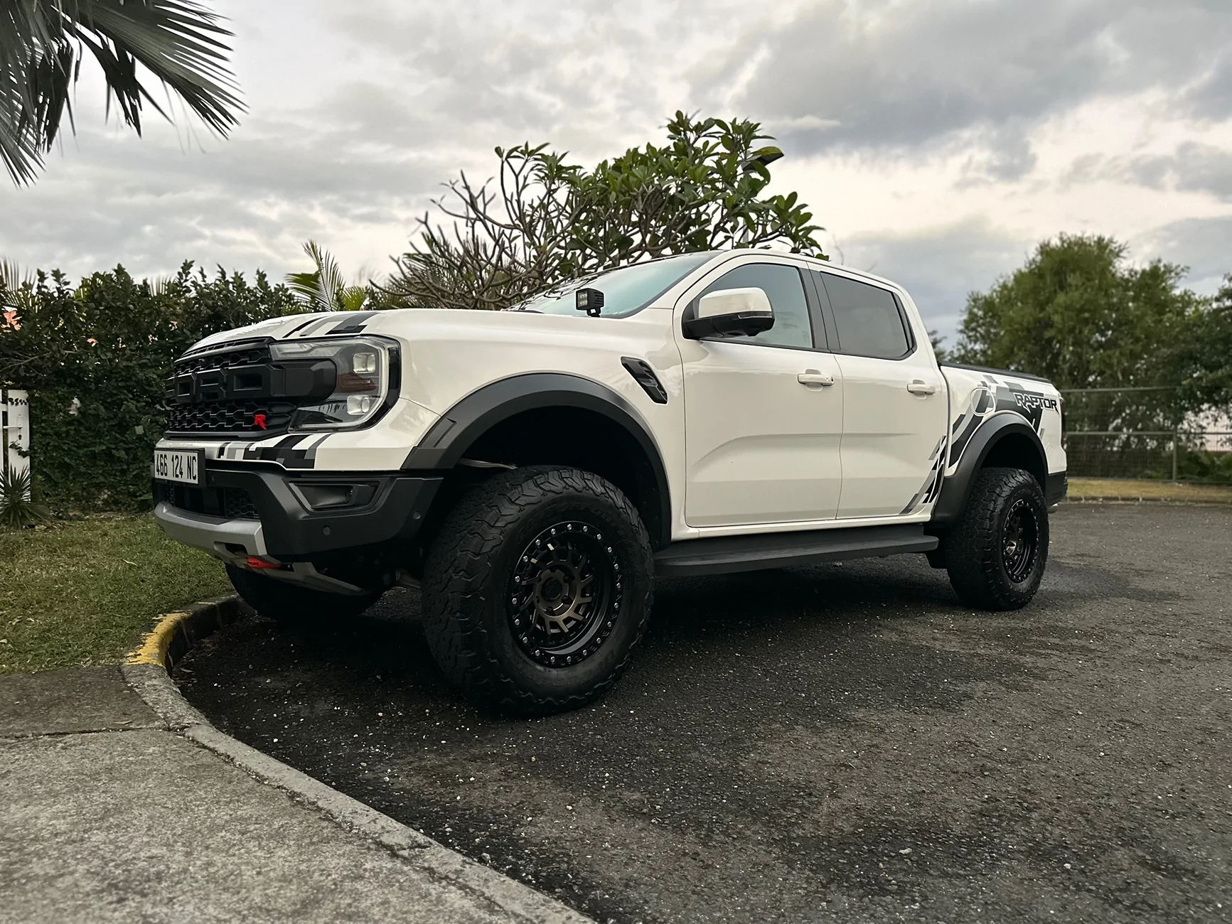

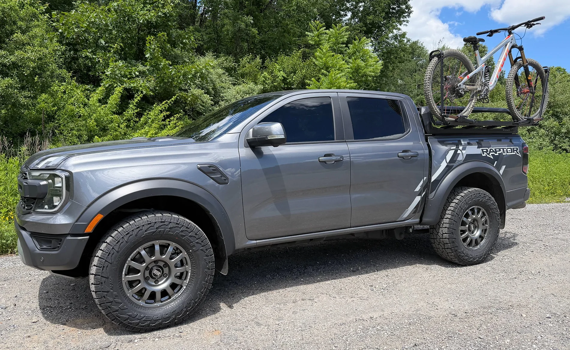

Before the 34" BFG's were installed.
Ford Ranger Aftermarket Wheels / Rims - Let's see what you got Raptor in woods

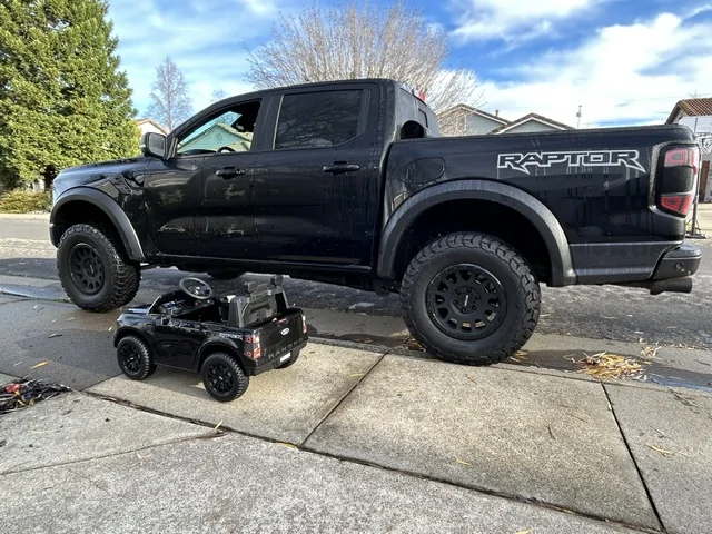

Ford Ranger Aftermarket Wheels / Rims - Let's see what you got Raptor and Mini

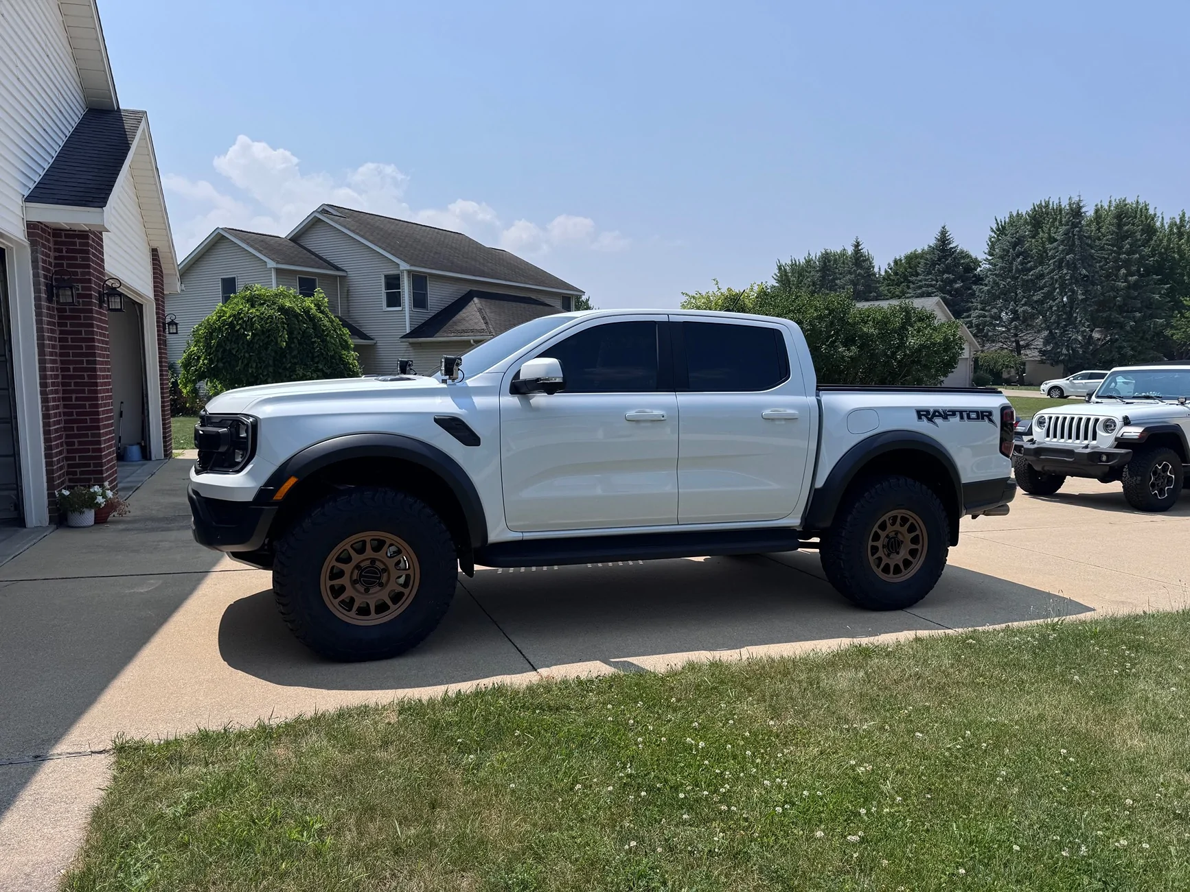

Those were my second pick over the Medot 705s, but for my needs I was willing to trade a couple lbs for bead grip capability and I didnt want to go past ET35 offset although ET30 is still within the stock range Ford uses on the Broncos which share a lot of chassis parts with the Rangers.
I really like that Bronze / Blue combo!
