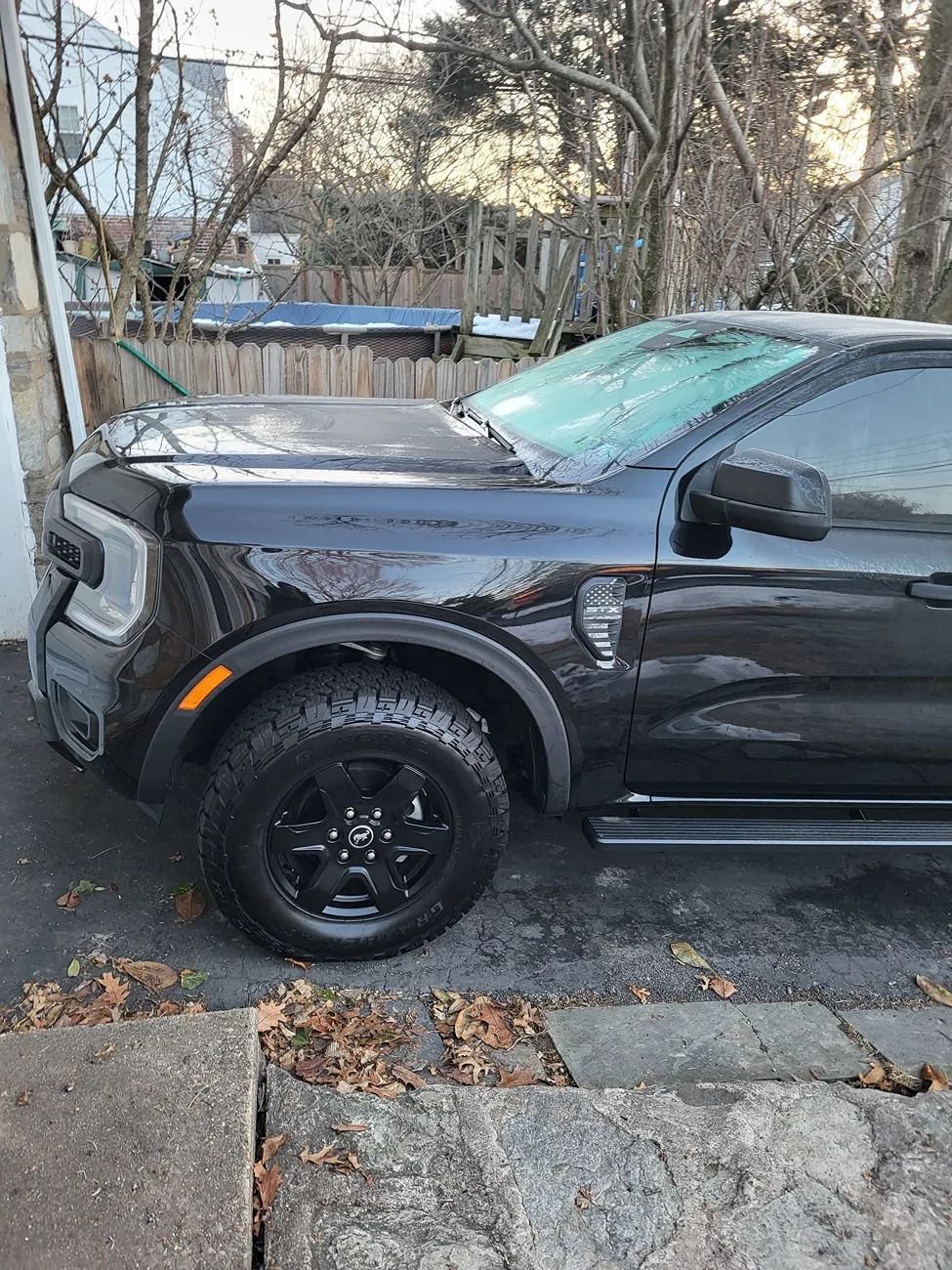

I picked up Bronco (Black Diamond) rims and General Grabber tires
Ford Ranger Aftermarket Wheels / Rims - Let's see what you got 20260228_065503
Ford Ranger Aftermarket Wheels / Rims - Let's see what you got 20260228_065448
off of market place for $500.
Ford Ranger Aftermarket Wheels / Rims - Let's see what you got 20260228_065450
Ford Ranger Aftermarket Wheels / Rims - Let's see what you got 20260228_065455

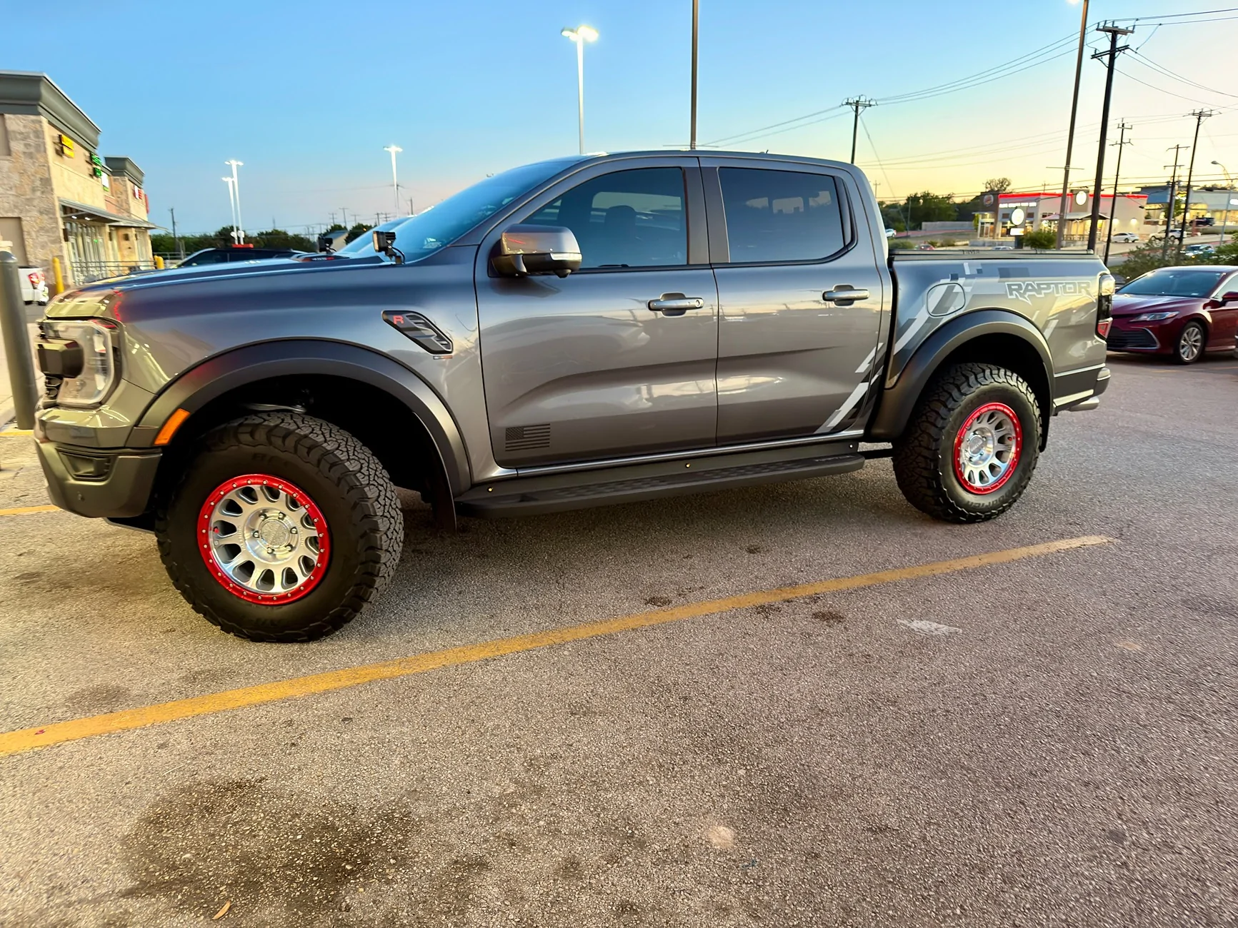

Method 705's on my SGM Raptor. Factory off-set ranges for the Bronco's is anywhere from ET+55 up to ET+30 mm. Since the Ranger and Bronco share chassis, driveline and powertrain components, I think that range is the "ideal" safe working range where you're not messing up your scrub radius, inducing massive clearance issues or killing your bearings with excessive side loading.
These 705's are 17x8.5 ET+35mm. Stock is 17x8.5 ET+55mm. My 705's are just 25.2lbs per wheel, stock alloy's for the Raptor are 29lbs per wheel and stock bead locks are a whopping 36~37lbs per wheel (what my Raptor came with).
I personally think the rounded trapezoidal cutouts for the spokes go well with the boxy body style and it's rounded corners. The 2nd gen Ranger (2024 to present) has a more modern squared off stance than the rounded 90's style of the 1st gen Ranger (2019 to 2023).
They come in Titanium Grey, which is what I got, or matt black. Although on a XL, XLT or Lariat you will get some wheel poke due to the off-set unless you add fender flares.
