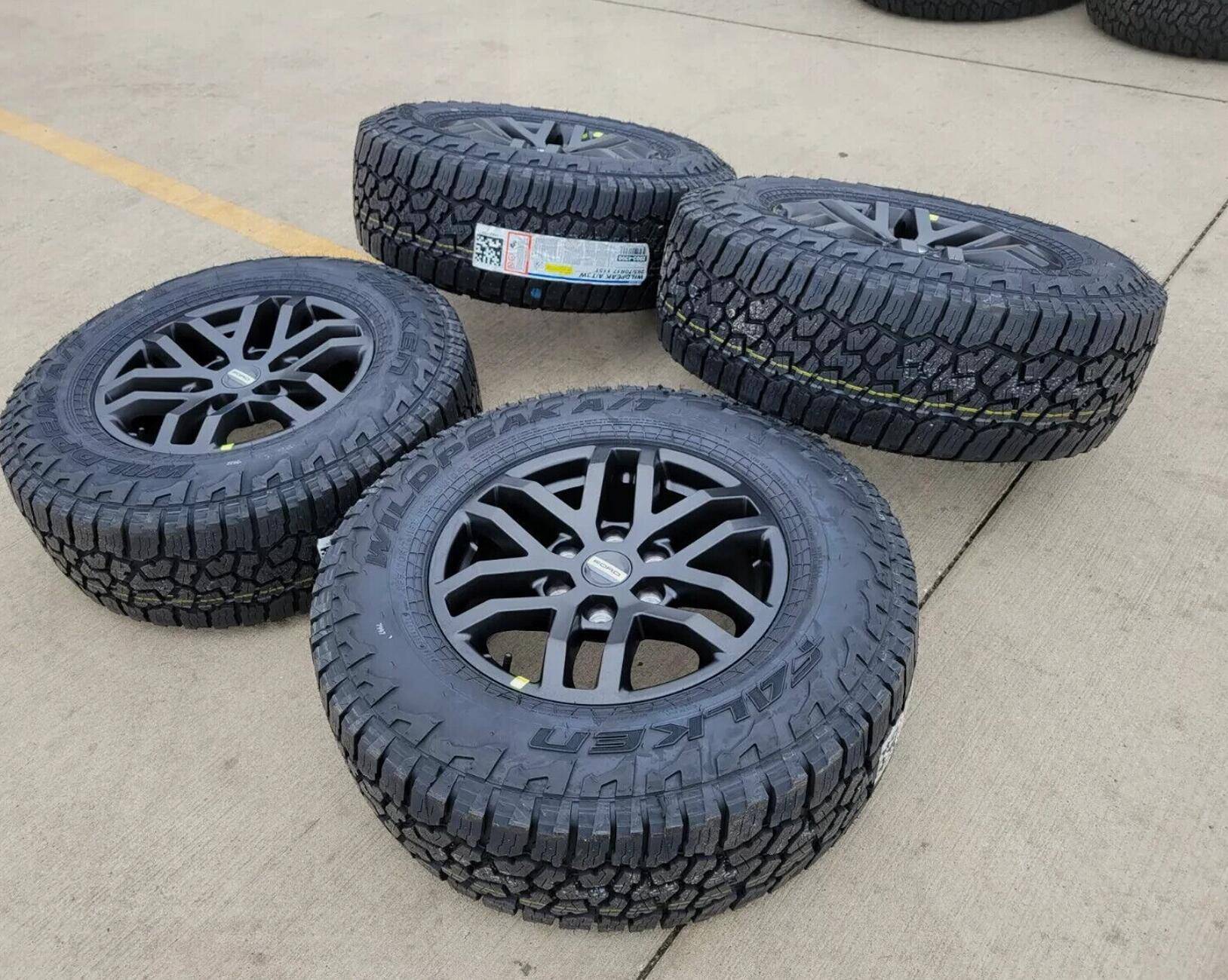

I believe tire sizes can vary between manufacturers. The Falkens look bigger than the Mickey Thompsons and according to Tire Racks listed specs, they are 1/2“ inch bigger in section width despite both being 265/70s. The BFG K02 are showing the same size as the Mickey Thompson. I think that is where the difference is... at least I hope so because I ordered these wheels too.
I went to Falken and BF kO3 web sites and both width are 10.7”

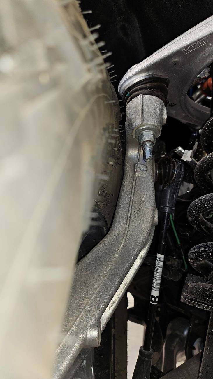

Measuring stock rims last night with a true 1/2” stock of oak had no wiggle room between the knuckle and tire. That said this rim is same offset only 1”wider = 1/2” each side that means any tire stock size of 10.1 or wider will rub
Anyone here use a wheel spacer?

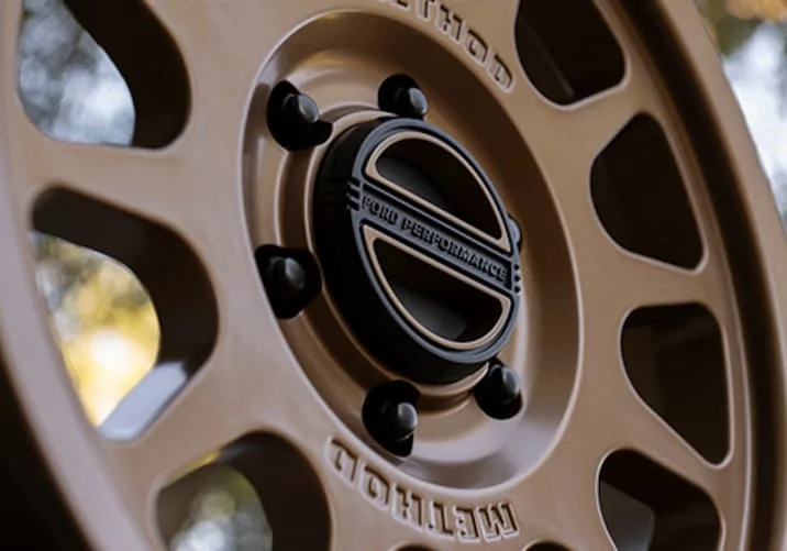

I hope this isn’t too egregious of a thread hijack, but I looked through all the wheel options in the OP’s link and saw a set of Method wheels. Does anyone know where to get a center cap like the ones in ford’s catalog have? They say “ford performance” but I’d be happy with a ford logo, or just “ford”. The Method center caps seem kind of big and I haven’t found any aftermarket center caps and all Method seems to have are original replacements that say “method”.

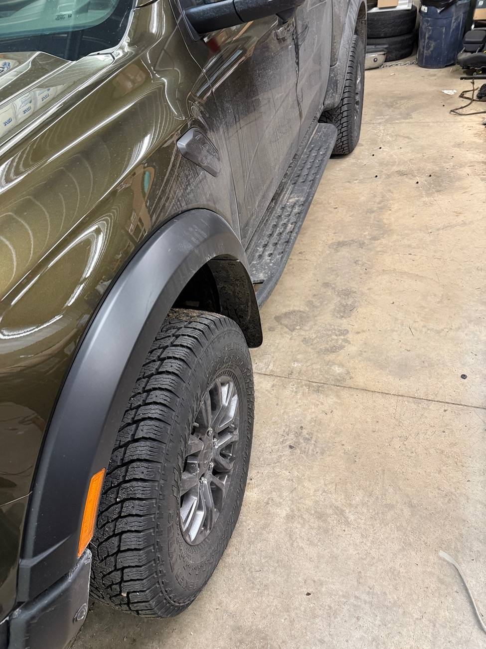

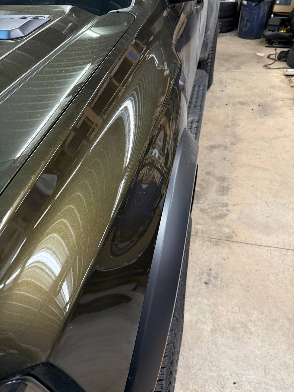

Here is my raptor with the spacers and my winter tires. 285/70r17’s on stock 5g ranger 17x8 +55 wheels.

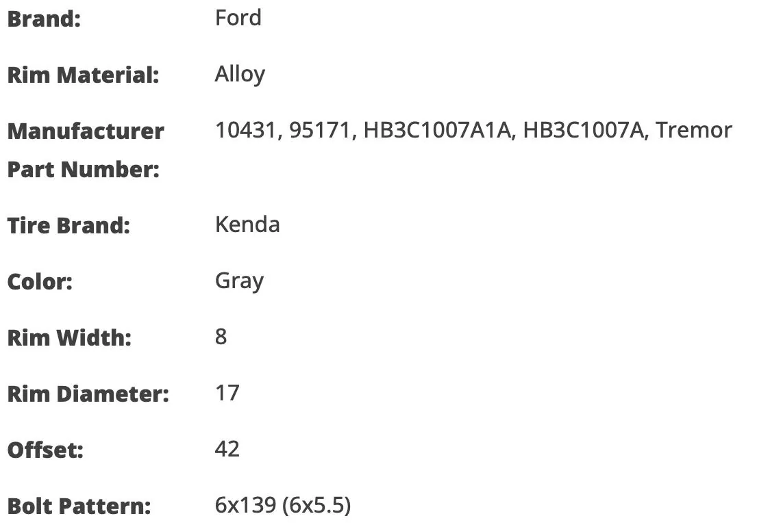

So I found pretty much the same ford oem rim, different spec that should work if I did the math right, lol
17x8" 42mm offset vs my stock 18x7.5" 55mm
That gives me 1/4" more clearance inboard vs my stock lariat rims = 1/2" space between the new tire and kick the whole tire out 3/4"
Cost more than post #1 in this thread but I like the look. Should get them in another week or so. Now waiting on ford performance to own up on the advertising mistake that's costing me time and money.
Ford Ranger Ford performance rims Screenshot 2025-01-03 at 5.35.30 PM
Here's ford part number if anyone wants to find any.

A disclaimer is I only know my stock lariat have 1/2” space between the knuckle and tire.
The performance rims in post 1 are 1” wider and that puts the tire right on my knuckle. This rim is 42mm that pushes everything out.
