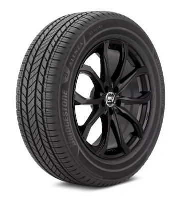

I just purchased a 2025 Lariat and was looking at getting the 17" x 8.5" Dyno Gray wheels. If I stay with the factory size 255/70 tires will clearance be ok? My Ranger will be a bit of a highway queen and used for towing a boat a few times a year from NJ to FL and back, so I was looking at getting more of a touring highway tire that's good in the rain and move away from AT tires. Something like the Bridgestone Alenza AS Ultra's. The spec's on this tire are: 255/70/17, Rim Width Range: 6.5-8.5", Meas. Rim Width: 8", Sect. Width: 10.2", Tread Width: 7.6" Overall Diam.: 31.1"
