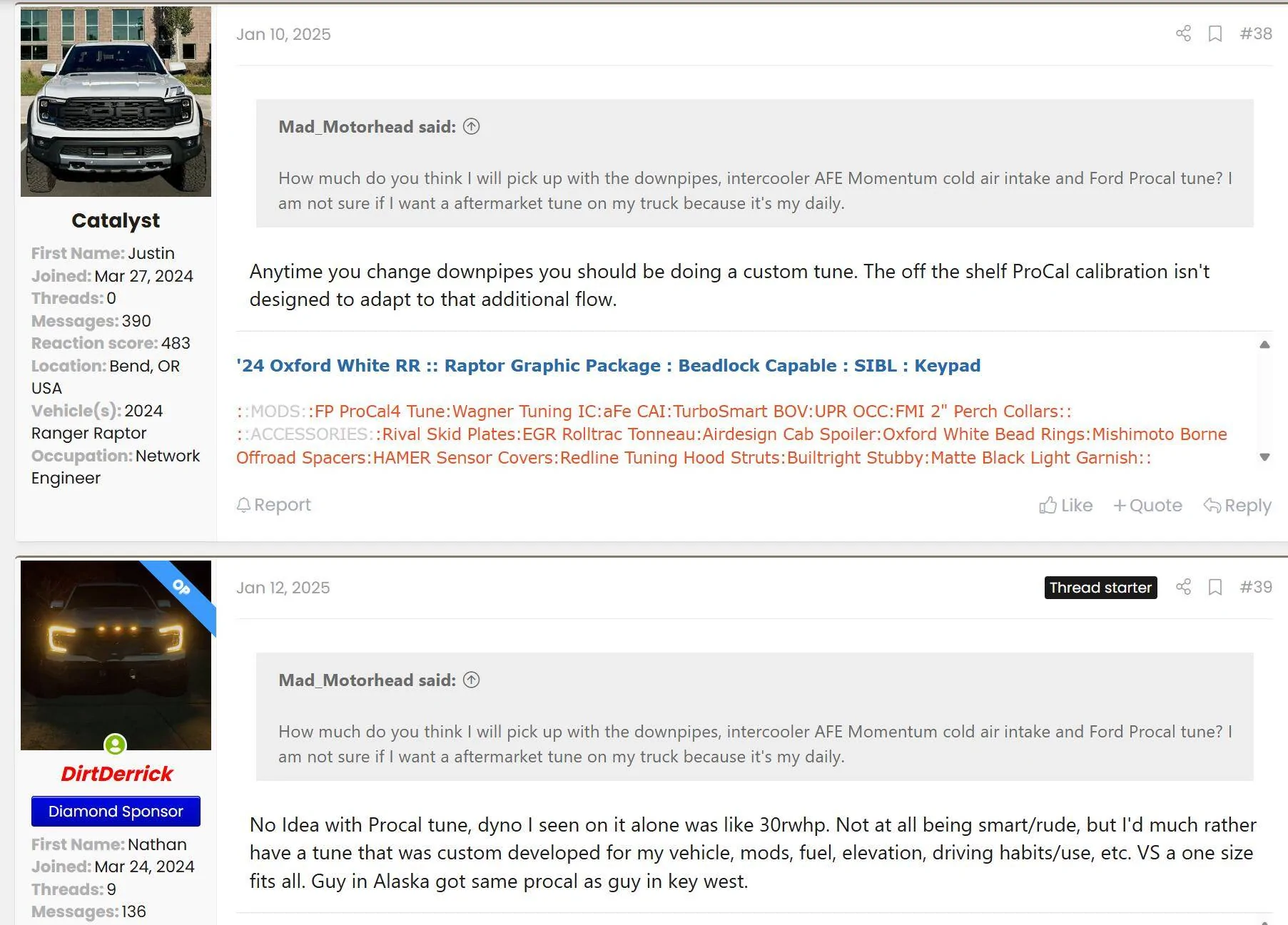

I just got a Ranger Raptor and I want to get the Ford tune. My question relates to what happens when you add other parts that would theoretically add power with the Ford tune?
For example, adding an intercooler, down pipes, etc. adds more power and a tune is needed to get the highest gains. However, with the Ford tune, it is a canned tune. So, if you can't adjust the tune at all, what power gains could you really expect from the other bolt ons? Would they be worth it, or would you just be getting the same gains as if you just had a stock tune?
I am not too keen on buying another ECU (and it needs to be a new one to retain the exhaust mode functionality) for $$$$ with a tune from ZFG for example.

I installed the FordPro cal on my 2025 Ranger Raptor.
That engine and electronics have immensely more capacity maintain optimal airtime fuel ratios than older systems.
With the gages of the ProCal tune you can monitor air/fuel and graph it.
My opinion is the existing systems will easily adjust for other mods.
If you exceed the capacity of the stock injectors bu putting too much air in the engine that's where a lean condition can destroy the engine.

I believe that it’s already been said, but I will reiterate, buy parts based on the specific needs / expectations of your vehicle. I have a 24 RR, and I wanted a little more performance, so I had the FP tune installed. The next limitation to be addressed was the stock intercooler. The factory unit is a small IC with plastic end caps, that is subject to heat soak with higher ambient temperatures, or hard driving. Since high IAT = less power, I swapped out the factory intercooler for the COBB unit. The next thing to address was airflow, so I purchased an AFE intake. There were several really nice aluminum models available before AFE released their intake, but then you’re dealing with the heat soak of your intake. I’m probably going to stop there, because any additional modifications that would add substantial HP would require a custom tune to maximize those benefits. This vehicle is my daily, so the first priority is reliability, and I know from experience that custom tunes are often more trouble than they’re worth.
This mirrors what I've done, and where I will stop for the same reasons; just waiting for my aFe intake to ship :)
