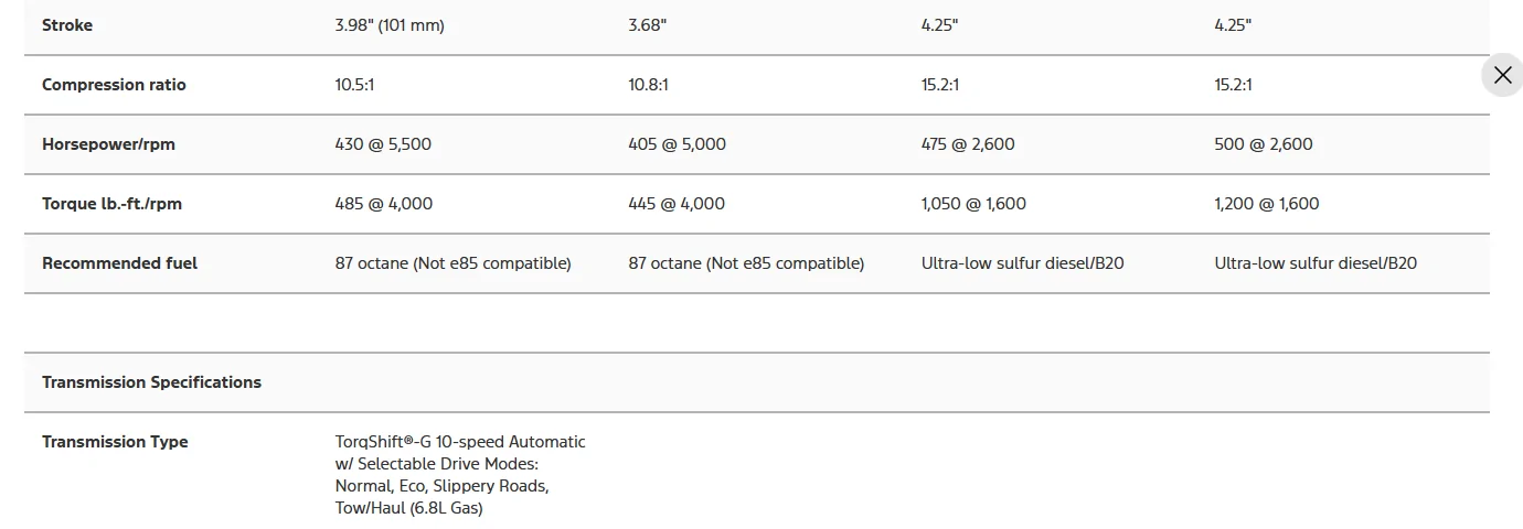

By the way, this makes even LESS sense now that the 2025 is out:
2025 Ford Super Duty® Truck | Pricing, Photos, Specs & More | Ford.com
1,200 lb-ft of torque from the 6.7L PowerStroke for 2026.
Horsepower (SAE net @rpm)
6.8L 2V DEVCT NA PFI V8 Gas engine (horsepower = 405 @ 5,000 rpm)
7.3L 2V DEVCT NA PFI Gas engine (horsepower = 430 @ 5,500 rpm)
6.7L 4V OHV Power Stroke® V8 Turbo Diesel B20 engine (horsepower = 475 @ 2,600 rpm)
6.7L High Output Power Stroke® V8 Turbo Diesel B20 engine (horsepower = 500 @ 2,600 rpm)
Torque (lb-ft @rpm)
6.8L 2V DEVCT NA PFI V8 Gas engine (torque = 445 @ 4,000 rpm)
7.3L 2V DEVCT NA PFI Gas engine (torque = 485 @ 4,000 rpm)
6.7L Power Stroke® V8 Turbo Diesel B20 engine (torque = 1,050 @ 1,600 rpm)
6.7L High Output Power Stroke® V8 Turbo Diesel B20 engine (torque = 1,200 @ 1,600 rpm)
So, if it's in NM, then Ford is making factory heavy diesel trucks where the engine's output torque now exceeds the transmission max torque by 168 lb-ft....that argument is STUPID. SO supposedly, the 6.7L HO exceeds the 10R140's input torque by a whopping 14%!!! That's the opposite of a safety margine...
At best, it's a lb-ft rating. Most likely it has NOTHING to do with input torque ratings and is dimensional. All versions of the F-350 use the same 10R140 (but how knows how it differs internally from model to model for each application):

I think we can throw the internet claims of nm out the window at this point. At best it's lb-ft, most likely it's not related to torque at all. And for the love don't rely on wikipedia, if you look at their sources, most of it is car magazines who rely on assumptions, many of which are incorrect.
For reference, 1,400 nm = 1,032 lb-ft.

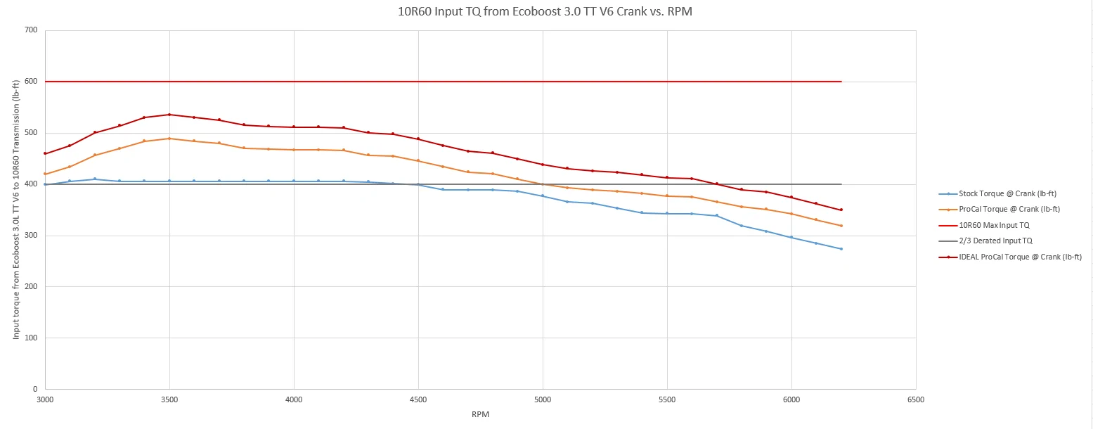

Just out of sheer morbid curiosity, I imported the data from Steeda's dyno, so it's one of the few comparison points we have of before and after on the same truck under relatively similar conditions, same dyno etc.
Note that they are in Florida, so it is very hot and humid and any engine is NOT going to make maximum potential power like on a 60F cool dry fall night at the drag strip, but I do think it's representative of "average summer conditions" across many of the states (including my own state).
IF your concerned about transmission durability, making less the max power is actually better for 10R60 longevity and we know the Pro Cal has OE-like testing and tuning, so it is going to always operate within the safe region for given conditions, meaning that 90% of the time you're NOT making MAX potential power, but rather some percentage of that (like 85~90% of what it can make under ideal weather).
Yes, I did include the POSSIBLE meaning of the "60" in the 10R60 naming as a 600 lb-ft input torque spec just as a reference point, even though it is unlikely to actually mean that.
Ford Ranger Couple simple Ford Performance Tune questions 1754571736584-s1
BLUE line is Stock
ORANGE line is ProCal after the 1 week learn
DARK RED line is an extrapolation from the real data of the approximate "ideal" max it would make with the Pro Cal after the "learn" period
The STRAIGHT RED line is the hypothetical 600 lb-ft input torque that the 10R60 supposedly is rated for (MAX)
The STRAIGHT GREY line is 2/3 derating on the input spec (high reliability range)
Notes: at WOT, the PCM is going to shift between 6,000 and 6,200 RPM (up to red-line), so the torque input worst case at the next gear is going to be around 5,000 RPM. Even with the Pro Cal, when doing WOT pulls, the input torque to the 10R60 is still BELOW the 2/3 derated high reliability range!
I cannot think of a case where your WOT making MAX torque and shift at 4,500 RPM so your starting torque in the next gear up is at peak torque (aka 3,500 RPM). You're NOT making anywhere near max torque at partial throttle, where it may sometimes shift around 4~4.5k RPM (aka light throttle), typical driving conditions.
Maybe if you manually shift it (force it), but the PCM likely has torque limiting strategies, aka it will torque limit momentarily until the lockup occurs, then de-limit.

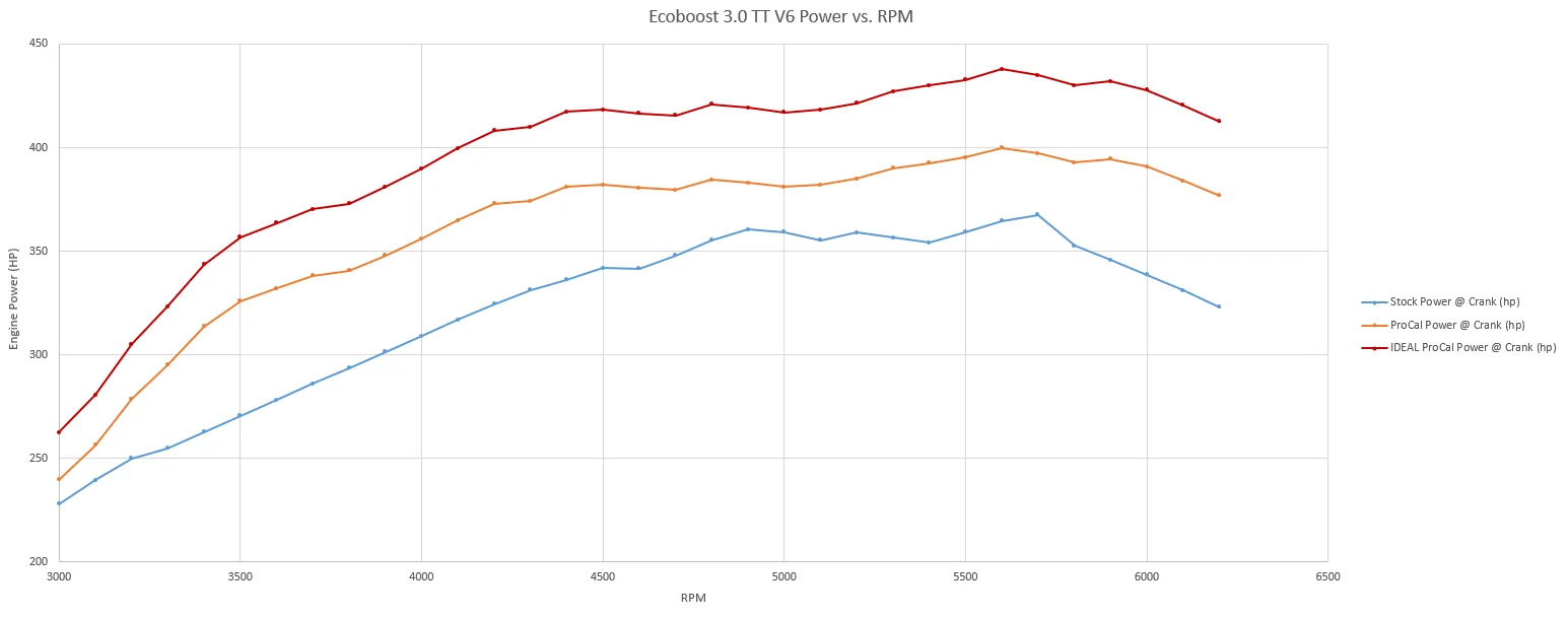

These are the calculated HP numbers from Steeda's actual dyno numbers imported into excel, except the dark red line, which again is a hypothetical extrapolation from the real world numbers of a "theoretical MAX" based on Ford Performance specs.
Now you know why the shift strategy at WOT and especially in Sport or Baja tries to keep the EB V6 in the 5,000 to 6,000 RPM range, that's where max power is and it's VERY linear since the torque roll-off slope is rather shallow (aka it holds torque decently well as RPM increases).
Power is work being done, power is generated by pulses of torque like a PWM (Pulse Width Modulation). The average of the pulses (duty cycle and frequency) is what makes power. When people say you "need torque for towing", what they really mean is "you need power down in the lower RPM range" where you normally don't have it with NA engines.
Below 3k RPM, Stock and Pro-Cal are identical, there's no difference in power / torque below 3k, so I did not bother to include that.

Looks that chart is from a Raptor. Any difference in the 10R60 in a Raptor vs standard Ranger?
