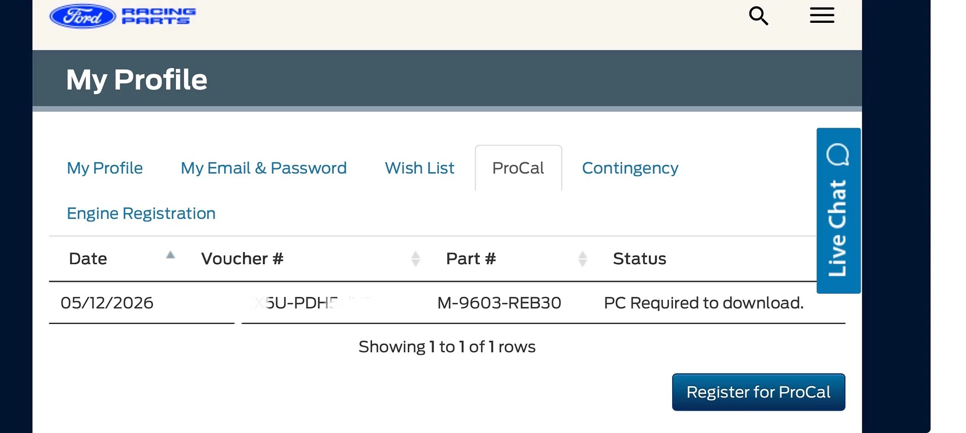

Yesterday I went to my Ford dealership and had my ProCal tune installed. When I log into my profile, the status says “PC required to download.” I’m curious if they might have missed something, since it’s still too soon to tell if it was actually installed because it has only been a day. At least the ProCal device shows my VIN number on it.

You should feel a noticeable difference right away. The procal doesn't take time to 'learn' (Other than transmission).
Power should be there. If not I'd take it back
Mine says the same thing and even says the same thing for my Bronco 2.7L tune from a couple years ago.

You'll know immediately.
But the screen will look like that regardless. It just shows that the credit was used for your vehicle. You cal always hook the handheld up and check.

Just plug in your Pro Cal and let it connect. It should have FP in the line.
