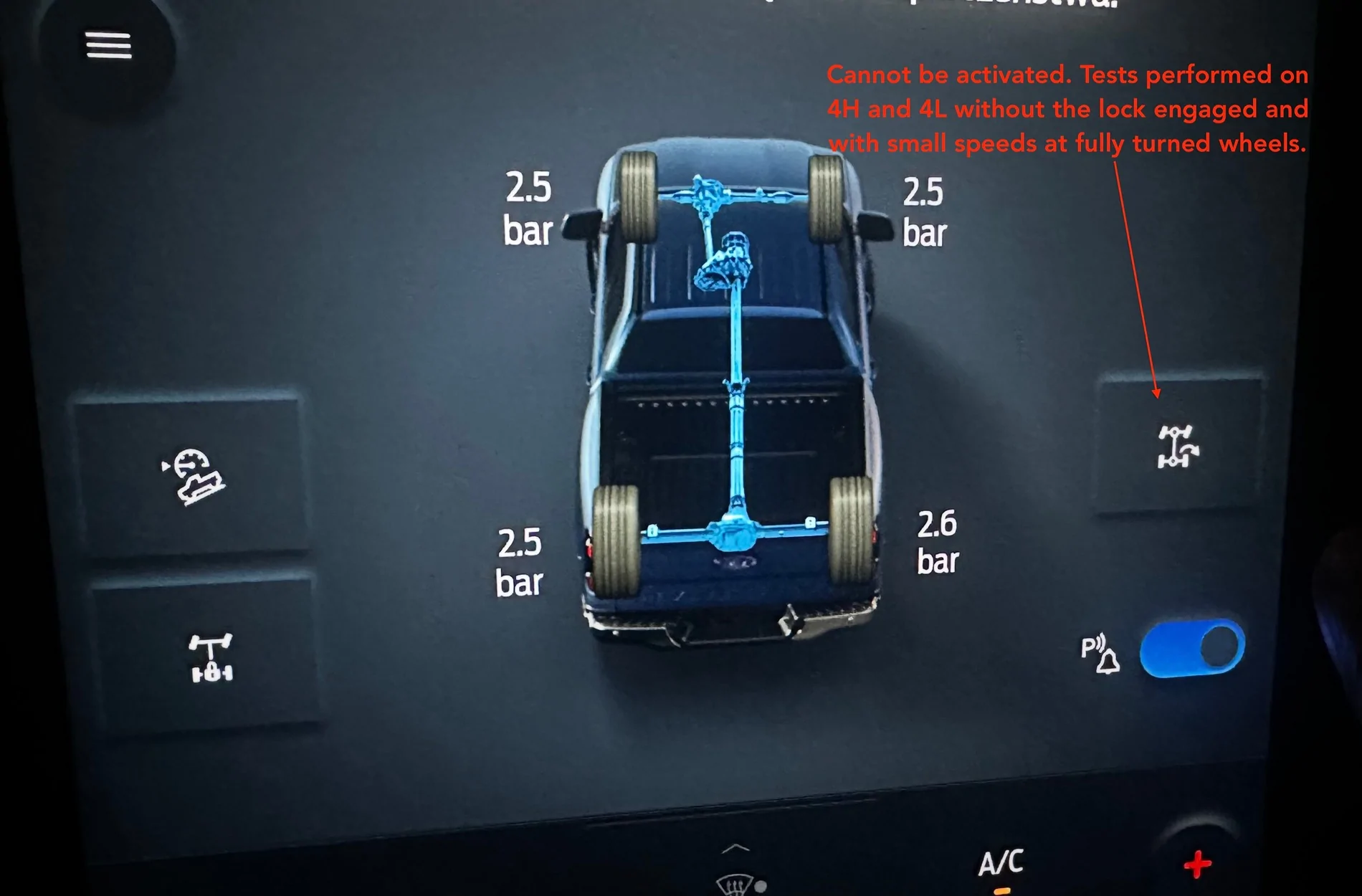

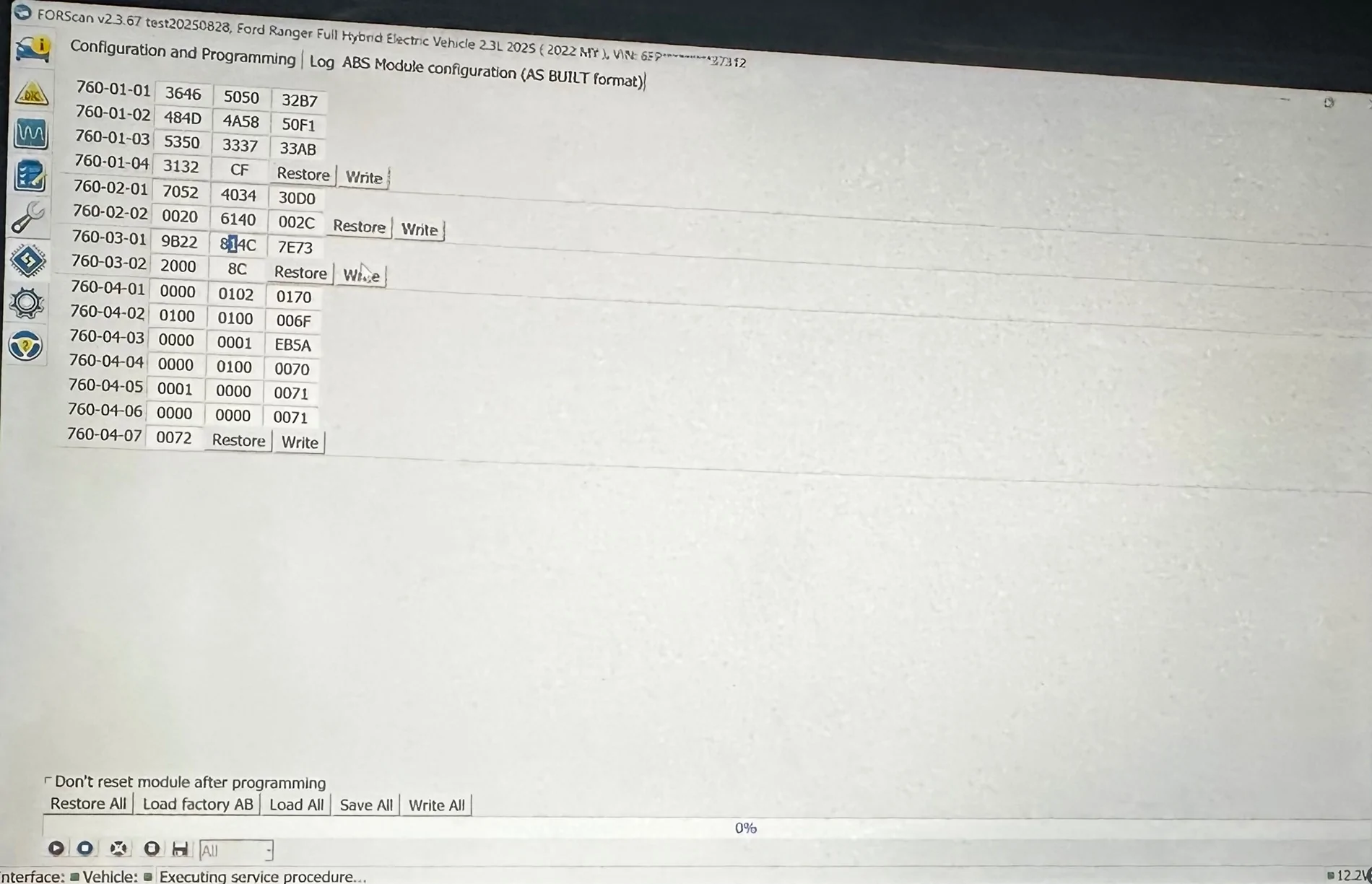

Trail Turn Assist shows in menu but won’t engage — ABS 760-03-01 P703M 2025 FHEV (marketed PHEV)]
• 2025 Ranger P703M, 2.3L I4 GTDI FHEV (sold as “PHEV”), 4WD full-time, A10R80-MHT-X
• FORScan test build 2.3.67.test20250828 (works and lets me write ABS)
What I did
• In APIM I enabled: Off-Road Menu – Trail Turn Assist and Trail Turn Assist.
• The TTA icon appears, but pressing it does nothing. No side arrows on the truck graphic.
Ask
Which first two hex of the middle block (760-03-01) should a 2025 P703M FHEV use so TTA actually arms?
I suspect my current “81” expects an IPC/Gen3 hard switch, but I’m triggering from APIM (soft) and maybe need APIM/ATCM and/or SDM Gen4.
ABS As-Built now
• 760-03-01: 9B22 814C 7E73
I try (change only those two hex; let checksum update):
Dxxx → 9B22 Dxxx 7E73
Fxxx → 9B22 Fxxx 7E73
• APIM + SDM Gen4 (soft): 86xx → 9B22 86xx 7E73
• ATCM + SDM Gen4 (hard): 8Dxx → 9B22 8Dxx 7E73
• APIM + SDM Gen3 (soft): 82xx → 9B22 82xx 7E73
Test conditions checked: low speed, 4H/4L, wheel turned, indicator set, no trailer/TBC conflicts, no DTCs.
Procedure each attempt: write → clear DTCs → SAS calibration → key cycle → test.
If anyone has a confirmed working value for 760-03-01 on a 2025 P703M FHEV/PHEV, I’d really appreciate it. I can attach screenshots / the .ab file if helpful.

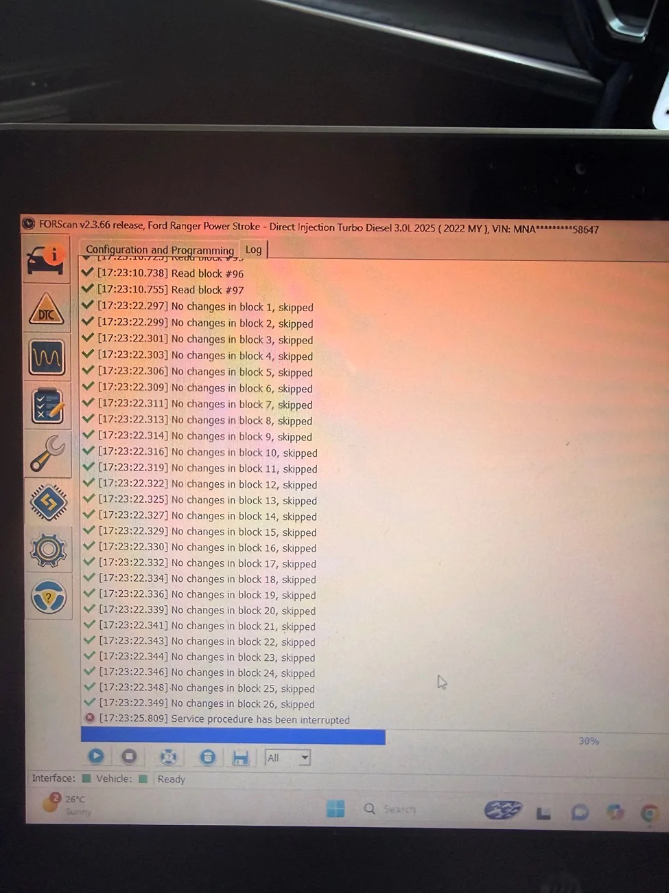

Hey iv recently upgraded my Ranger wildtrak to the 2025 Ranger platinum here in Aus but when writing files in FORScan to the bdycm it loads new changes to 30% then kicks me out of the module says service procedure interrupted and ideas why it’s only that module all others let me write no issues ?
Whenever it does that it means that change is not available on the platform.
Got the problem fixed forscan sent me a beta version and it worked

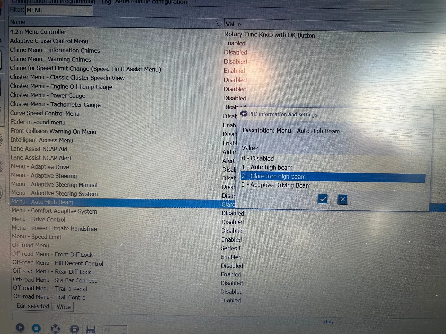

Have been looking at the lighting options on my 2024 RR (IPC).
What are the differences between:
1) Auto High Beam
2) Glare Free High Beam (Current config.)
3) Adaptive Driving Beam
I’m aware of how the GF High Beam works, but how does that compare with Auto HB?
What is Adaptive Driving Beam?
Cheers.
1) Auto High Beam
Cheers.
Changing everything (in SCCM and IPC) over to ADB from GFHB seems to only make the white auto high beam symbol on the dash turn green and stops the blue high beam tell tale from illuminating. Other than that it doesn't do anything.
I don't know what flipping them AHB does as I wasn't interested enough to try that.
Other than these observed changes, nothing else changes and the headlights do the same "matrix" tricks as with GFHB.
Of course my observations are coming from the perspective of an Aus delivered car with all the matrix / GFHB enabled from the factory.
If you don't have this functionality out of the factory then these could well be very interesting settings for you.

Cheers for that.
Think I’ll just leave as is.
Do you have cornering lights and beams that adjust to follow the road ahead as determined by movements in the steering wheel.
Like yours, mine came with GFHB enabled.

Yes, I have all that and making those changes to ADB doesn't affect any of it.
And critically, the changes don't fix the issues around activation of the auxiliary circuits (aux 5 / 6 - upfitter switches - whatever you want to call them).
