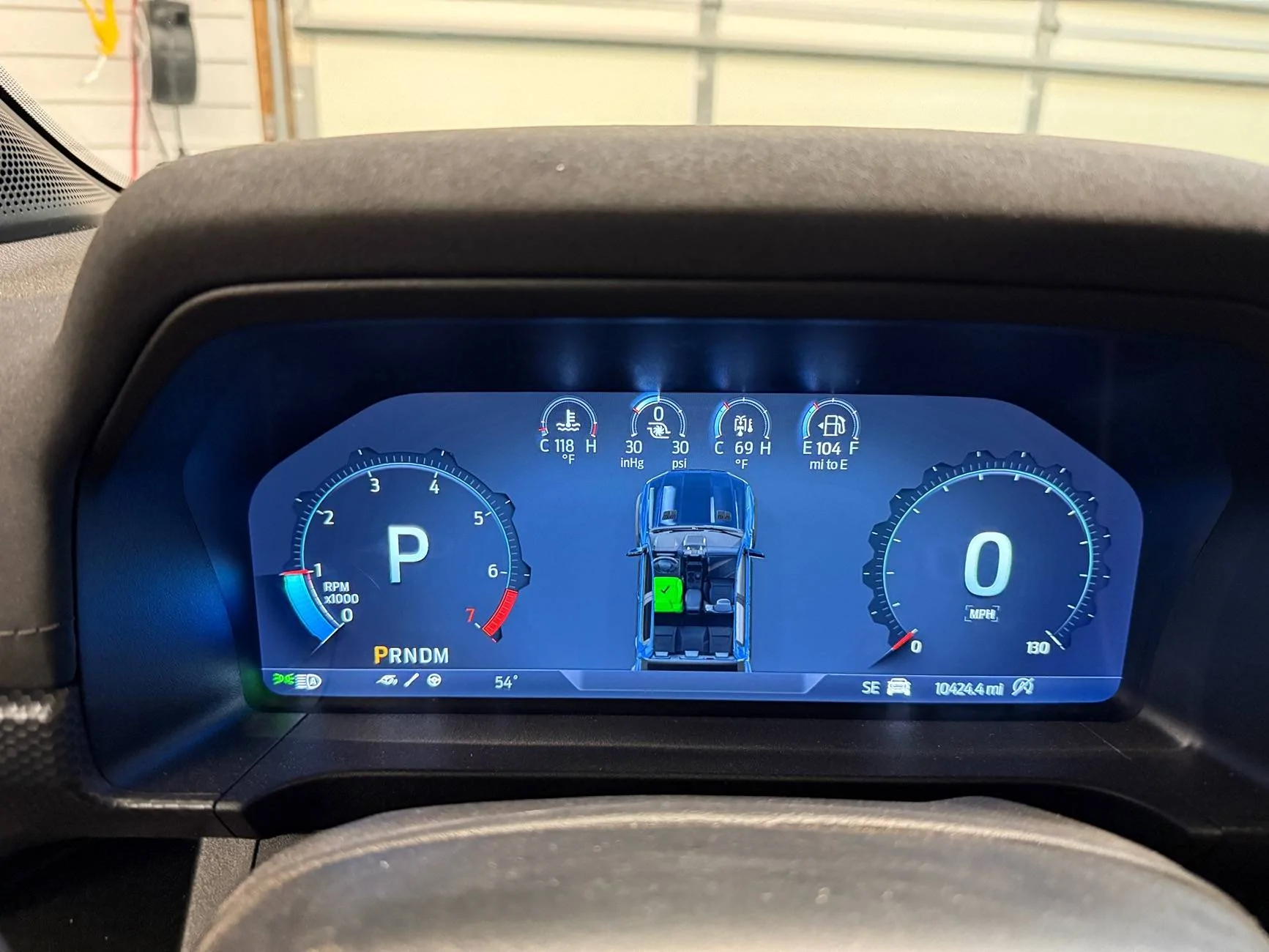

I’m not entirely sure what you want.
Here’s how mine works currently with the code ive shared.
With either front passenger unbuckled, the dash seat icon lights up:

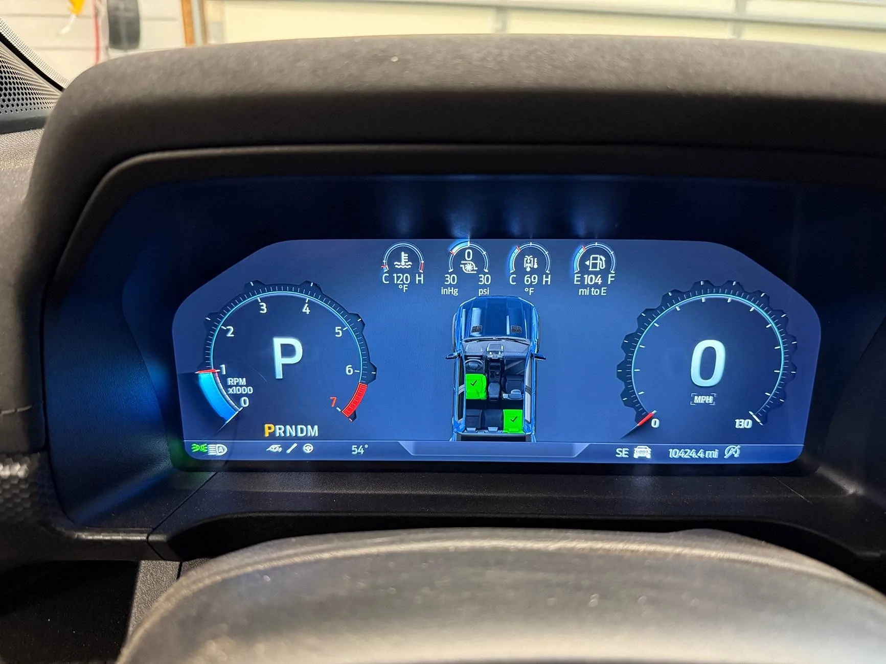

However, i just found out a rear seat passenger will not trigger the unbuckled warning.
I switched the my view over to seatbelts, and it does not know there’s a rear seat passenger.
However, when the rear passenger buckles up, it does show that:
Yes, the front seats light up red on the seatbelt screen with no passenger. I didn’t return the code to stock to test, but I’m not sure my truck detects rear passengers at all.
I don’t have kids, so not a concern for me. Best of luck figuring out a solution that works for you.
