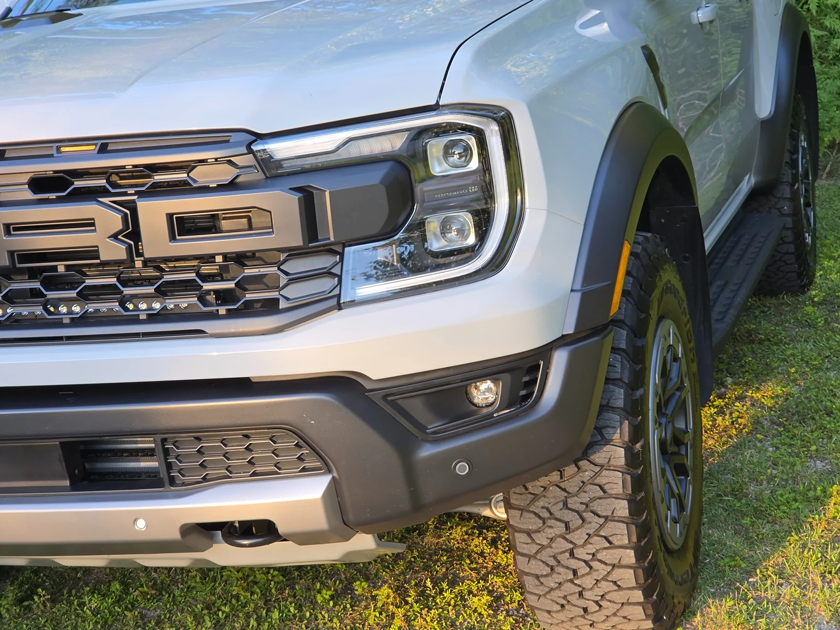

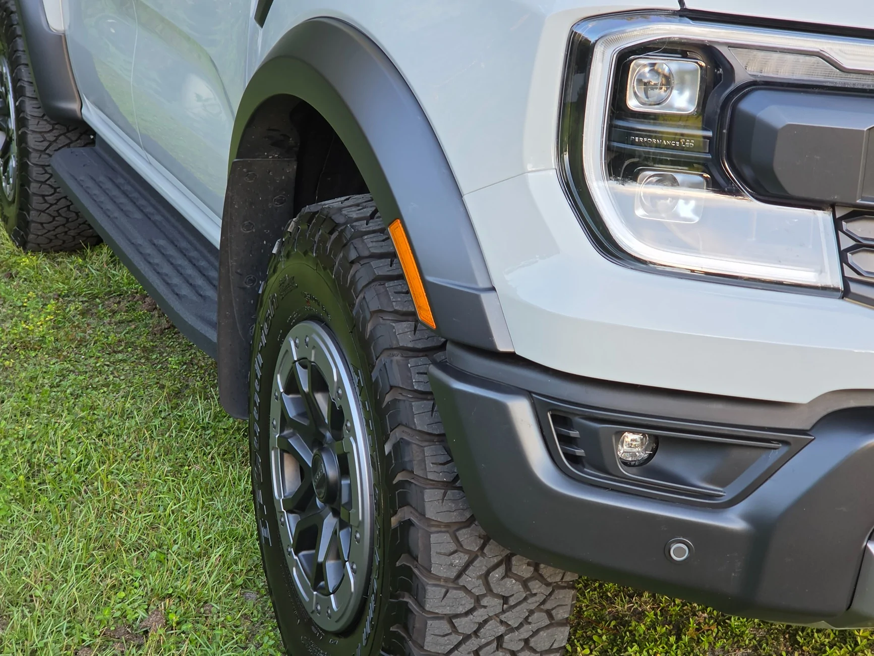

Anyone else find that their front bumper was lower by 2" on one side? I just realized today while washing my truck that the passenger side sits about 2" lower than the driver side. Guess I'll make a trip to the dealer. Look at the gap between the fender flair and the bumper.

My panel gaps aren't even, but that is ridiculously bad :rolleyes:

Oh my god that is bad lol. I am sorry, should be easily corrected by the dealer though.

Made an appointment this morning, I was going to do it myself and after trying to break the bolts loose with my impact I figured let the dealer deal with it lol

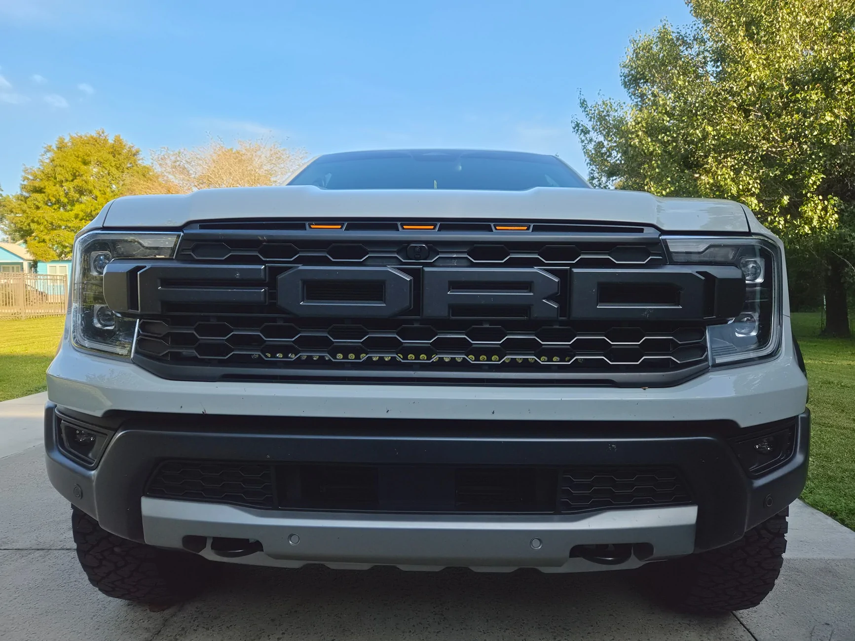

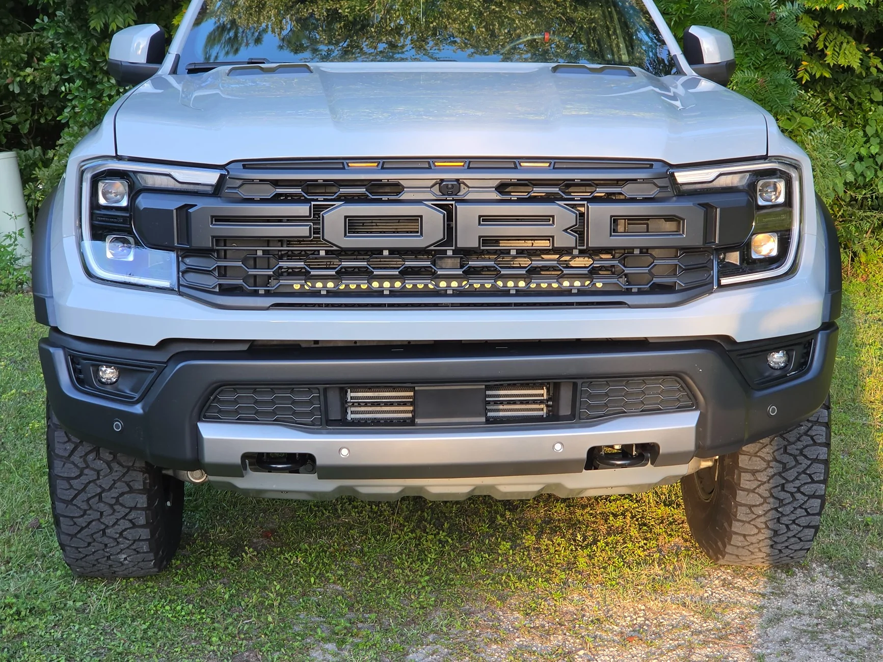

Local Ford dealership said they do not do body work and would have to send it off to be aligned. Said roughly 3 week turnaround so I went ahead and aligned it myself. Got it within roughly 3/8" from 1" 7/8 side to side and then left well enough alone. Big difference lol

Weird. I still see the variance. My fear is something else may be jacked up if you're bumper was loose and still crooked.

Everything was fine other than two out of the 3 bolts were so loose I could move them with my hand. Problem is, I didn't loosen both sides to adjust and there's still 3/8"difference between the two. I may another day work on it again but as for now I feel a lot better about it.
