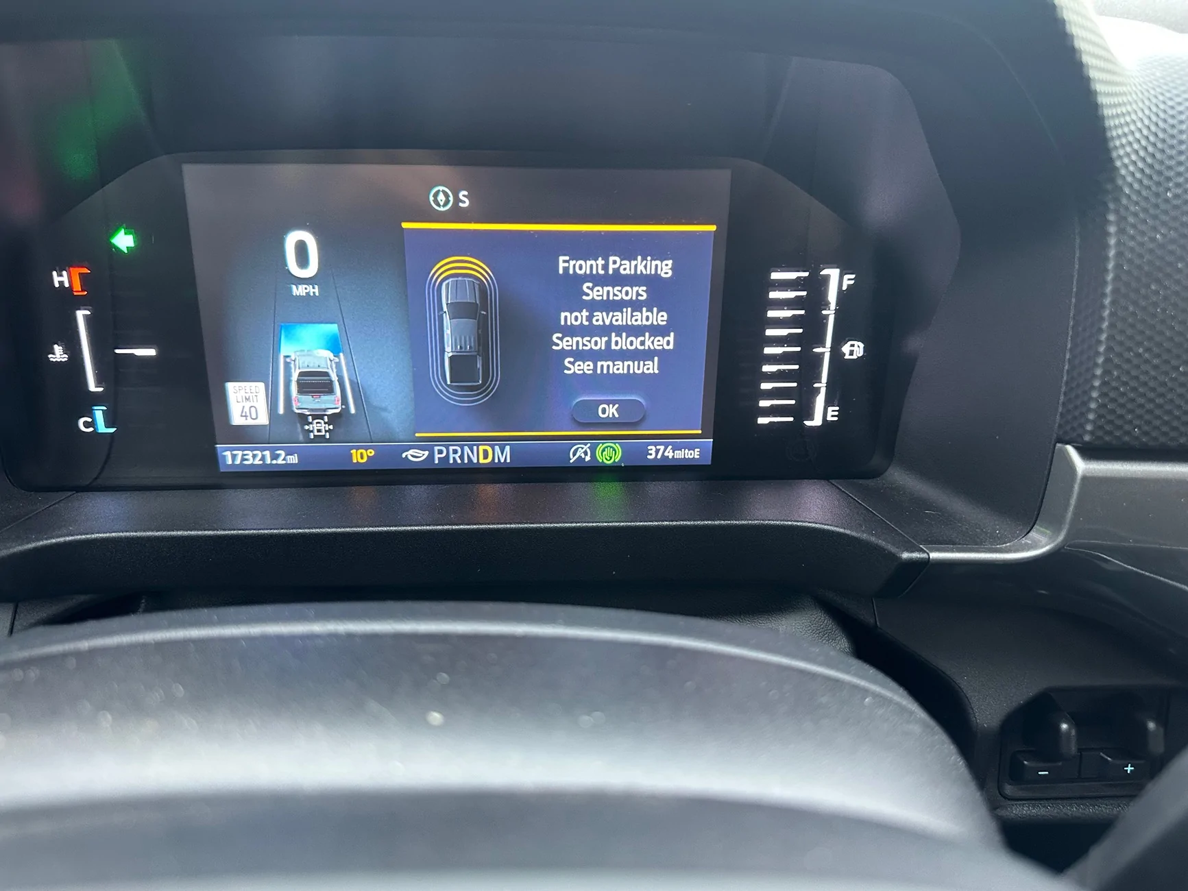

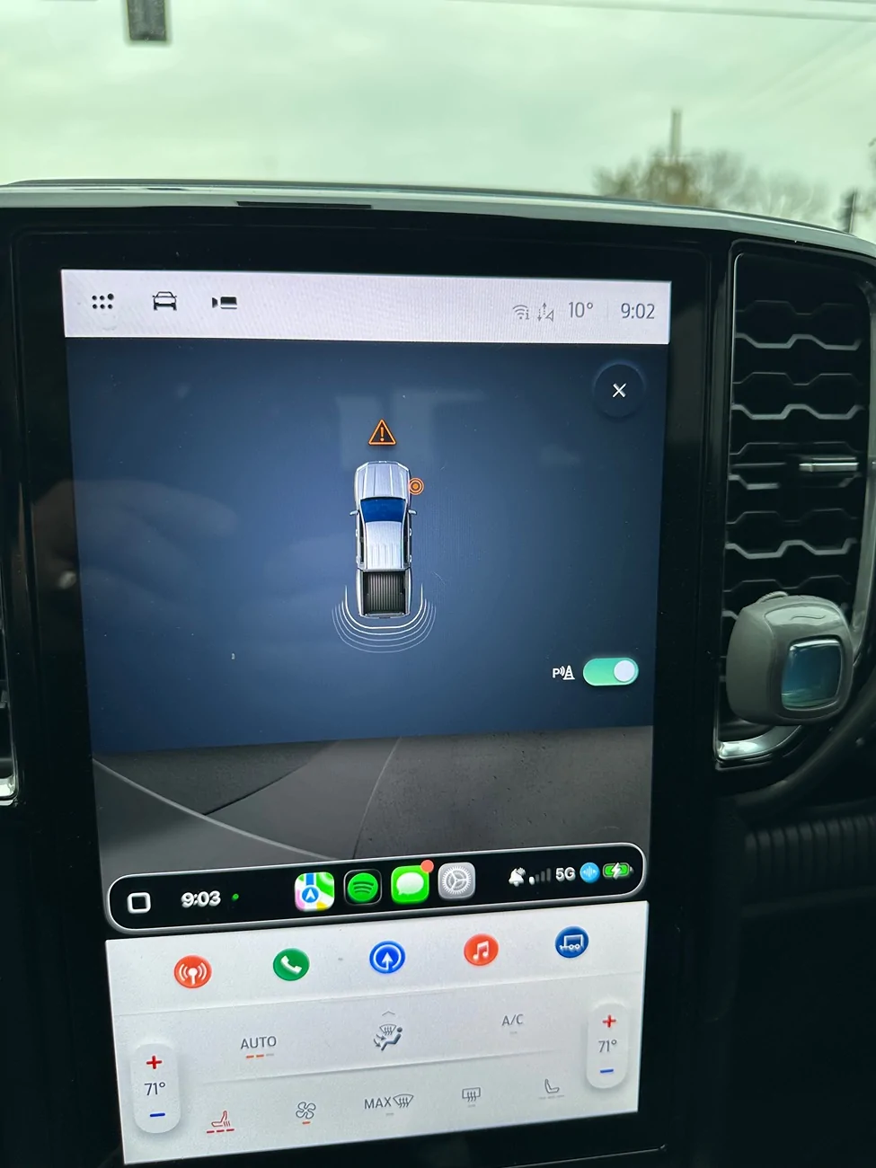

My XLT started giving me the front parking sensor error. The temp dropped here and it does it every time I come to a stop. Annoying as hell. Mine is the right sensor. Sensors are clean.
