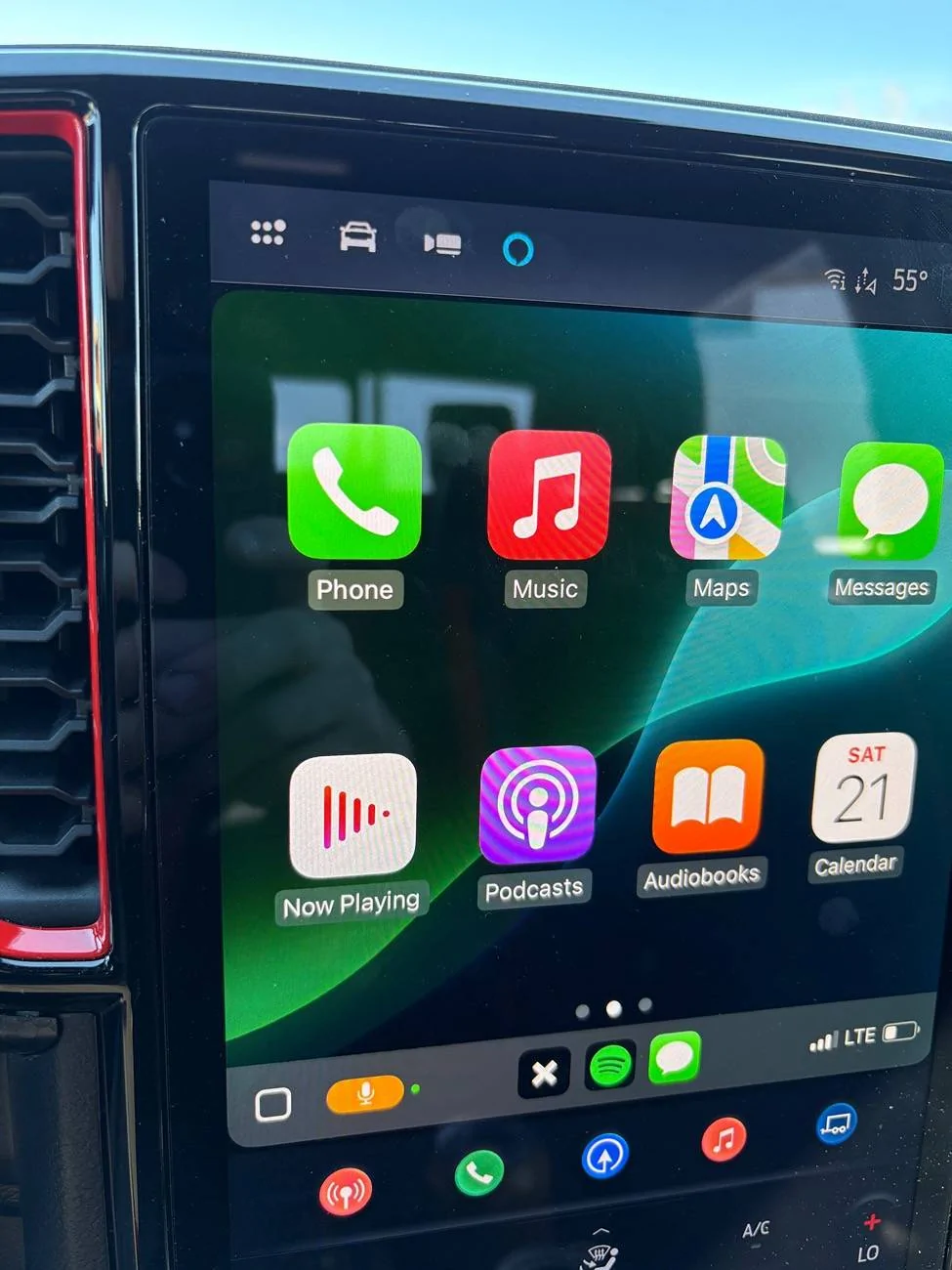

Good to hear it went away. My wife got her ranger raptor in April. I got mine in October. We both had different screens. When she got her update recently, her screen looks just like mine now, so mine must have came with the new software in it already. Maybe I need to go get a reboot at the dealer. Hopefully that's all it is. ?
Mine now shows different icons in upper left.
