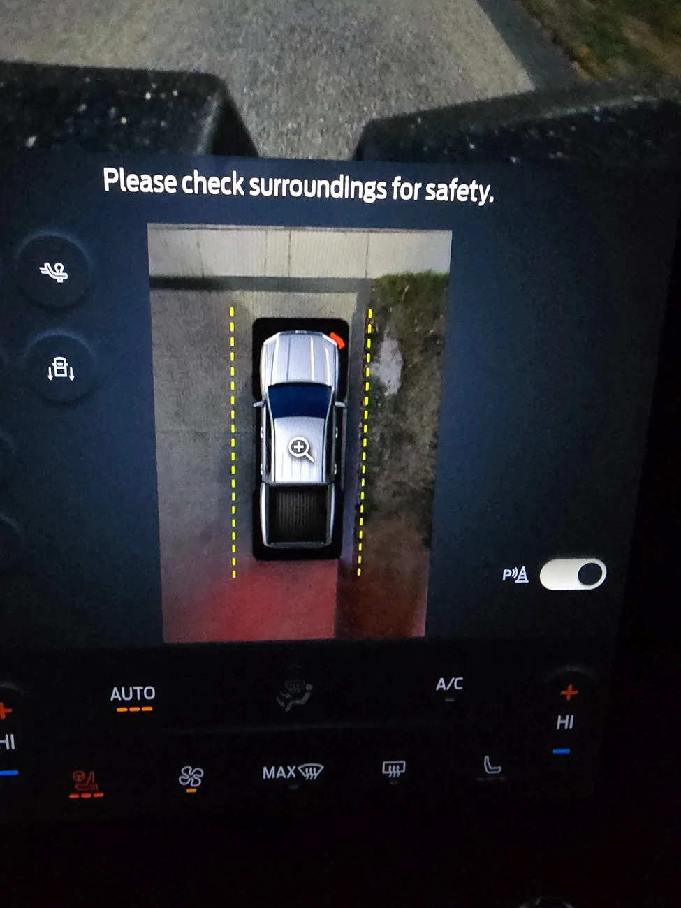

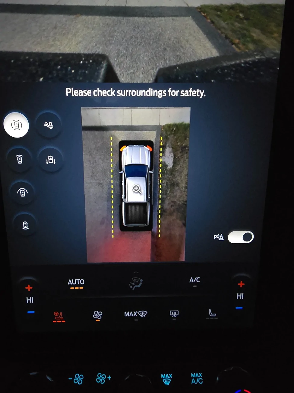

Ford Ranger Front Sensors Blocked Error 20251008_071648
Ford Ranger Front Sensors Blocked Error 20251008_071707
