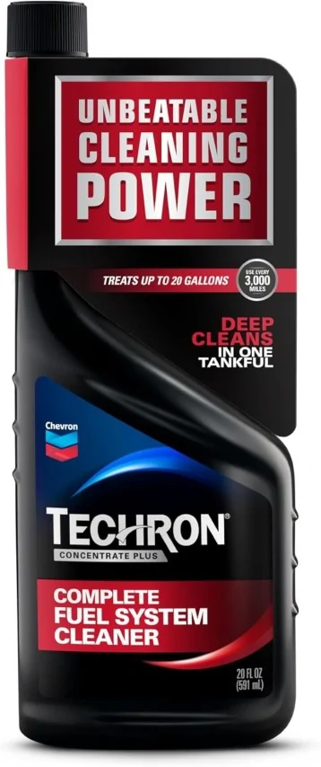

10% has been the norm around here for years. If you're running a top tier gas I wouldn't worry about a fuel additive.
I usually get fuel from Maverick because of the Nitro Card discount. Around every oil change, 4-5 thousand miles, I'll pour a bottle of Techron into the fuel tank.
