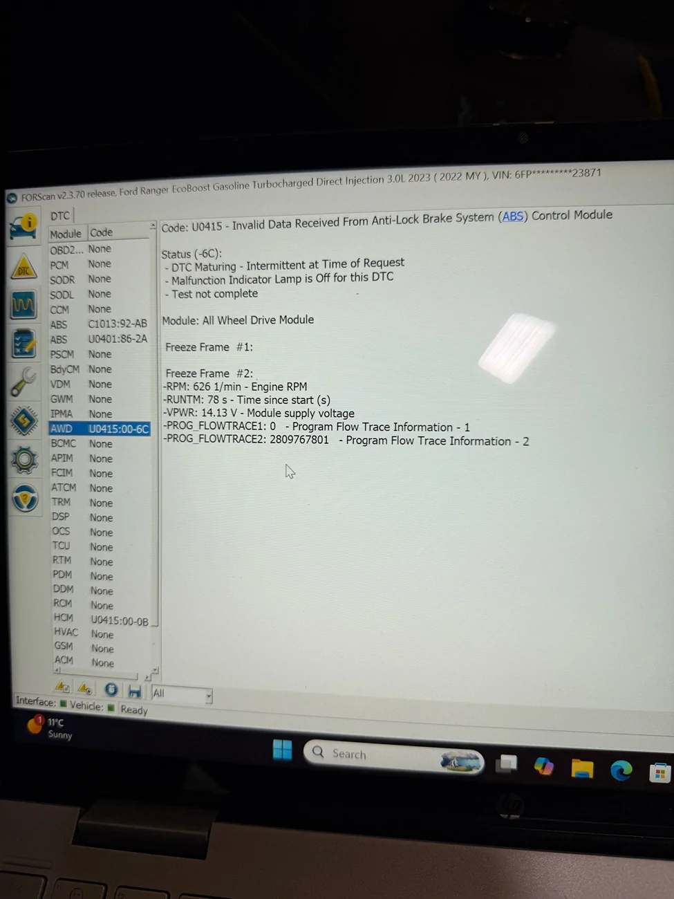

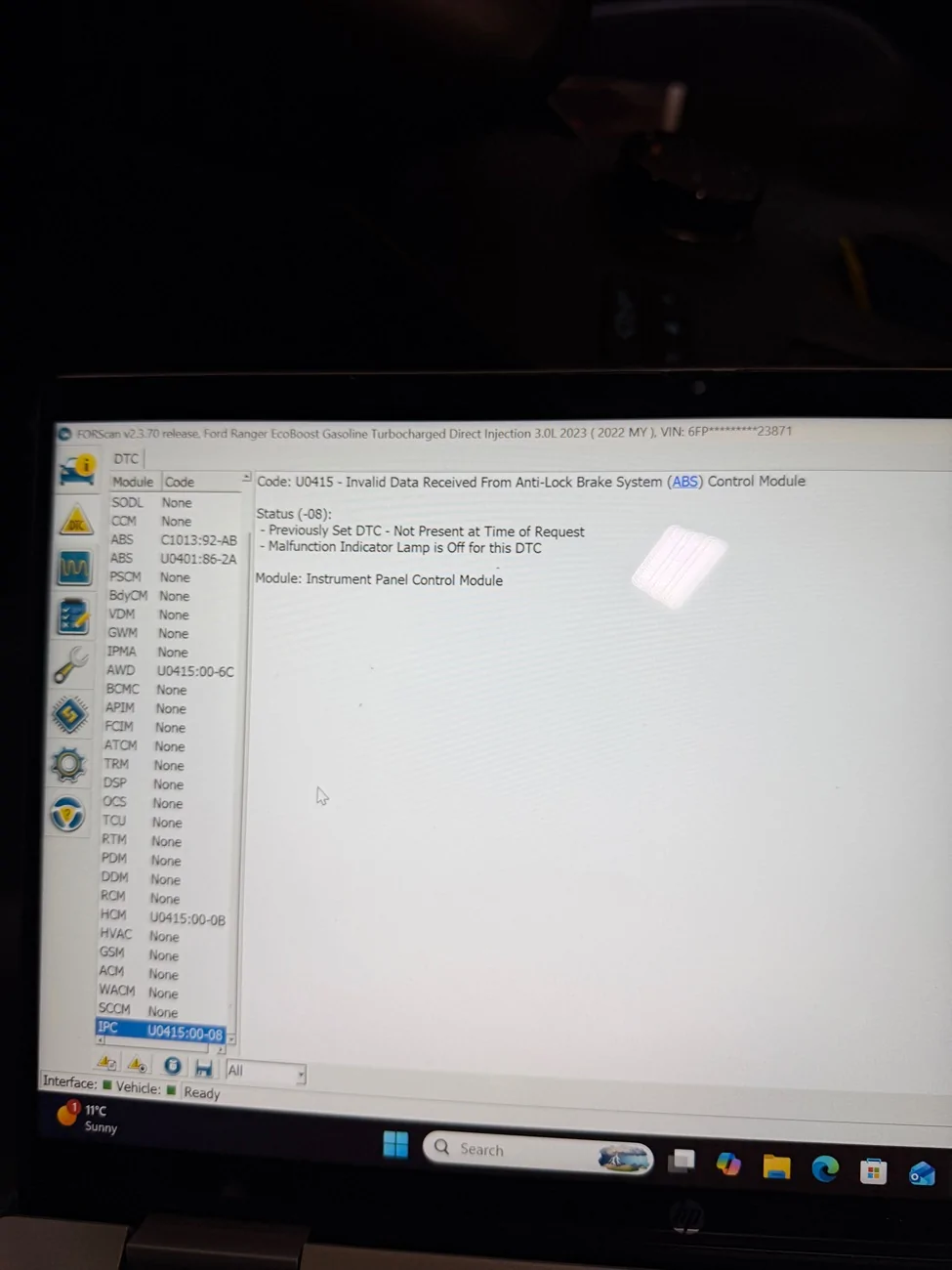

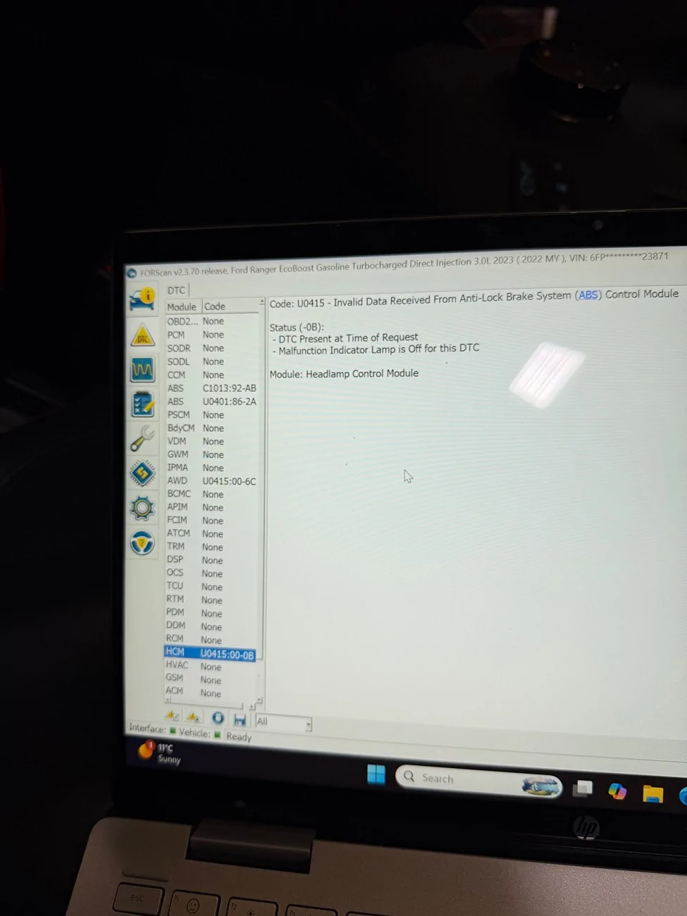

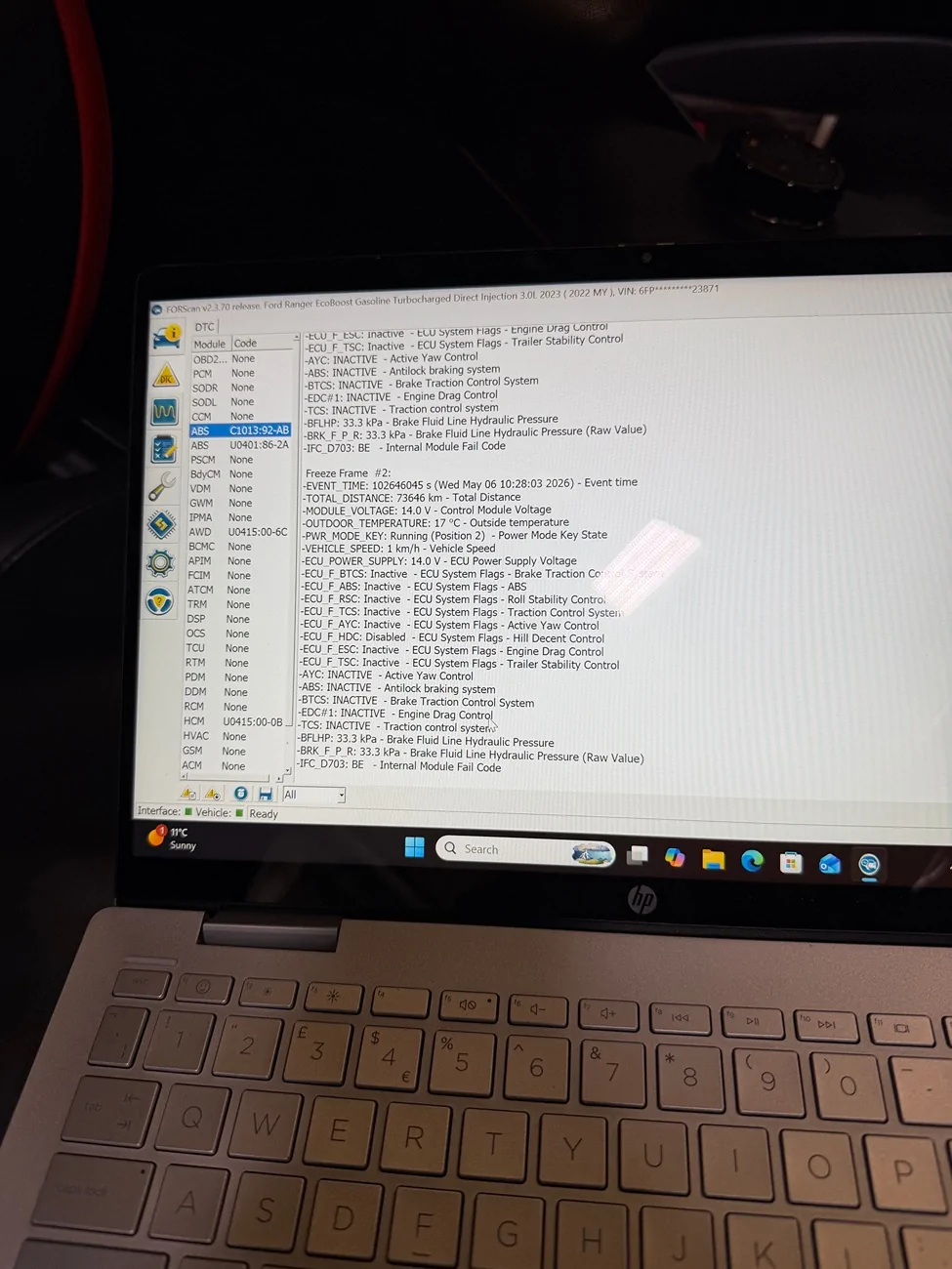

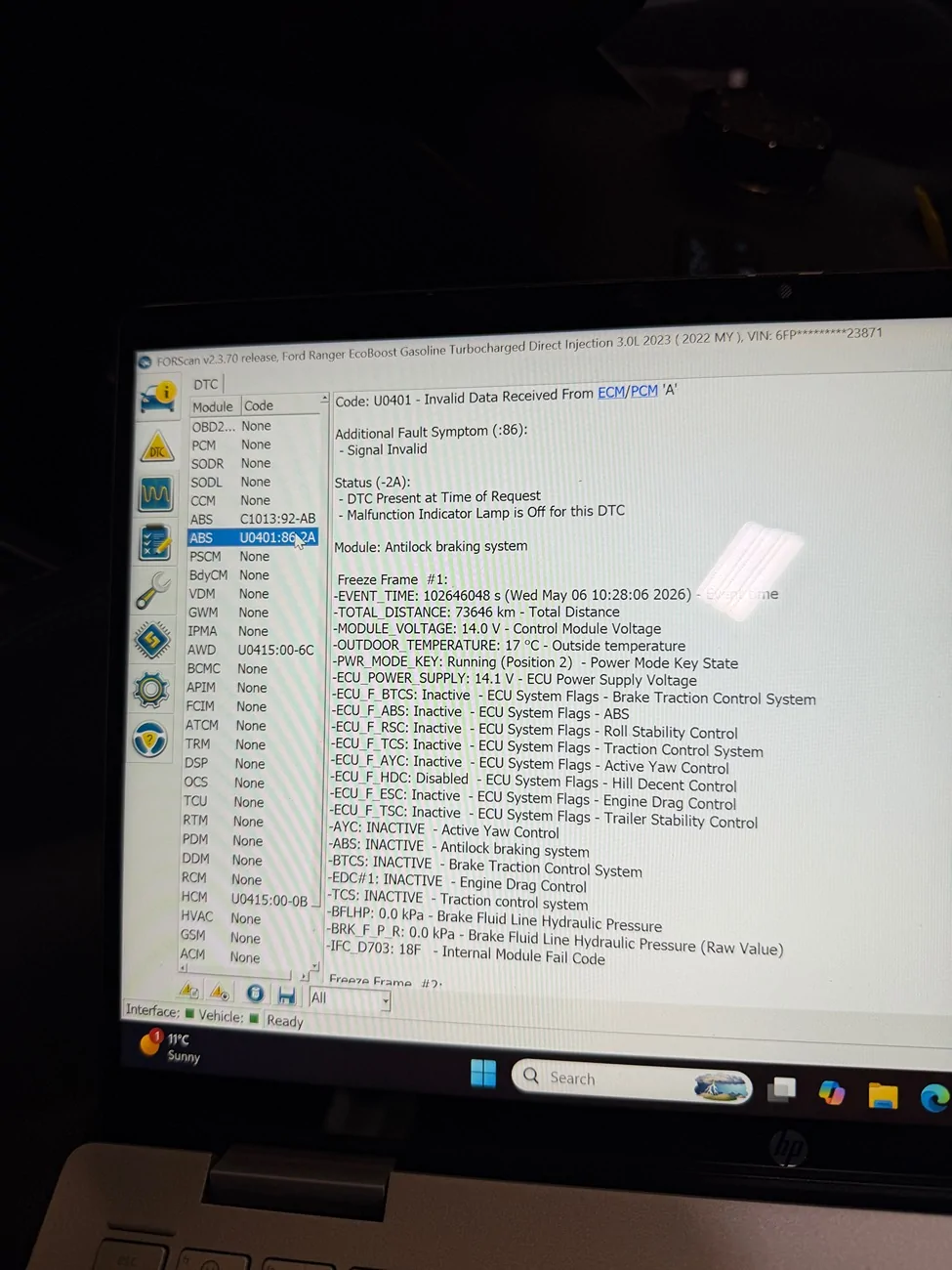

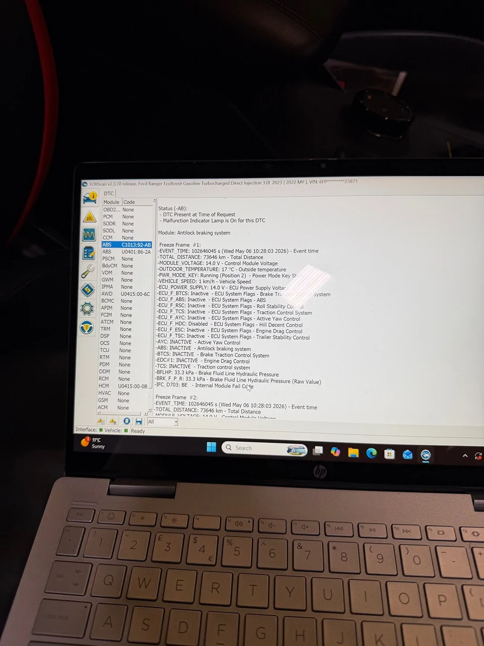

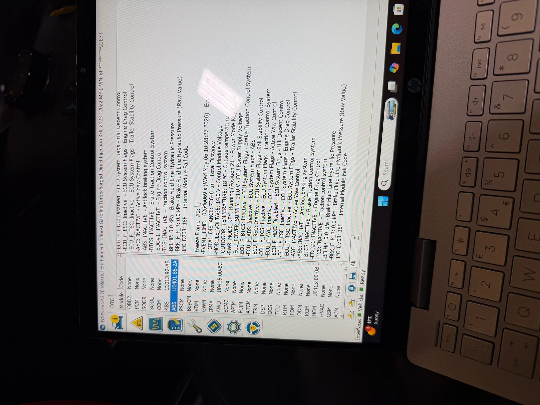

Truck went in for its fist MOT this morning, passed no issues. As they were being the truck round for me to drive away in, it threw up a tonne of fault codes and now has no stopping power whatsoever. Codes in the pictures below
the codes clear and the brake pedal will be solid, you press past the solid feel and all the faults light back up - it’s stuck there at this point

I'd be pushing the MOT inspectors hard asking them "WHAT DID YOU DO?!". I don't think this is coincidence. But what do I know.
I have, just managed to reset it. I think they left the ignition on, jacked the back up and span the wheels to test the wheel bearings, in doing so, the diff at the back spins a wheel the opposite way - seems to have sorted itself now!

hmm... sounds suspiciously like the symptoms mentioned in the EBB recall from last year.
https://www.wardsauto.com/news/arch...ups-loss-power-brake-assist-ebb-nhtsa/757472/
Was you truck affected/fixed?
I will ask Ford when it goes in tomorrow, thanks for this, gives me some ammunition.

Had that happen to our 2025 , all kinds of messages on the display , almost no Brakes , they replaced the EBB & ABS Module . It scared the crap out of my wife , she didn't make to the end of the street & lost braking . I found that pumping the pedal ,the Truck would slow down , scary !
