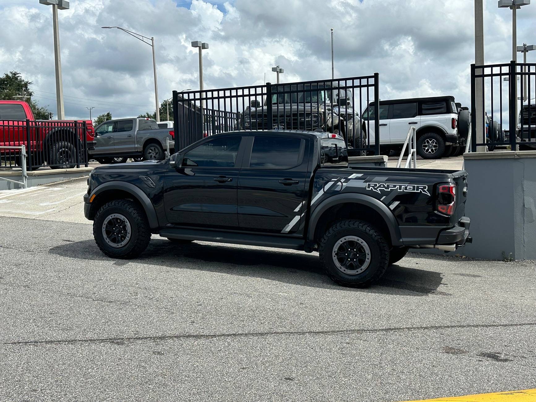

Yesterday (September 24th), I was contacted by the Service Department unexpectedly and informed that the replacement instrument cluster had finally arrived. So today, I went to pick up the truck. However, just before leaving, I noticed that the odometer had increased from 1094 miles (the mileage when I dropped it off on July 30th) to 1762.
Given this discrepancy, I decided to leave the truck with the service department so they could reach out to Ford Service Engineers for guidance. I believe it's a conversion issue, as 1094 miles roughly translates to 1761 kilometers.
The rollercoaster continues.?
Ford Ranger Instrument Cluster Failed IMG_1703
1,801
1,662
