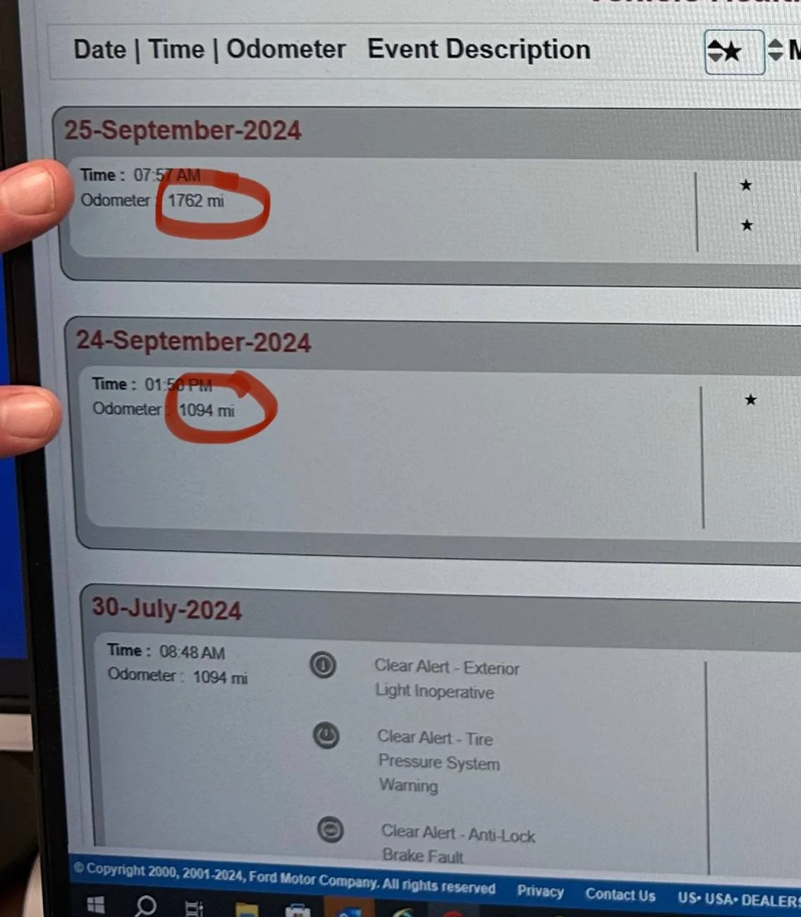

The service dept lead said that the mileage data is now stored in the PCM. Here is a picture of what their diagnostic tool was showing for the truck.
So they bumped the mileage up in your PCM?
Most new vehicles record the mileage separately in the PCM and cluster. The cluster generally is not just reporting what the PCM has.
No, they said they didn’t change anything. I think it’s due to how the IC is reading the data from PCM.
