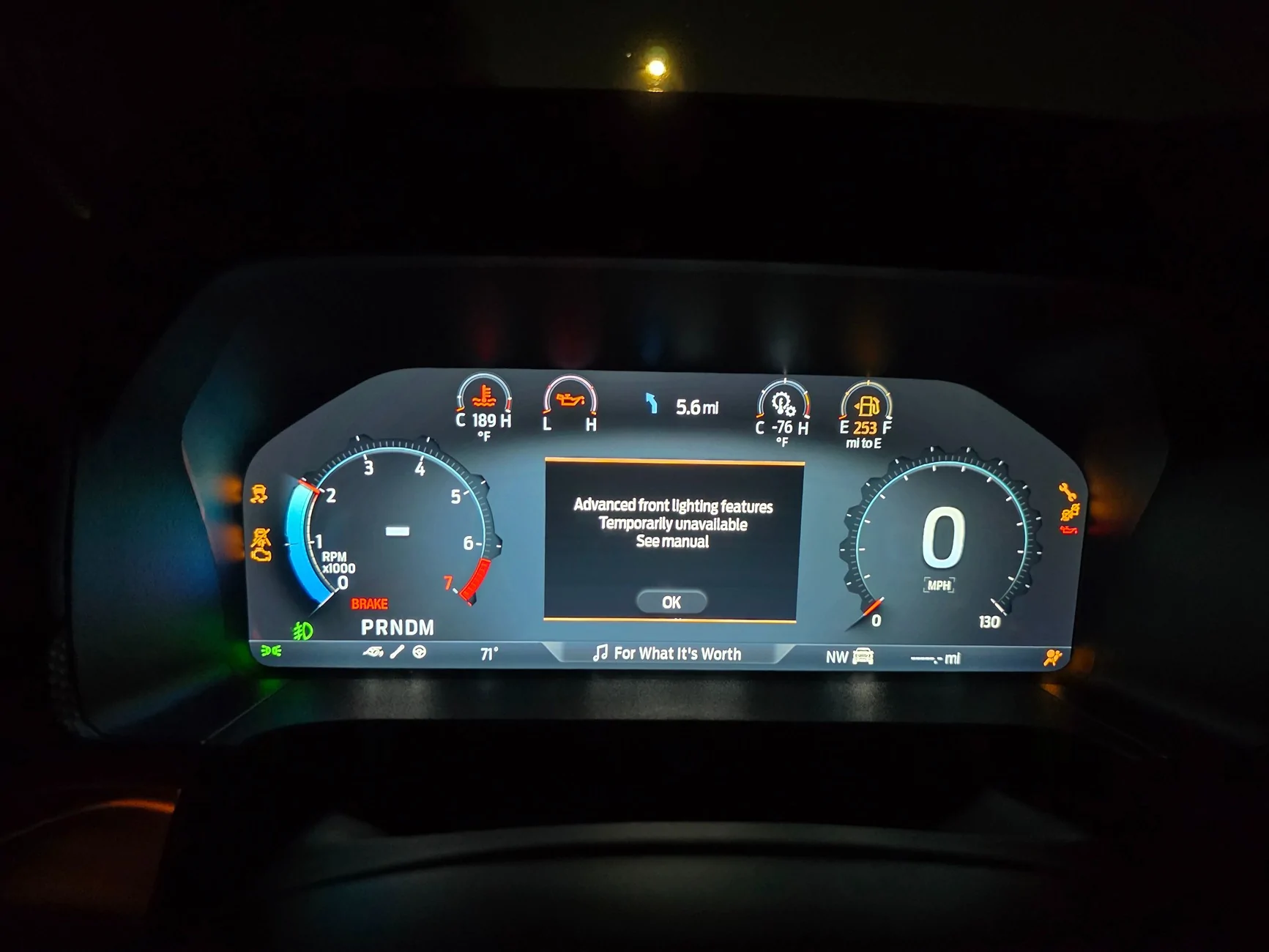

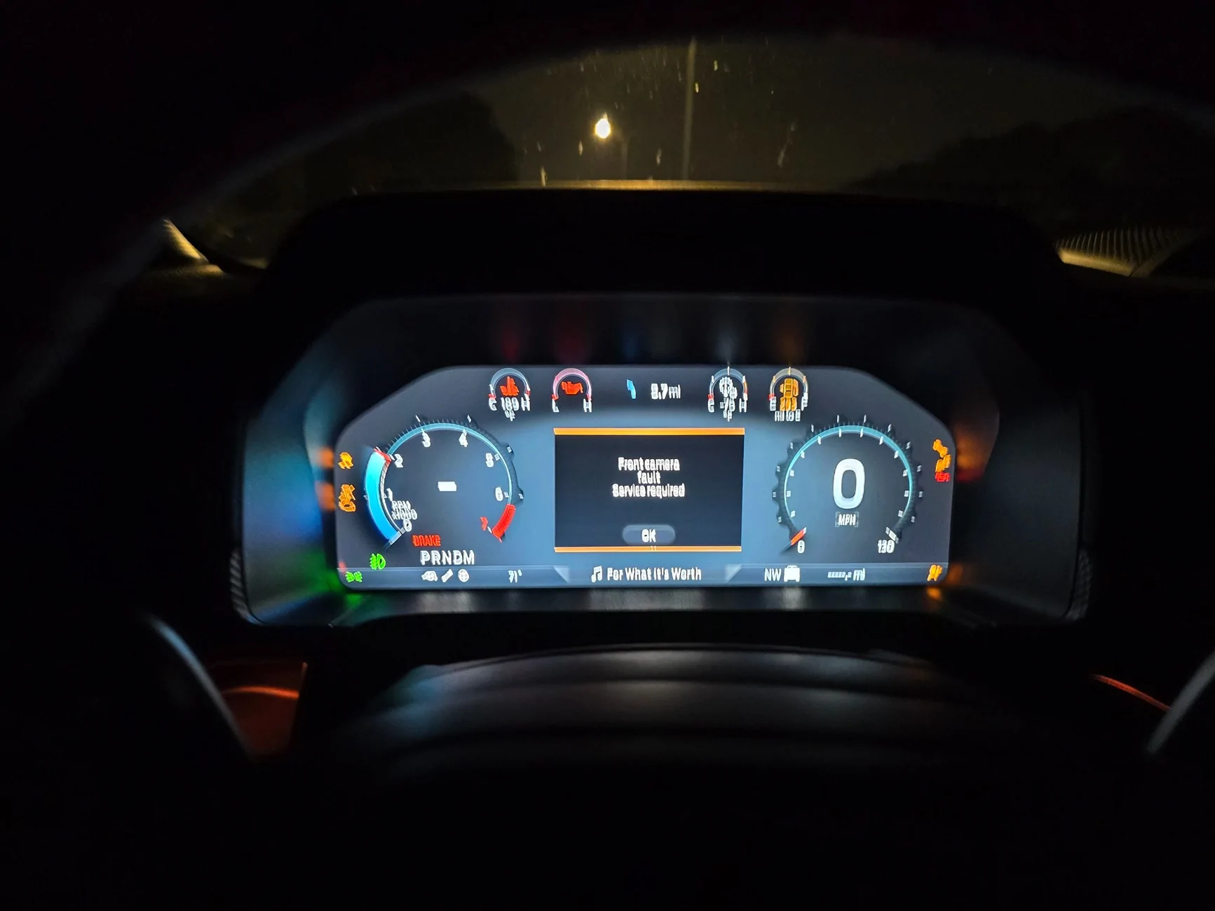

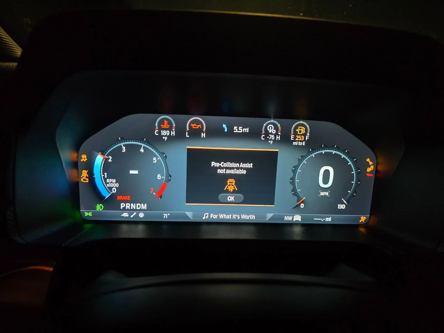

Ford Ranger Instrument Cluster Goes Haywire, Tons of Faults and Codes 20260320_210627
Ford Ranger Instrument Cluster Goes Haywire, Tons of Faults and Codes 20260320_210631
Ford Ranger Instrument Cluster Goes Haywire, Tons of Faults and Codes 20260320_210634(0)
I'll upload a video of the 15 trouble codes in a bit.
The day before this I tried going into Off Road mode and then selecting 4Lo. I ended up getting stuck in 4Lo and limp mode. I fixed it by turning off the truck, opening the driver's door, and turning back on the truck.

I just got back from a work trip and now my Ranger won't start.
Got it towed to the dealer. Now we wait.

The dealer got it to start, but it has over 80 DTCs... They are working with Ford Engineering, but at this point I might try to get Ford to swap it out.

Apparently the tech has chased all of the wires, grounds and connections. They think it's a module or programming. They'd have to fire off the parts cannon to fix it, but they don't know what exactly is wrong, because everything is seemingly wrong.

I finally got the truck back. Everything is working so far! It was a wiring harness issue.
