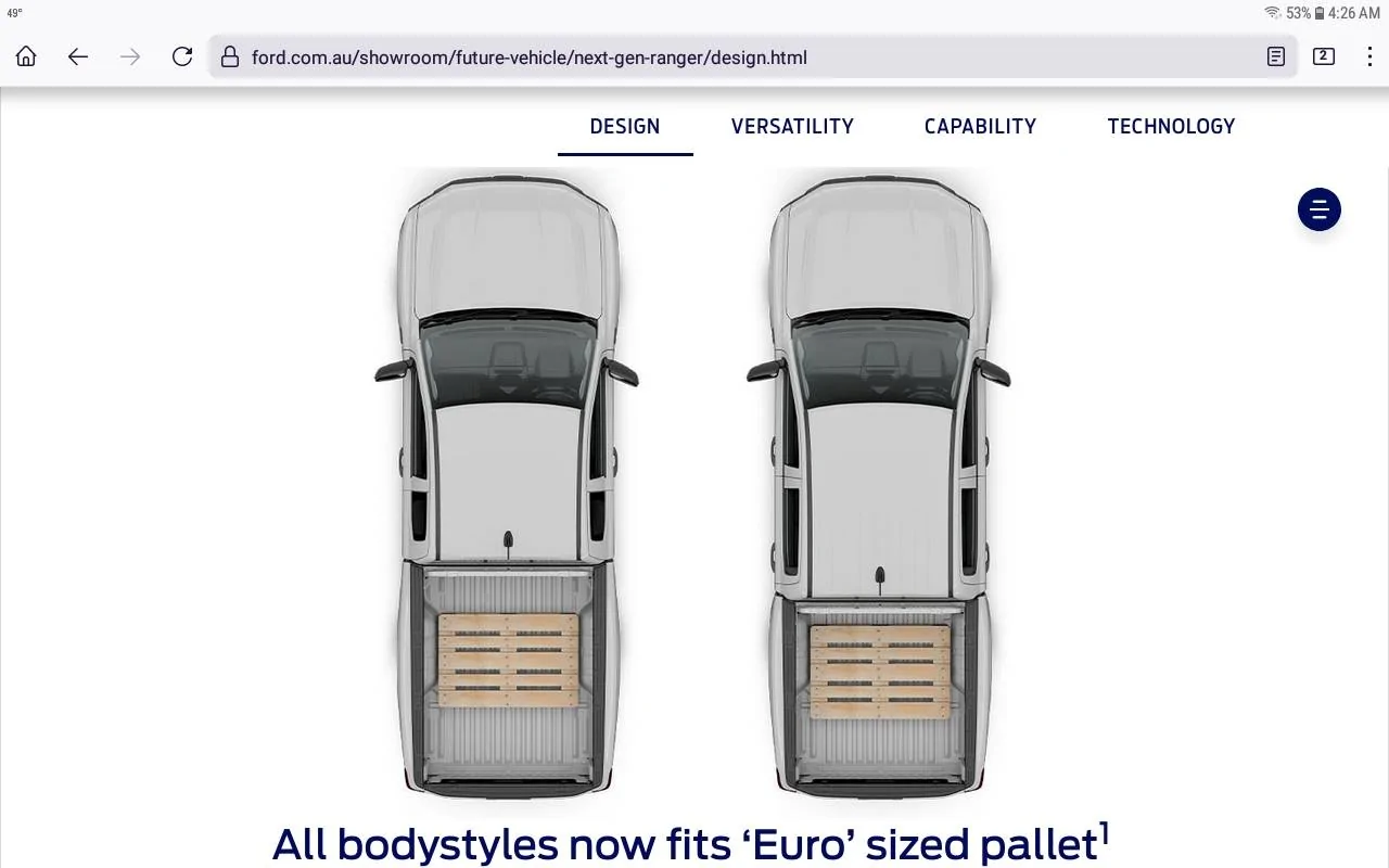

The extra width was required in the rear to fit a pallet between the arches in the bed. That was a VW requirement (the current Amarok can do it).

Here's my take on the supposed width increase. The only thing Ford has said so far is that the track increased by 50mm (~2") and because of that they were able to move the rear shocks outside of the frame rails which allows the rear wheel wells to move out as well and you will now be able to fit an international size pallet between the wheel wells. They have NOT said that the interior volume of the cab has changed, at least not yet. When you see that aerial view and some rear quarter views of both the Ranger and Everest it is obvious that the body has been widened over the tires giving it that "Coke bottle" shape. That doesn't mean they increased the width of the cab between the axles.
