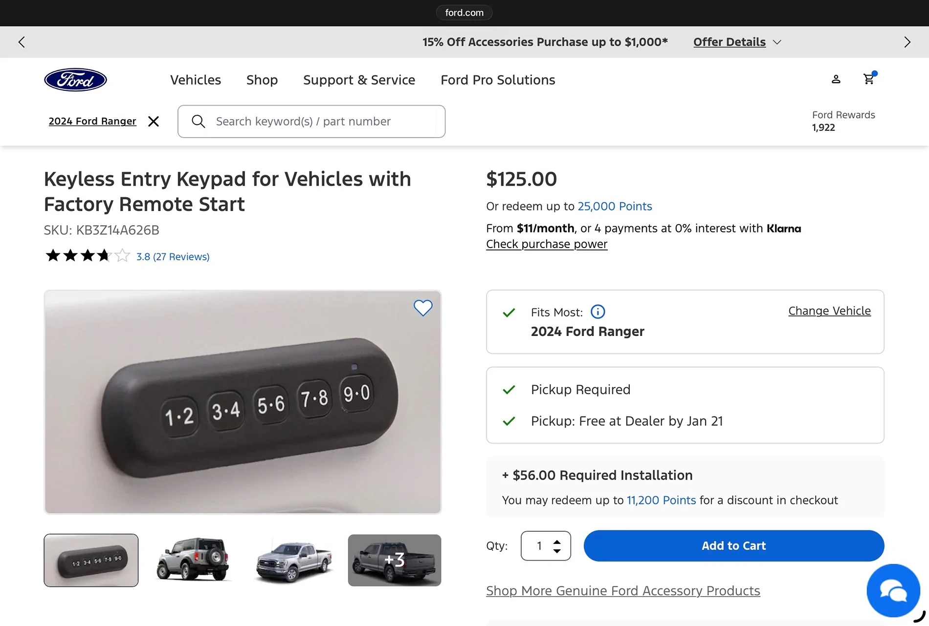

Welcome to the Forum! Keyless entry pad from Ford is $155 + tax and $56 installation.

It's a cheap, plastic, non-paint matched part that just sticks on with adhesive. It looks terrible honestly, so if there are aftermarket options they might look at lot better.

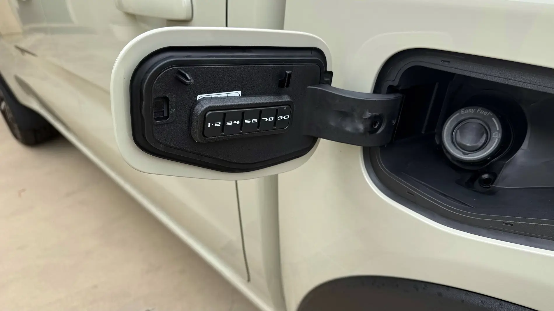

The good news is you can hide it behind your gas door (whatever the technical name for this thing is) so it's out of sight and it works great.
Also, something you can use those reward points for a new purchase on. https://www.ford.com/product/keyless-entry-keypad-p4000193030
edit: I just realized, in the compatible vehicle list, the 2026 ranger isn't listed. Other models include the 2026. So that's weird. I would feel extremely confidant ordering it regardless.

I have 25 Ranger lariat and that's where mine is, above above the door handle. Not to impressed. I like the gas door idea, what's the best way to get it off?

So mine wasn't attached when I got it (was in my console). I didn't have to fight with removing to relocate it.
I've seen posts on here where others have moved it though. I think they just applied heat (hair dryer, or very carefully with heat gun maybe?) and were able to pull it off. All that's holding it on is a bit of double sided tape.

I moved it on my last couple of Fords. Heat it up a bit with a Heat gun/hair drier then slide some fishing line behind it and it comes right off. Apply new double-sided tape in place behind gas door
