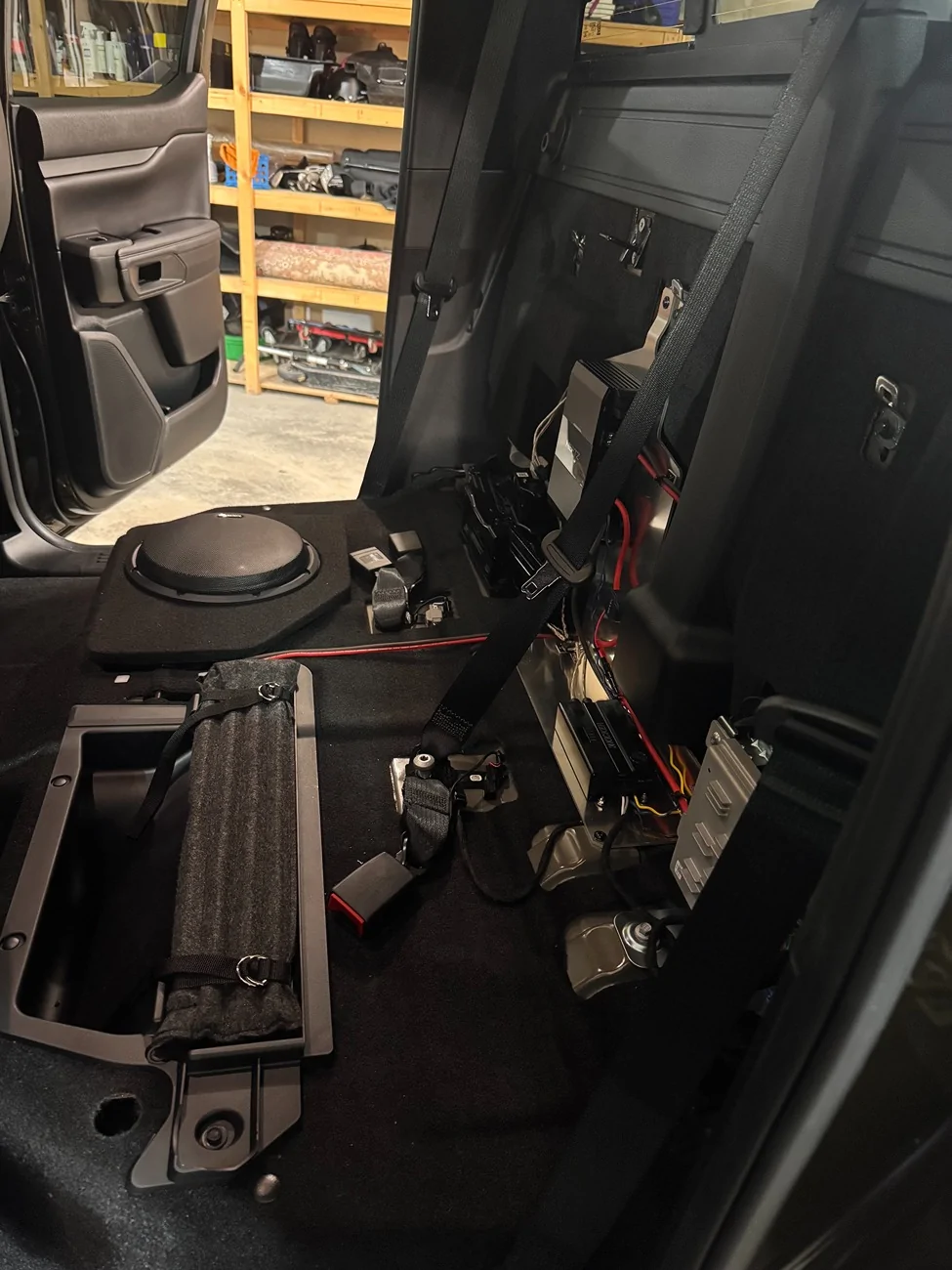

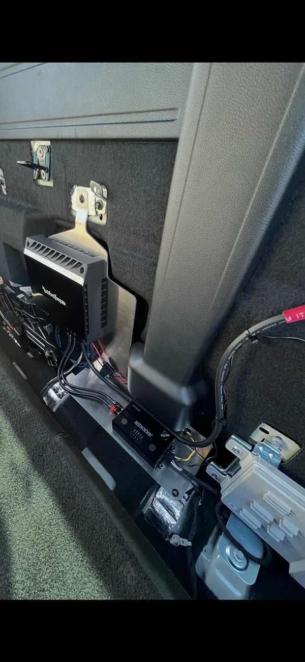

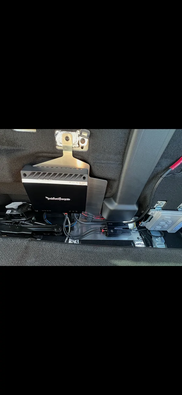

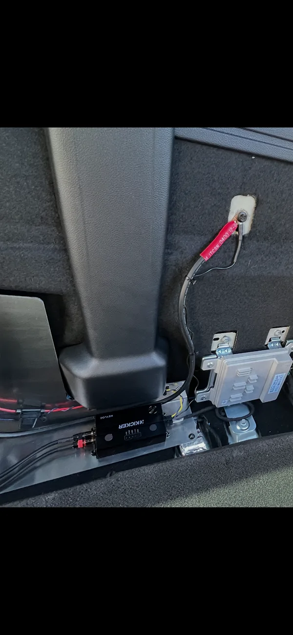

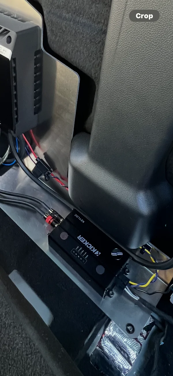

Just a month & 1/2 ago I hooked up the SGS Kicker Keyloc DSP to feed a signal to a RF Punch 300.1 feeding a Hertz 10”. The Keyloc STILL needs a dedicated power source with an in-line 2 amp fuse (it’s in the Kicker literature instructions) and a remote turn on signal wire. It also needs a dedicated ground. Just the plug & play harness that goes in-line at the factory Ford amp WILL NOT get the Keyloc to energize or cycle with the ignition.
Some quick pics I could find.
Keyloc & amp cycle on with ignition and cycle off about 20-30 seconds after the ignition cycles off.
Ford Ranger Kicker keylock no power IMG_3007
Ford Ranger Kicker keylock no power IMG_3008
Ford Ranger Kicker keylock no power IMG_3009

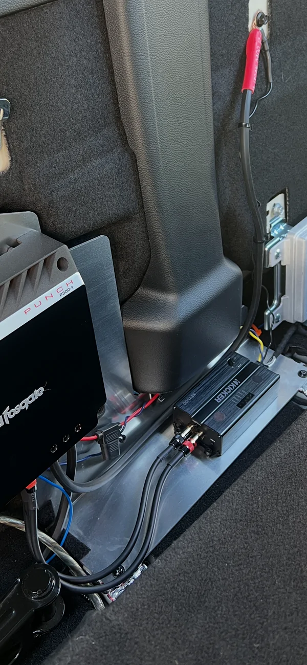

The picture likely won't help you much but I ran a fused line from the battery to a distribution block then ran a power wire from the block to the amp, and a fused wire to the keyloc. Then I ran the blue wire from the keyloc to the remote turn on terminal of the amp, and the black wire to ground on the back of the cab. I'm sure theres different ways to do it, but thats what I did.
Yep! Very similar to what I did above. That’s how you’ve gotta do it. The Keyloc is its own device and needs dedicated power & switched wires & a ground to do it. That’s the blue, black, yellow harness in the SGS kit. The plug & play harness is strictly factory signal by-pass & redirection.

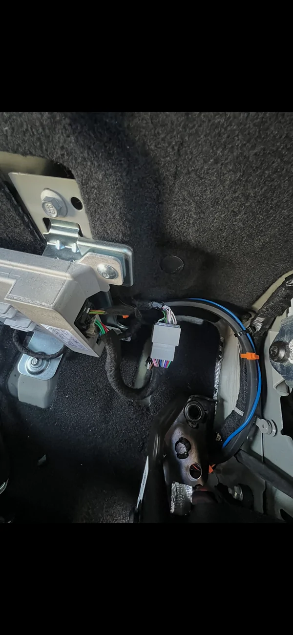

Thanks for the pic, maybe another of a closeup of the factory harness area, really really appreciate your time

Wow NICE JOB WITH PICTURES, thanks again, have a good one 👍

Last thing I promise, do you have the blue wires for remote on a switch ?? Or tied together?

I landed it in at the remote turn-on terminal at the Fosgate amp. So basically that one wire comes to the back and splits at the amp. Figured it’s just a switched low amp signal just to turn on & off so there’d be no harm in daisy chaining them together. Hence why the wire gauge is so small. Hasn’t given me any issues.
