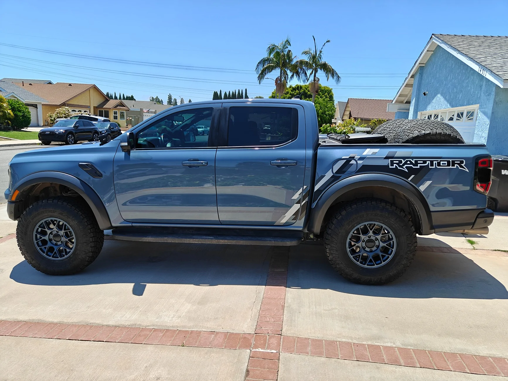

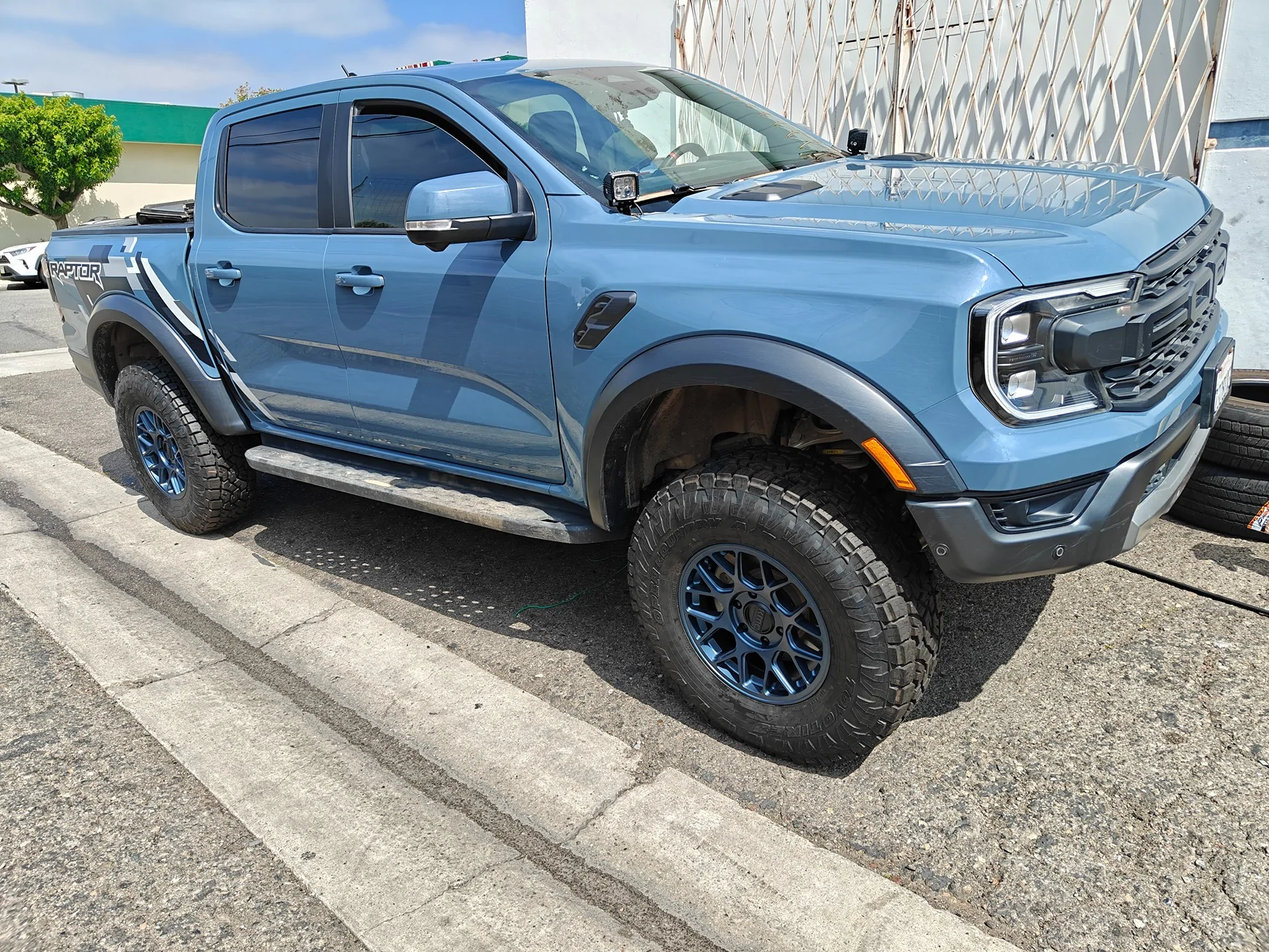

Looks sexy until it gets dirt and mud on it.
Edit: I just installed a full size spare that is slightly wider at 35x12.5r18 and I had to deflate to about 30 PSI for a snug fit. It fits tho.

So that I understand that those were installed with no suspension mods and create no rubbing issues?

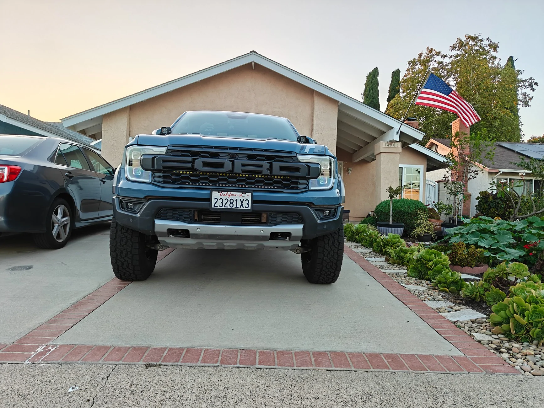

Did you snap any photos directly from the front? I like the idea of taller-skinny(ish)

I have 1 inch lift spacer in the rear and front. The front also have Eibach 2" lift from a level coil spring. No rub. I off road pretty hard and catch air also. Will report if it does happen. I really wanted +35 offset but these were in +25 at the highest.

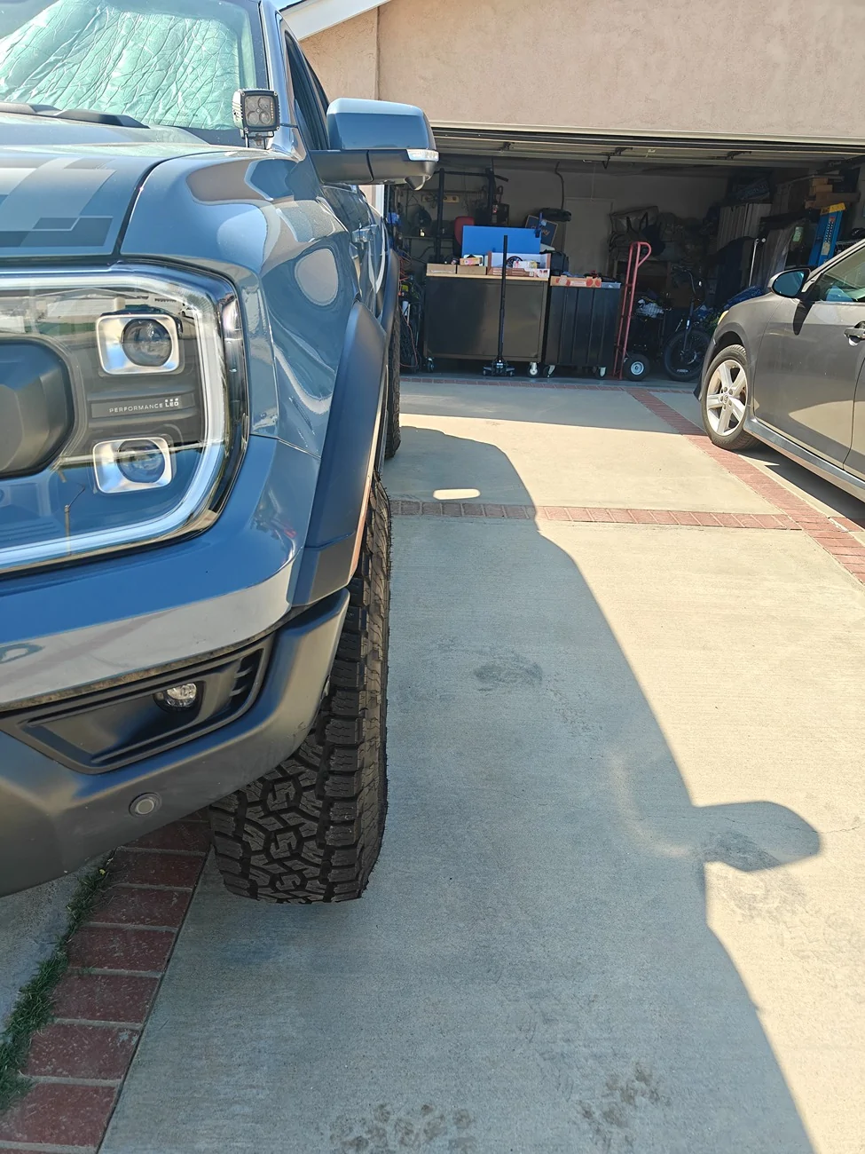

Looks great, how much poke past the fenders? Any chance you could get pic down the side?

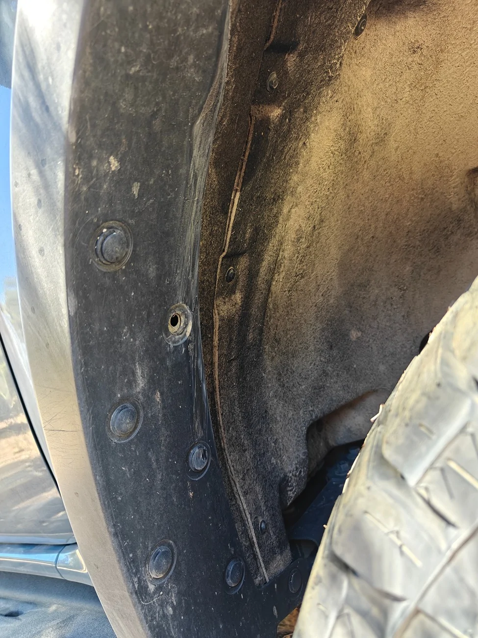

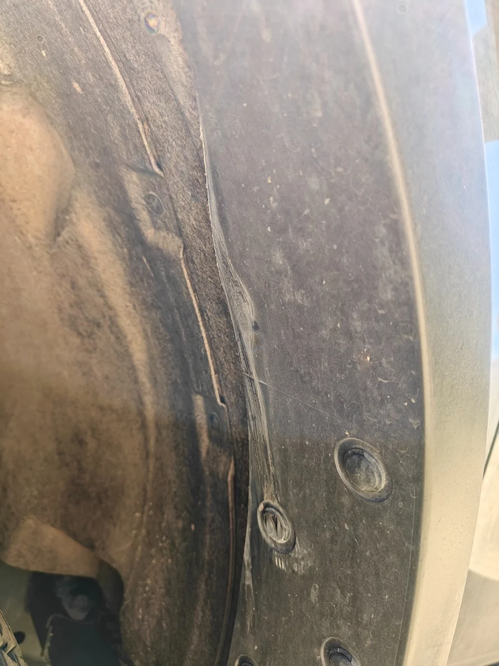

Update, slight rub with full lock reverse. Front bumper crash bars will be going this weekend.

Off roading the Toyos did well. My setup does rub from a jump. Maybe 2" front spacer might have avoided it instead of 1".
