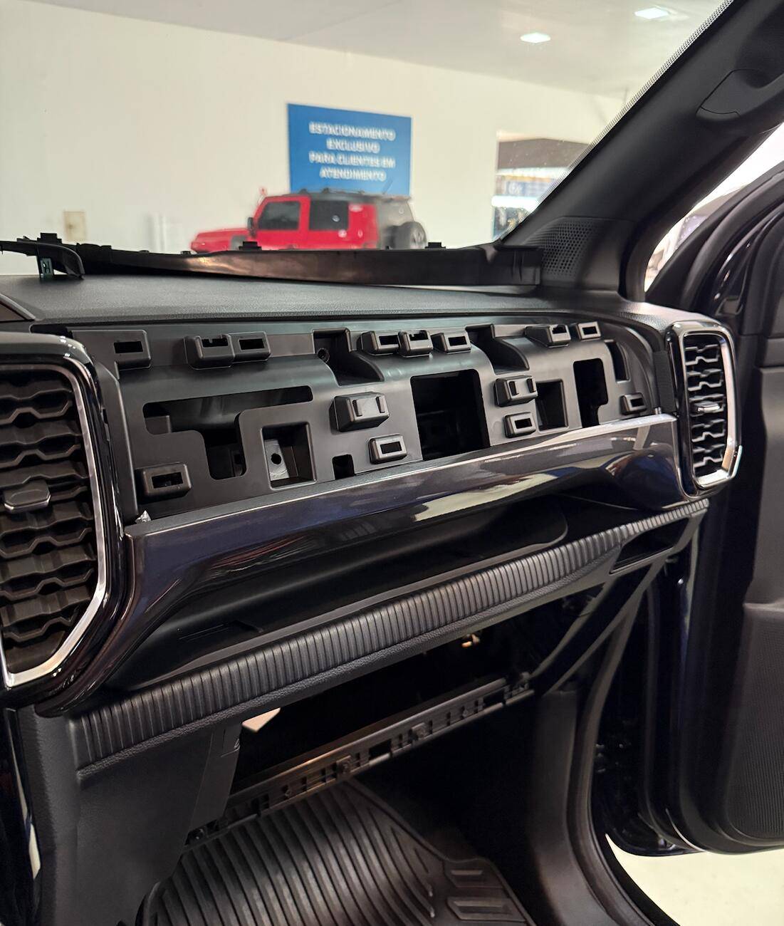

This days I had to disassemble most of my front panel to install my front camera so I took this picture. This is what looks like the interior of this part (my car do not have the top glove box).
Hope it helps somehow.
Yikes!
Thanks.

jgruben1134
Jan 23, 2025
124
Rome, GA
2024 Ranger XLT
Looks like maybe 4 bolts to remove that panel to open up the space behind?

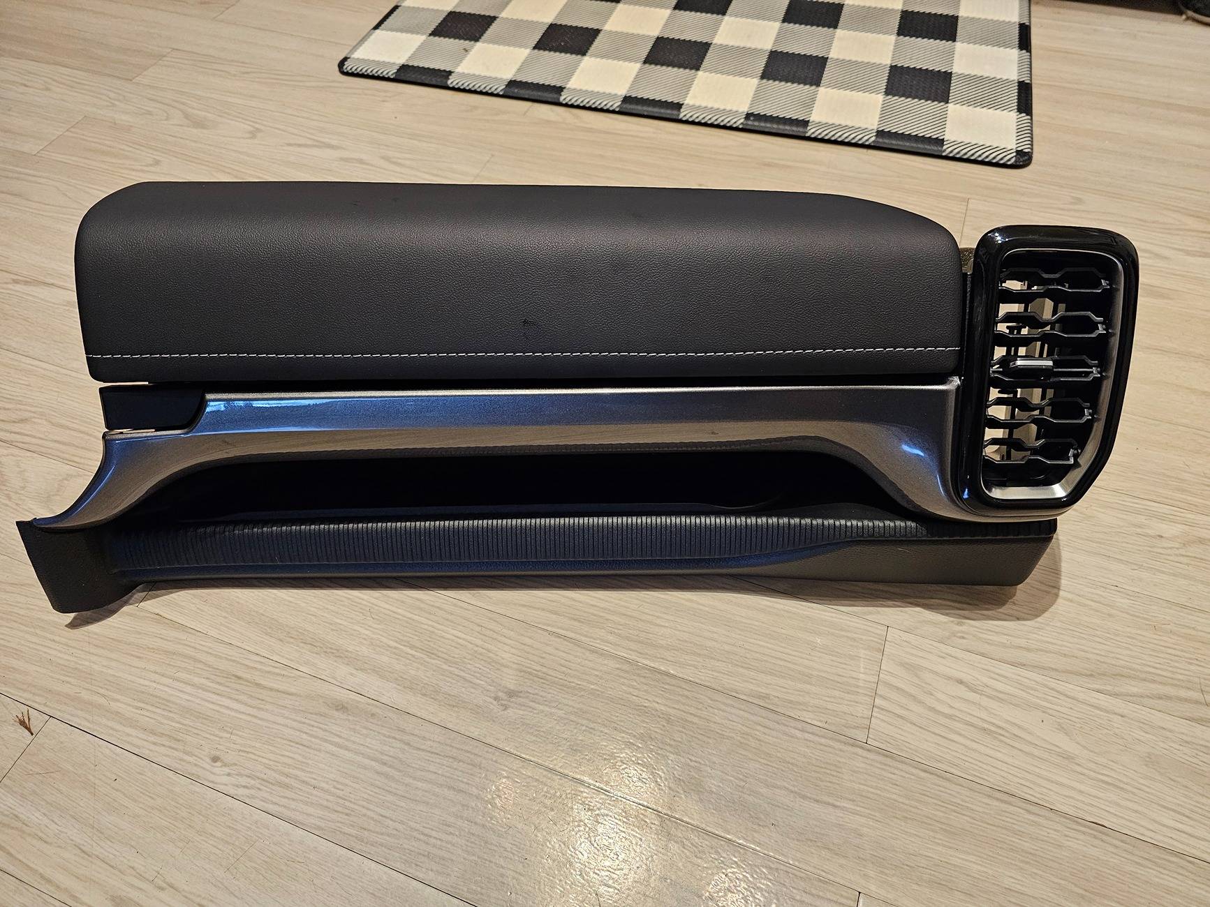

Aberk25
Aberk25
Alec
Jul 16, 2024
74
220
Ohio
2024 Ford Ranger XLT
Ford Ranger Lariat Top Glove Box Install on XLT 1000015401
Ford Ranger Lariat Top Glove Box Install on XLT 1000015403
So It arrived today, I can confirm that part number is the entire assembly, so It looks like I'll just have to pop off the entire passenger dashboard face and pop this one on. Also it looks like the "leather" face would pop off and the honeycomb from the XLT could take its place on the glove box if one wanted. I'm gonna worry about getting it installed first before I mess with anything that's cosmetic first. If it looks fine with the leather on one side then great

jbethune
Apr 9, 2024
34
151
175
NC
2024 2.7 Ranger XLT
Will you change the drivers side surround to have the same trim/leather look?
Something like that. I wasn't really paying much attention at this point, but the guy took it apart pretty quickly.
Wow, that looks expensive. Also I would had a lot of work to make it match my car interior (all black version). After all I would have spend a lot for a small extra space. I don't know if it's worth it in my case.
